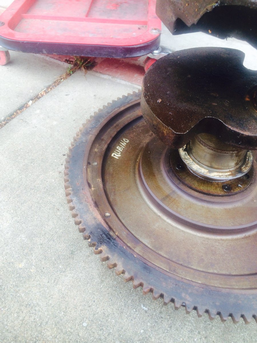

  3. image.jpg Here ya go. You should be cutting down the crank side.

    This makes sense.^^^^^

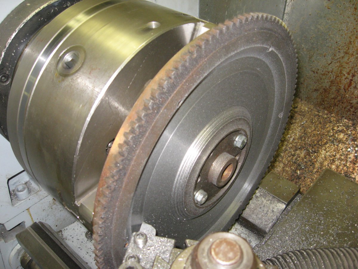

    This is an 8BA flywheel, I took 9lbs off of the crank side. I have a mandrel that works well in a large lathe. IMG_0334.JPG IMG_0335.JPG

    Thanks Johnny. I just used this Rutland tool lathe that we have at the shop.
    This is the best photo I have of it set up. I had to remove the section of the bed right under the chuck in order for the flywheel to fit on the lathe.
    I don't have a photo of the side of the flywheel, and I've already dropped it off at my machinist to be resurfaced and balanced, but I can post a photo of it once I get it back.
