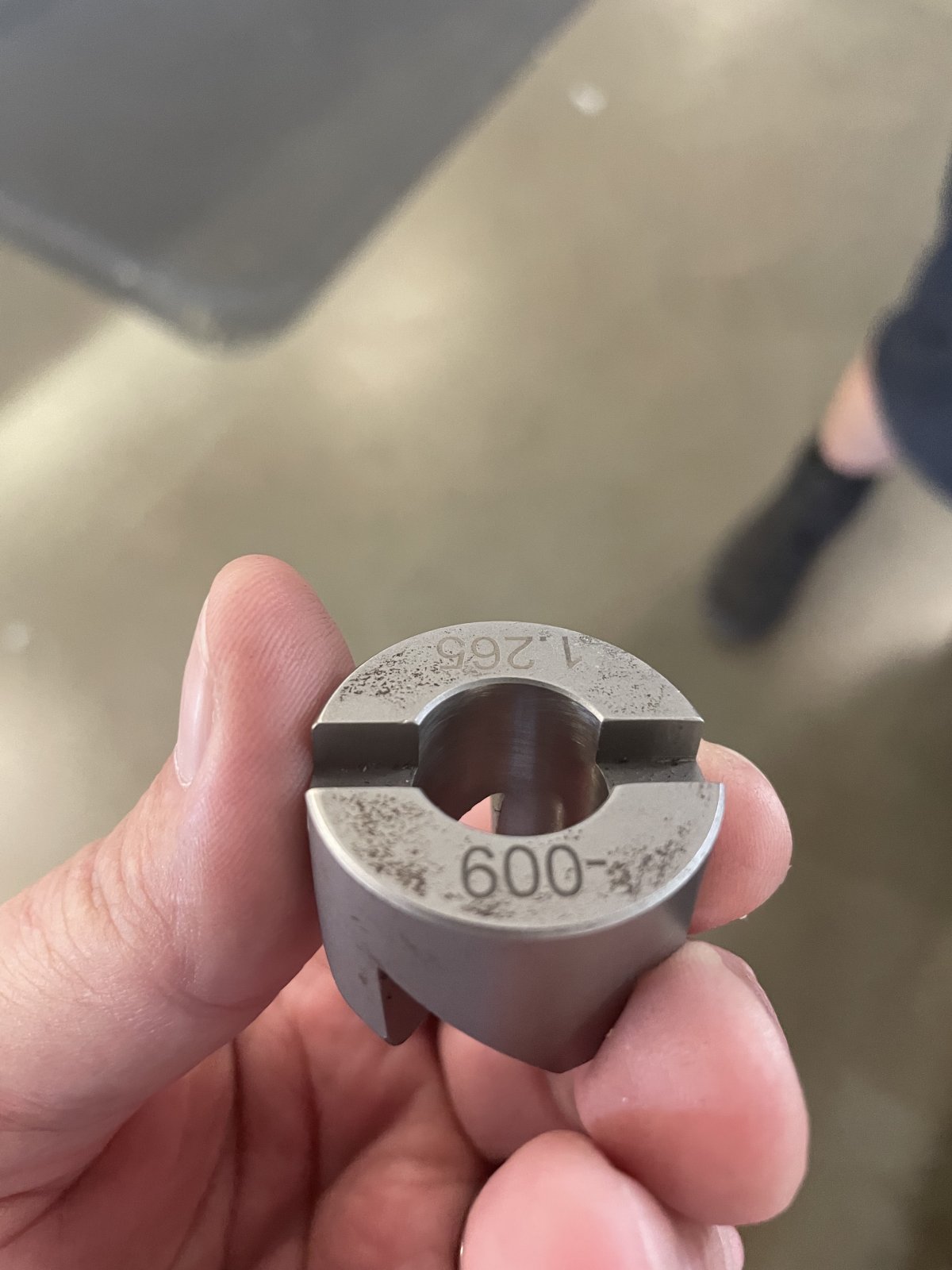

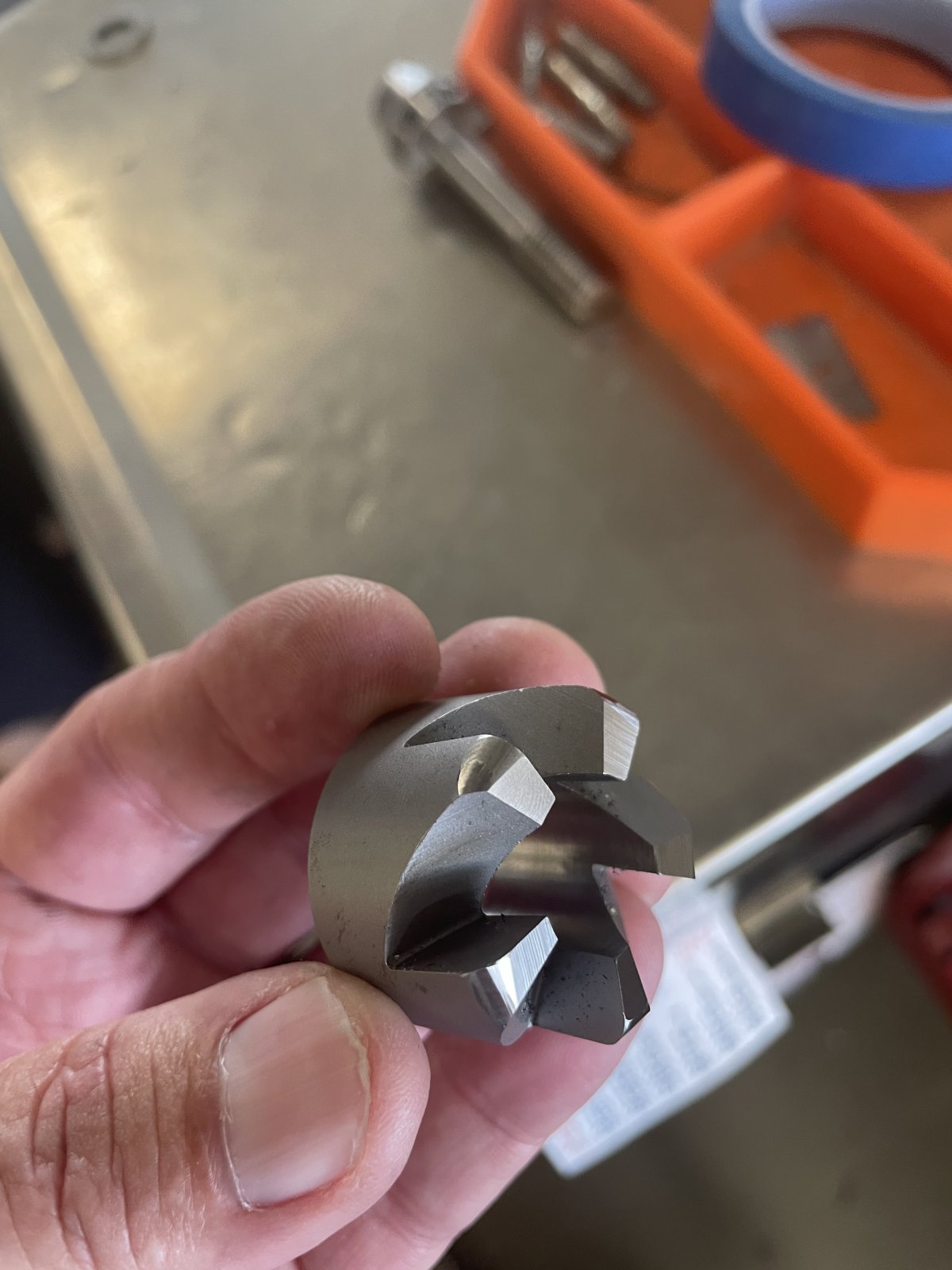

    6C13B96F-799E-4739-A5F6-0D370B7CAD8E.jpeg 7FD0A88A-0ADA-43D2-ACC6-C712942DE06B.jpeg I am trying to figure out what this is called. You guys will probably laugh, but I am out of my realm of expertise. I need to buy one of these for a project that is smaller than this one.
    This one measures 1.2650 and I need one maybe about 1.250. I don’t even know what to call it. It’s being used as a spot facer on an aluminum casting.
    Any help is appreciated. I know you guys will answer this in probably under 2 minutes.

    Looks like a valve spring seat cutter, without the arbor.

    Maybe a rotary broach???? BTW I’m no machinist

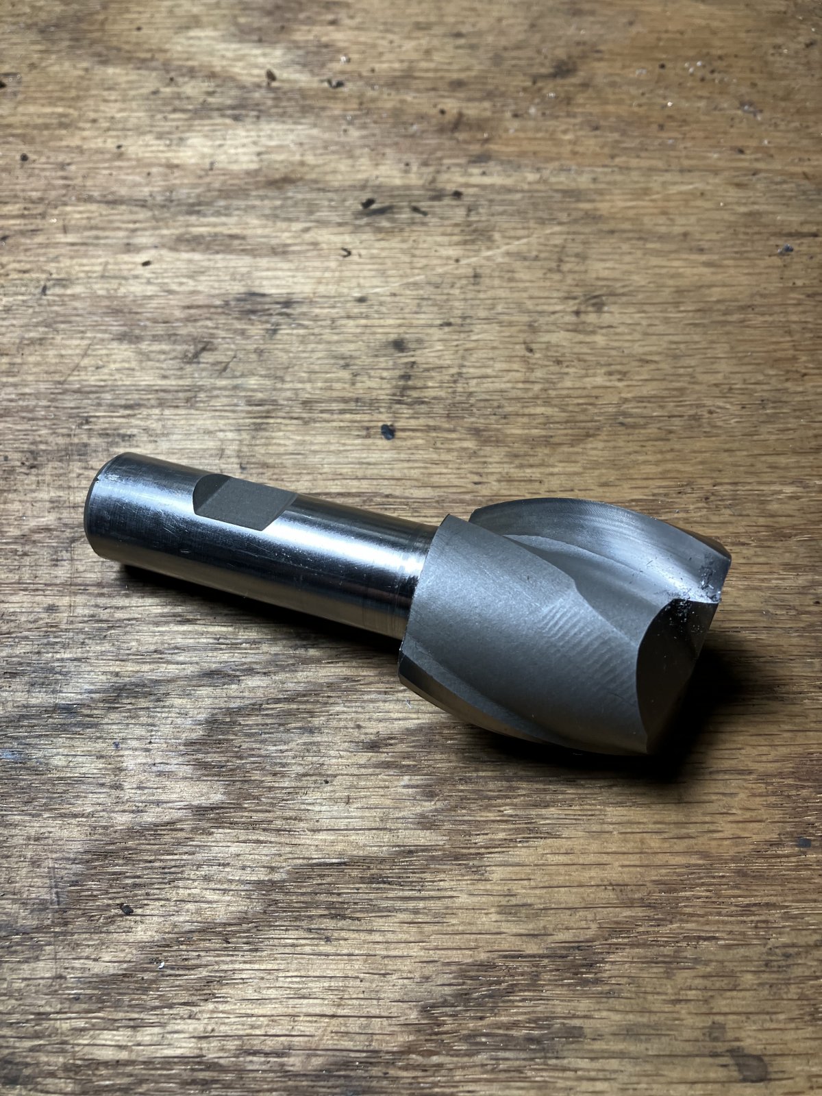

    FC5D28F5-615B-4DE1-8573-254A397CFE85.jpeg You can use a end mill but you will probably need one with a reduced shank
    This is a 1.5 with a 3/4 shank
    Some end mills won’t cut in the center you may need a small pilot hole 3D4279F1-A00F-4707-A125-B369A447E258.jpeg

    At Imperial Eastman "now Parker" we called them Hollow Mills, ours have shanks on to drive em like Oldtmtech's pictures, yours must have had a hollow driver to make chips

  12. The EM in the pic is not center cutting, high helix flutes will have less chatter, your fixture will be the secret to success. Rigidity is the key. Slow RPMs on manuals. If she squeals she’s hungry… feed her more.

    I believe it's generically called a shell mill. Many different styles and flute counts are available.

    All the shell mills that I have I use are for lateral cutting, like a multi cutter fly cutter. Those are held with an arbor that has a bolt, typically a cap screw, that is past the cutting face.
    What is pictured by the OP is a piloted spot facer. It is designed to cut down., more like a centerless drill, but with a non cutting pilot, that sticks out, to keep it aligned with the hole.
    I use these for such things as enlarging the diameter of valve spring pockets for bigger springs, or for making flats for bolt heads, flange bolt heads, or washers, concentric with newly drilled holes, in surfaces that are unfinished, or otherwise irregular.
    The quickest way of distinguishing the two is this:
    Spot facer: Smooth bore.
    Shell mill: Stepped bore, shoulder for cap screw head.
    joel, Texas57, Deuces and 3 others like this.

    Looks like a machine specific piloted spot face. Possibly for cutting down top of valve seat insert while adding a radius to chamber. Something like a Serti(sp.) There is back clearence ground on the end only so will not cut with the OD.

    It's actually built to surface a casting on a wing attach bolt. radius matching one on the casting. Airplanes are traditional.
