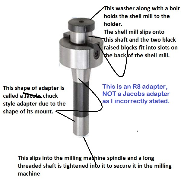

    Here is what a shell mill adapter looks like. Basically the hole in the center of the shell mill is the same diameter as the shiny part below the washer.......but the outer diameter of the shell mill can be different sizes. Allows interchangeability and fewer/cheaper tooling.

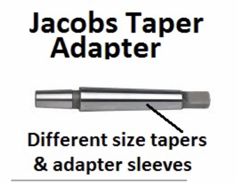

    Shellmill holder.jpg Jacobs Taper.jpg Correction: Bobss396 pointed out that I incorrectly identified the mounting shaft on the tool above as a "Jacobs". It should have been labeled an "R8". They are two completely different shapes by different manufacturers. When buying tooling for industrial milling machines, these are the normal two choices, and I had a brain fart and switched them in my mind. Thanks for pointing that out Bob, as I strive to post correct information and truly appreciate the opportunity to correct it.........
    O:pldtimers disease is a pita.

    That is actually an R8 taper, used on milling machines. Shell mills are tough on small machine spindles, I see most of them used on CNC mills using a #30 and #40 morse tapers and larger. I also used them on large manual vertical and horizontal mills. Real workhorses like Van Normans amd Cincinnatis.

    Good Catch Bob, and you are correct. My oldtimers caused me to "brain fart". Thanks for pointing that out. I will insert a correction in my original post.:)
    The Jacobs taper is commonly used on drill bits of larger sizes for lathes and large drill presses. The machine will have a large taper and then tapered sleeves are used to get the correct size. You slip a tapered sleeve on the taper on the drill bit until its the correct size for the tapered hole in the machine. The flat end prevents the drill from turning as the tapers seat into the machine.

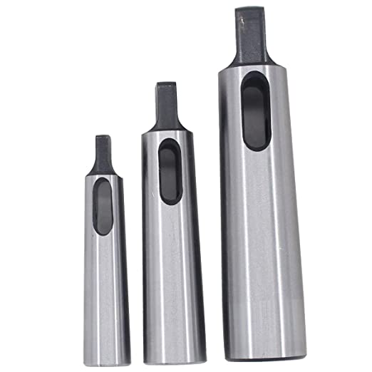

    And bonus points are given to the purpose of the slot at the top....

    On the adapter? So you can get the other tapered tool out. Heck, even my old Post Tool import press came with the tapered piece to remove the chuck;)
    Oh, tip when sticking another inside, keep the flat sideways to the slot, not inline with it. So much easier to remove what was in there.

    Not really sure what you mean by that. The flat at the end of the taper should be in alignment with the slot before sliding them together. Thats the only way it works. Then when someone wants to separate them later on, a taperered "punch" called a "drift" is inserted into the slot and smacked with a hammer to cause them to separate. Really basic and simple.
    Smaller drill presses have a "drill chuck" that accepts straight shank drill bits.........but the chuck itself is mounted to the machine spindle via a jacobs taper. It usually is not removed and often does not have a slot to facilitate removal.
    On a lathe, the tailstock will have a jacobs taper and its common to insert either a drill chuck or just a drill bit into the tailstock. There will be a slot to allow quick removal when done, but generally the machinist just cranks the movable tailstock till it bottoms against the tang on the end of the drill or chuck.....and it pops free. Can't do that on a drill press.
    The point here is that when drilling smaller holes (5/8 and smaller) a drill chuck will first be inserted into the tailstock. The drill chuck will have a jacobs taper that is inserted into the tailstock, and usually at least one of the adapters will be needed to get it to the proper size to fit the tailstock.

    Drift Pin.jpg Anyway the "drift" punch is simply a tapered flat sided punch that is driven like a wedge into the slot causing the tapered surfaces to separate.:)
    One additional thing is that some machines use a "morse taper" which is simply a different angle than a jacobs.......but for most things we deal with you will probably use the Jacobs or the R8 type holder mentioned earlier.
    Removing a Jacobs taper from a lathe tailstock

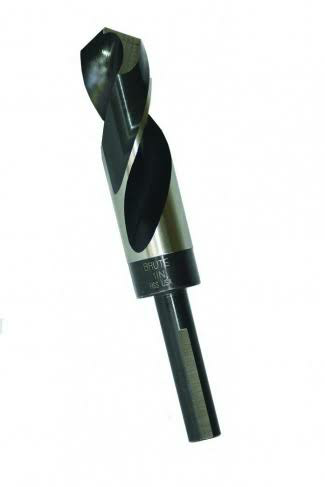

    The Silver and Deming drill bit was the best invention since the introduction of the drill chuck.

    The taper of the drill shank never came up to block the drift hole, so the drill could easily me knocked out of the holder taper. Most drift keys were chained to the drill press table so they wouldn't get lost.

    Yes, they help a lot when trying to drill larger holes with a chuck rather than a direct mounted tapered shank. Notice the 3 flats on the shank of the drill which help the chuck get a better grip on the drill. When using a large drill like that, those flats really help.

    Those are nice drills. Years back my brother shows up at the shop with a new set of drills he got at a garage sale. They LOOKED nice, but on the first hole he drills, the drill bit folded up like wet pasta.
