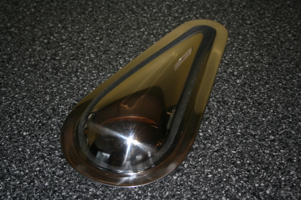

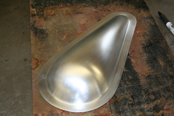

    I made this blister,I might put it on top of an air cleaner I going to make not sure yet.

    Aircleaner mock up.
  3. Tight !
    How did you do it ?
  4. lehr
    Joined: May 13, 2004
    Posts: 602
    lehr
    Hammered it into a shot bag to stretch it out, then hammer it over different dollies to smooth it, then sand it and polish it.

    the blister turned out great, A tear drop blister is my favorite hot rod shape they just look good
