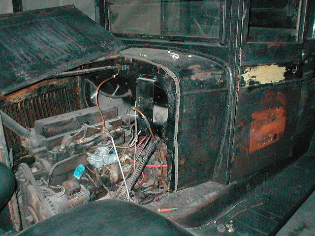

    That is NOT a roadster/phaeton cowl, it is 30-31 Model A Ford cowl which was used on U.S. Mail Trucks and sold on AA truck cowl and chassis to aftermarket body builders.

    Thanks for the input. That jives pretty well with what the p.o. told me about the cab. That's were I got the "Hercules" in the title of this thread, that's what he thought it was. Ford cowl and chassis with Hercules aftermarket cab.

    Throughout the years Ford has offered cowl and chassis truck units to the aftermarket for use, primarily through the 60s as school buses. In the T and T and early V8 era there were many makers of moving vans, stepvans, armored cars, and other commercial applications who bought these cowl/chassis setups. Ford, GMC, Chevrolet, Dodge all offered a version of the cowl/chassis truck.

    Is this what you started with?
