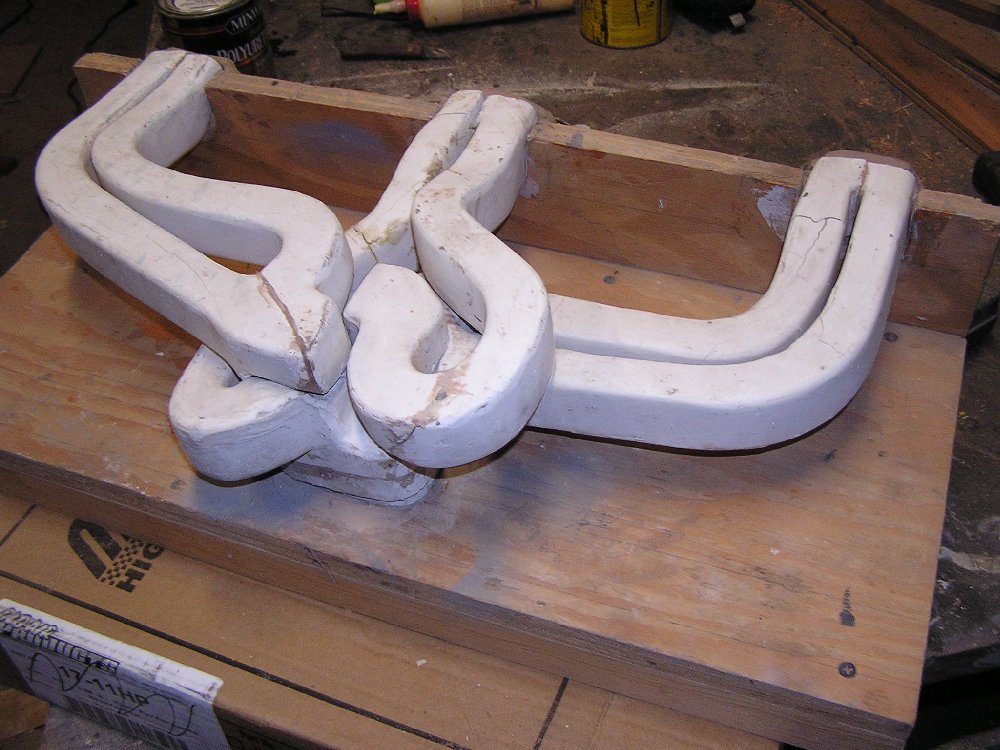

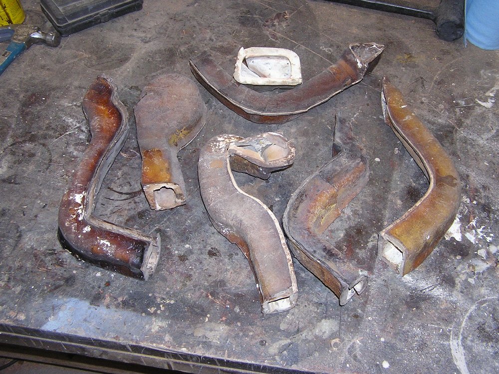

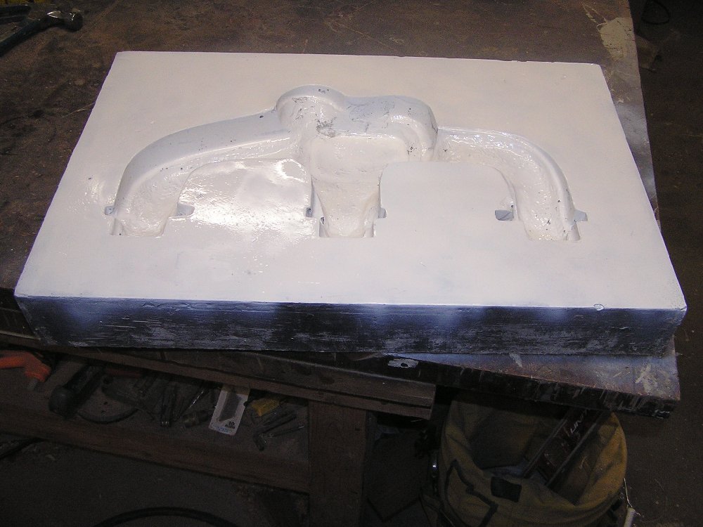

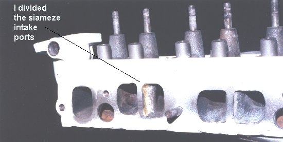

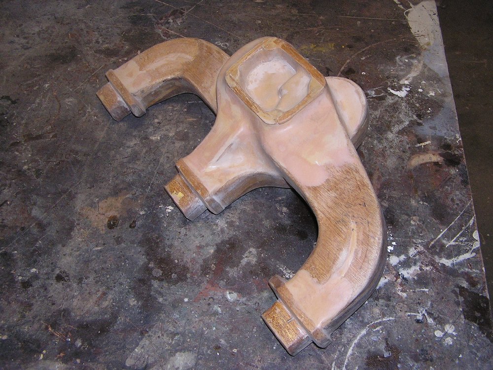

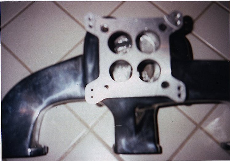

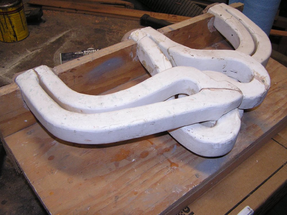

  18. Cool old thread. I did something similar. Wanted a 4bbl isolated, equal length runner manifold for the 230/260 series Chevy straight 6. Required putting Devcon liquid steel dividers in the Siamese ports, then making a pattern forb the aluminum manifold casting. Came out pretty nice, Had a local small foundry who did the casting, not very expensive. Carved the pattern in mahogany, made a plaster cast of that, lined the female cast runners with 1/4" clay then cast the runner patterns in plaster. Finally made runner molds from fiberglass for forming the sand cores. Made a fiberglass match plate to help make cope and drag.
