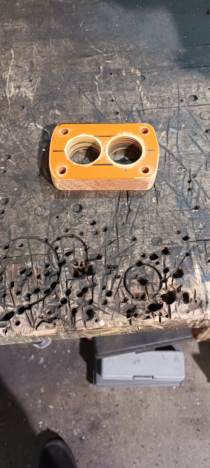

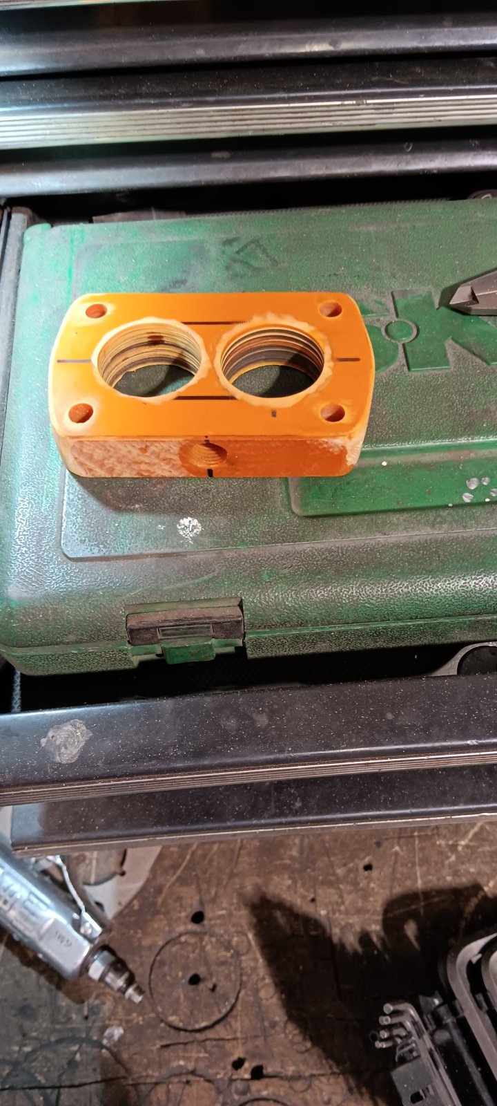

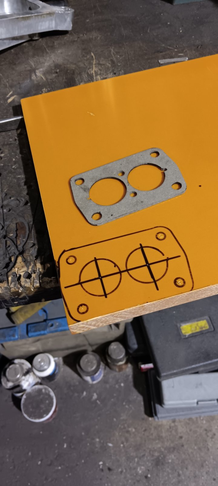

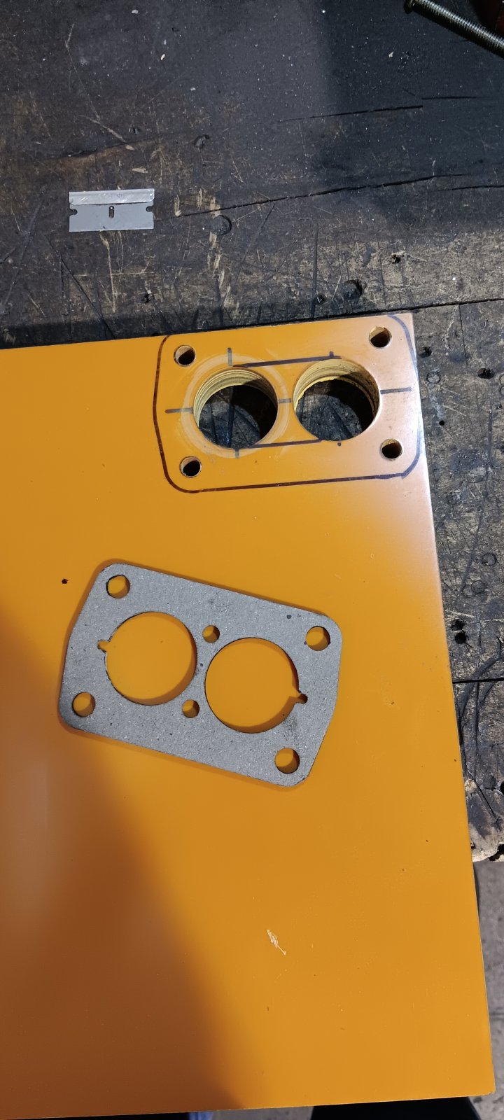

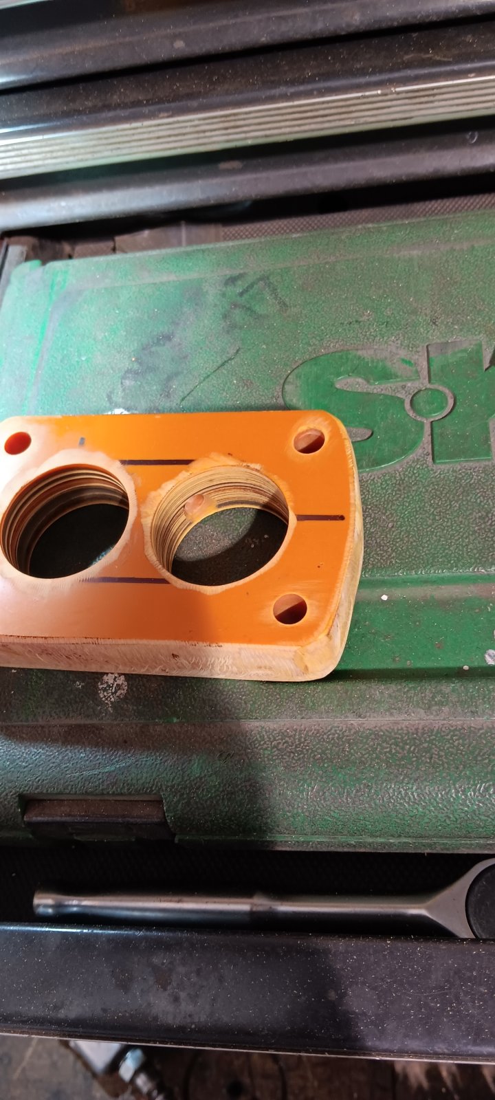

    Everybody knows that the heat and the new gas ****s. About halfway home The car is running warm and it starts cutting out And I have to flip the electric fuel pump on. To combat the boiling fuel, I was looking for a phenolic spacer for my 55 Plymouth with the Carter 2 barrel, but couldn't find one. I ordered a sheet of phenolic material for about 40 bucks and within an hour I had my own finished piece. Also put a port in it for a PCV. 20240904_152406.jpg 20240905_080353.jpg 20240905_083116.jpg 20240905_085559.jpg 20240905_085555.jpg

    Posts: 3,348

    I'll put it on tomorrow and then drive home and that will be the test.

  14. wheeltramp brian
    Joined: Jun 11, 2010
    Posts: 3,348
    wheeltramp brian
    I got the Material through Amazon and I used a drill press and a hole saw.

    Basically hand work, but... Scribe the manifold shape to the "bottom", of the spacer. Scribe a second line about 1/3 or 1/2 of the way down each throttle bores of the spacer.
    Now, with a 1/2", or 3/8" diameter rotary file, carefully open the bores to smoothly "blend" the round holes into a square hole.
    Get rid of the "dead air space" under the spacer.
    Like this -
    Mike

    I think what Mike is saying is. Make each mating surface/bore match.

    Once I get it apart, I'll see how it is and if I want to blend it or not.
