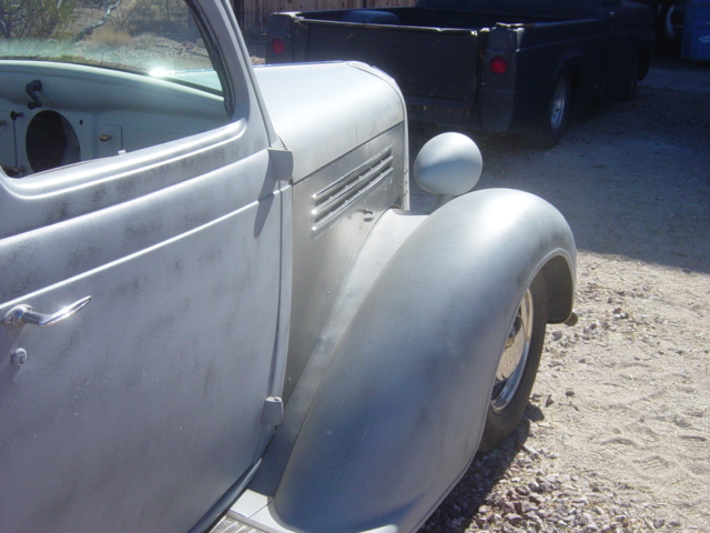

    Not really a Tech Thread ( forgot to take more pics of it ).
    But I did shoot some of the finished result.

    Make the slits with a Pullmax then bolt on the spears? Looks real good.
  10. metalshapes
    Joined: Nov 18, 2002
    Posts: 11,130
    metalshapes
    Yeah, I used the Pullmax.
    Basically they are 31" long louvers.
    I had to make some strengthening strips on the inside, so they'd keep their shape over the full length.
    I pressed the right shape in them with a little piece I made out of aluminum.
    So they'd all be the same.
    ( 4 per louver, 2 per side, X2)
    I bought a Spotwelder at Harbour Freight to weld them on with, but turned out to be a complete piece of garbage.
    So I punched holes in the strips and roset welded them, with my MIG.
    The stainless trim pieces are actually for a Ford...
    I cut the piano hinge part off the original sides.
    And the latch and lower strengthening rib are off the original hood sides too.
