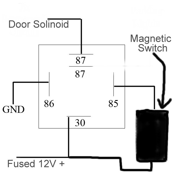

  1. ok, i'm no rocket scientist...but i have a current setup with the electric remote. been years since i messed with it, so without looking at the wiring, isn't there a relay currently in it? Can you just wire into that? Also the magnetic switch or sensor, are you talking something from home depot type hardware stores? is there a good brand you use?
  2. Yes, as I said above, you only need 1 relay. The relay (whether its a new one or one in your set up) is what carries the load to activate the solinoid, rather than the switch carrying the amp load. You could even wire the switch in conjunction with your fob and use either/or, or even as a backup (but you still want to have a mechanical back up).
    Yes, we use the cheap plain magnetic alarm switches like you get at home depot or radio shack. You can go more high end if you like, but I have yet to have a cheapo one fail me.

    I tried finding the switches at Radio Shack and all of the hardware/home stores near where I live with no luck whatever. I finally went to Amazon and found them. I even found them in black which will fit much better with my colors. I have a kit from A1electric.com so I'm planning on hooking these into the existing relays as a back up in case I leave the fob in the car. I will just put a magnet somewhere on the car or in my wallet. I also will have a mechanical back up.
  4. Ok, I've been asked for a wiring diagram on how to do this. There are a few ways depending on your magnetic switch. I use ones that are called "normally open" whick just means if you run an OHM meter across the opposite sides they will be open and you get no reading, if you hold the magnet near it, they close, giving you a connection.
    If somone needs me to show a diagram on how to use a "normally closed" switch I can.

  9. If you cant find "normally open" switches, just let me know ad Ill walk you through it. Most alarm ones are normally open.

    :( Hey "prewarcarsforme", I have a slight problem with this system working and wonder if you can help me out. Everything works as it should; wave the magnet over the switch and the door pops. However, the moment the magnetic switch is placed behind a single gauge panel and the magnet is waved, nothing happens. I've tried a magnet that measures about 1 1/2"x1/4"x3/4" (very strong) and it will energize the magnetic switch from almost 2 1/2" away, when it is not behind a metal panel. Have you experienced something like this. Love the setup, but can't get it to work as it should. Thanks in advance.

  12. I havent had the issue. We have used them countless times behind metal (in fact ALL of them have been behind metal. Heres what I would try. First, take a piece of sheetmetal on your work bench and try it. This will tell you if your magnet is truly strong enough. If it doesnt do it on the bench test, then it might mean your magnet isnt strong enough. If it does, then what I would make sure is, since its behind a dash that you are only going through a single piece of sheet metal on your dash, and not several layers.
    The switches are extreemely sensative, and even a week magnet with no interference would activate it. If youve ever seen the magnets used on the alarm switches, they are very small. If adding the sheet metal stops it, the magnet its self may not have enough draw.

    :( "PWCFM", I've done what you have said and that is....I took a piece of 20Ga sheet metal (about 4"x6"), placed the alarm switch behind the metal and brought the magnet close to it. It worked! As a matter of fact when I bring the magnet to within 3" of the alarm switch (without any metal between the two) it energizes. Placed it behind a single panel on my COE and brought the magnet close to it. Nothing. In fact the magnet is so strong that when I bring it within 3/4" away from the sheet metal, it becomes stuck to the metal very quickly and is very hard to remove. I think that my problem is that the sheet metal is too thick (almost 16Ga) and the expanse is great and the magnetic waves course throughout the sheet metal without affecting the alarm switch. I really, really love this system, but am at a loss as to what I can do next.
  14. Where exactly are you putting the switch in the dash? Maybe place it near the bottom/back so there is no steel between it? Let me know where you are putting it and maybe I can help with a solution. Ive donr it a ton of times, and as you saw with the 20g it worked fine. Always more than one way to skin a cat.

    I was at Harbor freight and bought a pair of their magnets (craft) which are quite large, thinking they would set off the alarm switch. They didn't. I would mount the alarm switch somewhere else, but my Ford COE ('42) is devoid of all chrome or any stainless. These trucks were not exactly glittering in any respect. And so I am at a loss as to where to put the alarm switch. I know the magnets are strong because they will set off the alarm switch as much as 2 1/2" away (without anything inbetween).

  23. I dont know what to tell you, we do it all the time. Maybe if you cant get it to work under the dash, maybe put it under carpet, or behind a door panel, or even inside your seat covers. All I know, is what I showed pics of works, even several guys have chimed in and said theyve done it, so I would look at either different magnets or an easier place to mount it.
