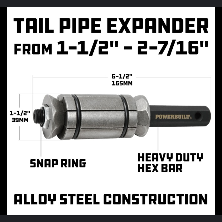

    Nothing that would bother me. But I weld all my joints vs clamping.

    If he actually is "bending the pipe" every exhaust pipe bender I have ever used has a pipe expander built in to fine tune pipes in situations like that. Still those hand use ones don't cost much and work pretty decent.

    I do in fact bend pipe. i have been for 35 years and just bought a brand new huth 2600 bender and also i have a hand held hydraulic expander to use under the car. so i do in fact have the equipment to "fine" tune the pipe. the problem with bumping up the pipe or welding the joints together is the next time it needs something done its a bigger problem. i think about what i am doing before i do it. also i called the customer before continuing on about just welding the joints and that was something he did NOT want done. He decided to use the turbo style mufflers that i keep in stock that are aluminized instead of stainless. Its funny i posted this to make people aware of something that doesnt work the way it is supposed to and tell you what the company had to say about it and all i get is a hard time about not knowing how to do pipe work.

    Yes, the OP could expand the pipes to fit over the ends of the muffler. However, his point is that the tolerances of the product is pretty darn sloppy, adding to his labor, which either he eats or p***es along to the customer. He posted to let others know of the pitfall of this muffler, not ask how to fix it.
