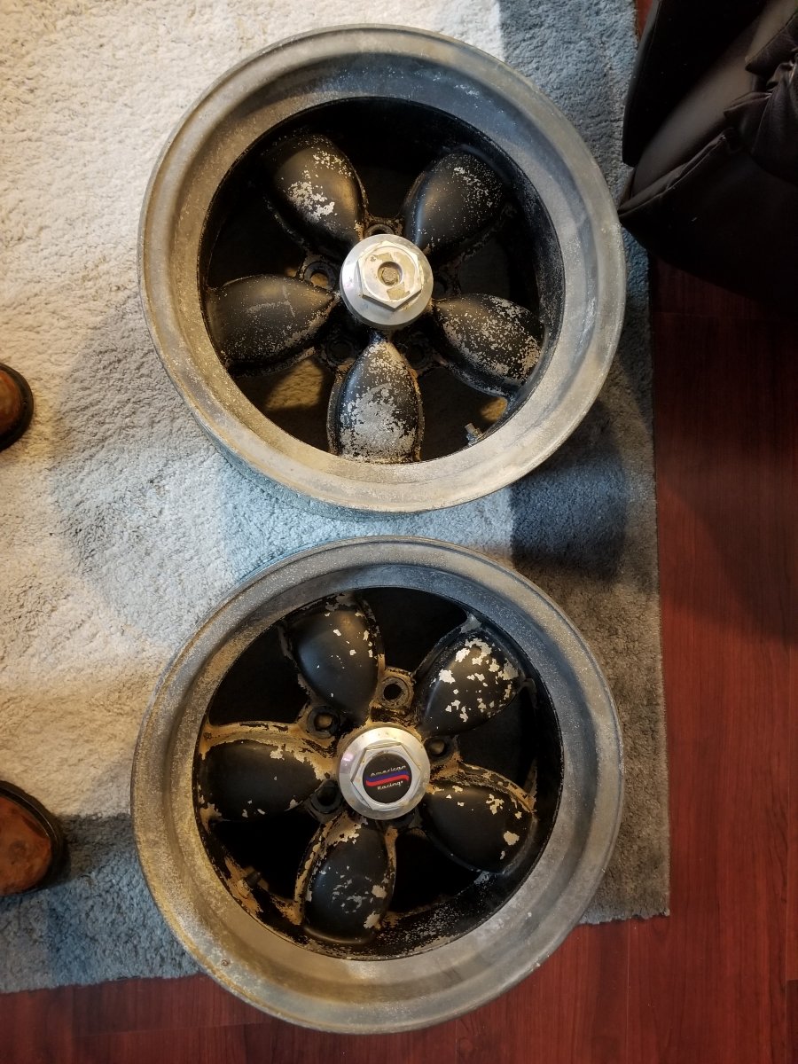

    What years were they produced ?
    I've seen a bunch of aluminum but don't recall magnesium, 15x8 Chevy pattern. Screenshot_20180217-003543.jpg

    1969/1970 , used on the trans am series cars. Pretty dang rare!

    That kind of makes sense with the back spacing it has, I bought them because I had never seen them before.
    Can you pressure wash magnesium, like at a car wash, or will it mar the finish ?

    Swade, I remember those wheels being called American Daisies. Don't ever remember them coming on anything stock. I guess they would have been made by American Wheel Manufacturing? As far as power washing, my guess, why not.

    I've car washed old mags. Didn't hurt anything. Just blow them dry so they don't have water ponding anywhere on them.

    I think those are the same wheels as was used on the TLB '55 Chevy.

    Yes, same design as TLB 55 just different material

    These were always known as a 200-S or "Coke Bottle" American, aluminum, only ever heard of the two piece versions being made of magnesium.
    I was just sure I'd find something here, nothing showing but could be worth a phone call.

  11. washing aluminum wheels is one thing. real magnesium wheels is another. the worst thing ever for magnesium is water. it causes instant corrosion. if you want them cleaned up gl*** bead them. they will eventually turn a dirty grey color again. how fast that is depends on the humidity level they are stored in. dry air is good air.

    They are dirty with dirt, not shelf dust, looks like muddy gravel road kind of dirt, that why I'm considering the car wash blasting.
  13. Magnesium is water proof. If they have painted centers it may blast loose paint off of them.

    Well the car wash and a blow dry didn't make much of a difference ha ha 20180315_165333.jpg 20180315_165346.jpg

    yep....look like basic 200-S Dasiys that were painted at some point.....
