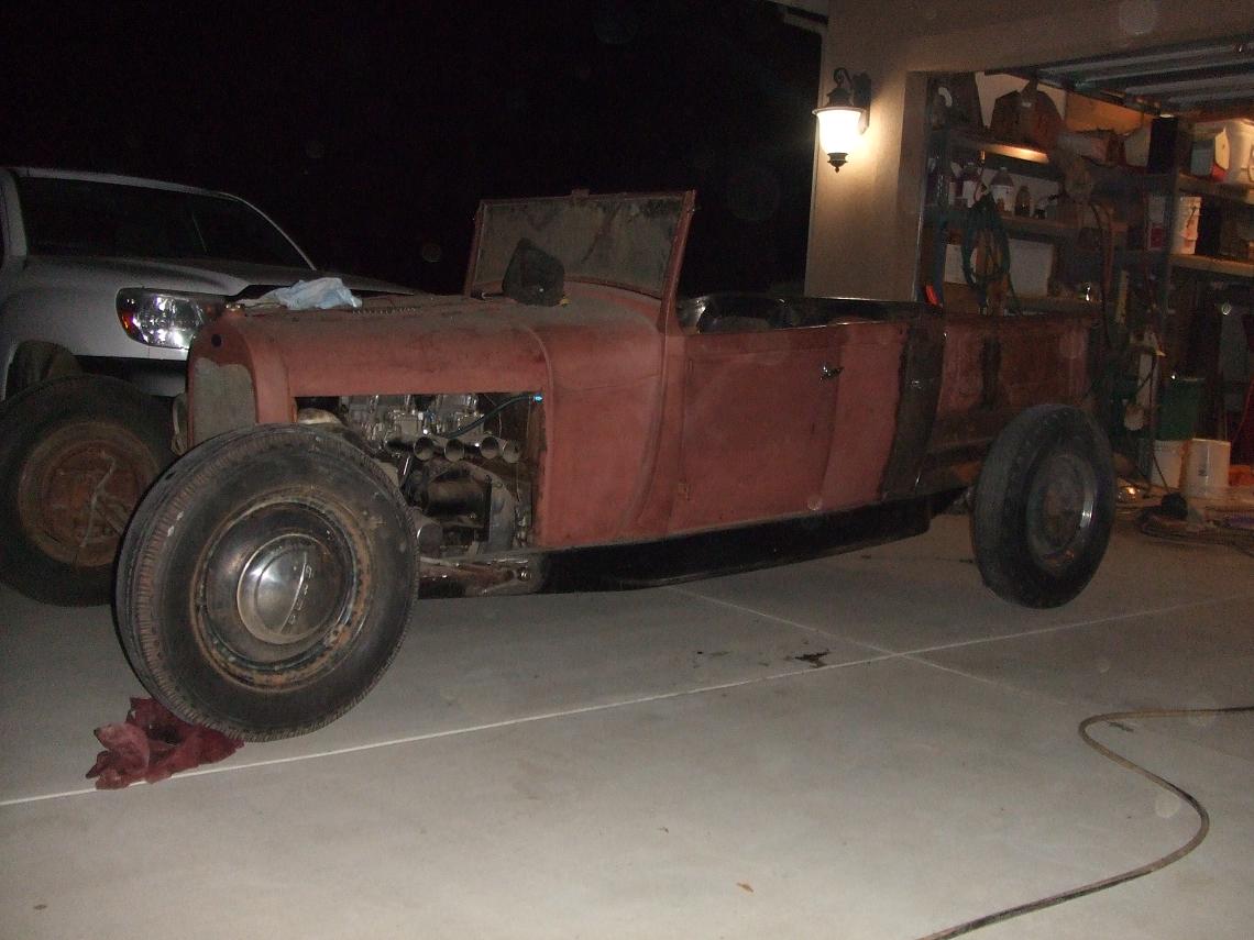

    BTTT.........and some pics to keep it interesting.............. RPU   12_8_15 001.JPG RPU   12_8_15 001.JPG RPU   12_8_15 002.JPG RPU   12_8_15 001.JPG RPU   12_8_15 002.JPG RPU   12_8_15 002.JPG RPU   12_8_15 002.JPG
  14. They look pretty good but we're only seeing the front on one. As others said they are magnesium. Unless they are crazy money or corroded badly you can't go wrong.
    Like your rpu, I'm doing a '29 on '32 rails and lengthening the doors 4".
