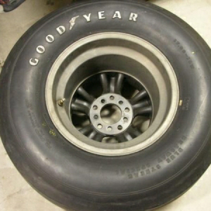

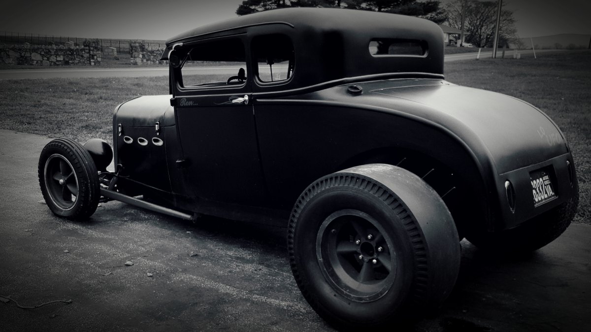

  18. 20200227_153409.jpg Sure here are both versions street and race. Nothing to hide here.
    The car has gone almost 200 mph on the race version.
    The car has seen thousands of miles doing drag week; summit midwest drag and drive events and countless other drives on the street with the other set.
    If the wheels were subject to failure they would have broken a long time ago. 20191006_173327.jpg IMG_2333.jpg 20190810_162716.jpg 20180317_184127.jpg
