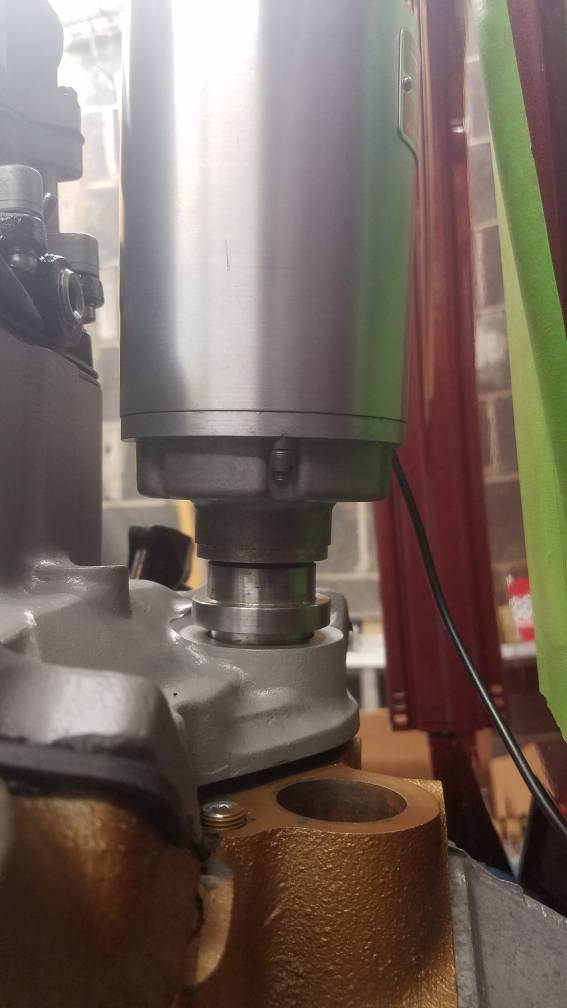

    Hi Hamb's
    Can anybody give me a reason why my magneto wiil not completely drop. I was able to easily drop my old point distributor but this thing will just not go. Its a chevy 283.
    Thanks
    Jeff
    Sent from my SM-G930V using The H.A.M.B. mobile app

    Have you done this before oil pump Drive is probably not lined up

    The oil pump turned out of position.

    turn the crankshaft two revolutions, see if that fixes it.
    Or pull it out and look and see what's up.

    LOL. You guys are the best. I was getting the oil pump shaft backwards in my mind. It dropped right in.

    I had this happen to me once, kicked my *** for a few days. trouble was the drive shaft was too long. it was made from a 1/4 hex key, one of those long reach T-handles. The new distributor was MSD and the depth of the female part was less than the one that came out.

    How thick is that intake gasket? (see photo). Huge gap between horizontal plane of block to intake and what's left for engagement of oil pump is small compared to normal.

    I think I'd be doing some measuring, I ***ume this is mockup judging from the intake. There doesn't look like there is very much engagement into the oil pump drive shaft. Maybe the actual distance is greater than the photo allows but the distributor should have very positive engagement into the oilpump driveshaft, more than what I see in the pic.
