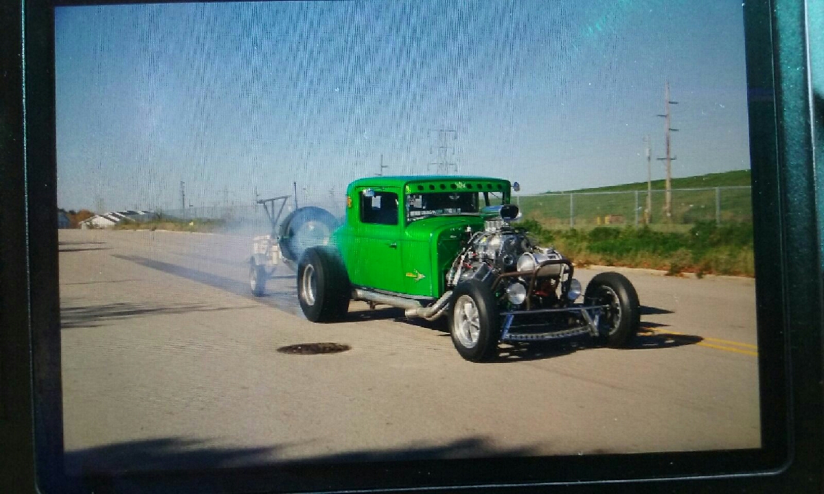

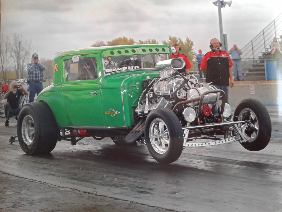

  2. What this thread needs is a few pictures of the axle so a proper inspection can be made. so lets just get one up in the air and take a peak. nope nothing. Im just not seeing a problem with this one. Street or strip its all good. 20161101_085815.jpg IMG_1994.png 20161020_154208.jpg 20161105_112511.jpeg
  3. mad mikey
    Joined: Dec 22, 2013
    Posts: 9,607
    mad mikey
    Looks right as rain to me Brian.:D:cool:
  4. a few shots for the key board engineers.
    xracer40 likes this.

    I'll point out any axle will work with its 'feet' up in the air! Great pictures!
    I get axles from Okie Joe, they're all Henry's axles and dropping them is all he does. There is an art to it that is beyond the physical act of moving the spindle boss' and Joe has decades of experience. I think his website is Joes' Speedshop, its in Oklahoma, go have a look and the prices are right there.
