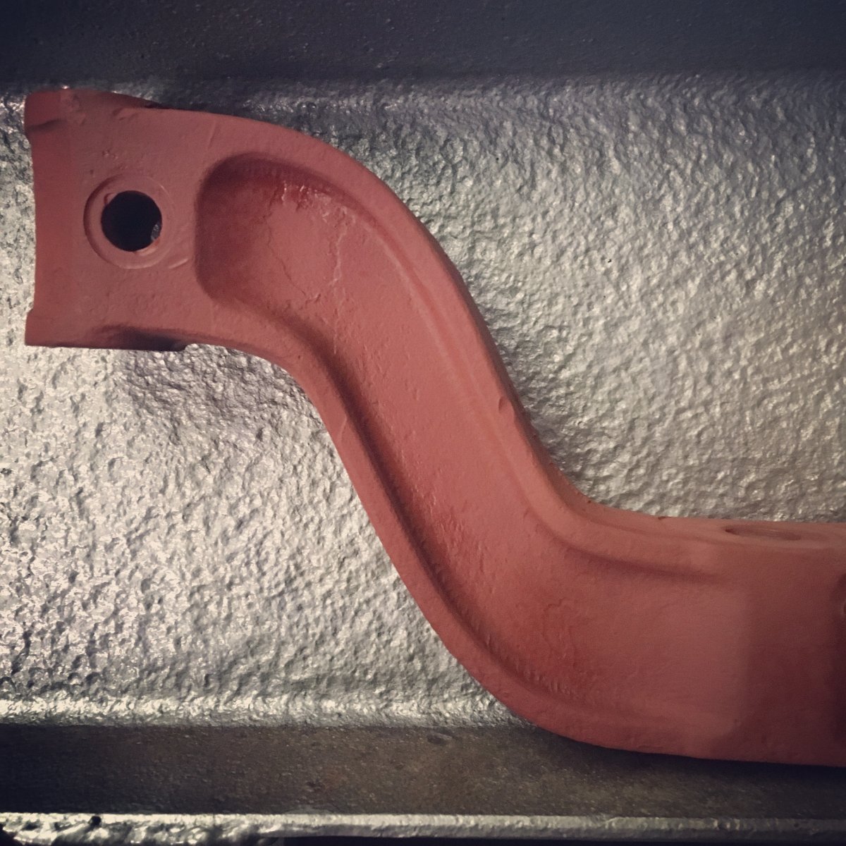

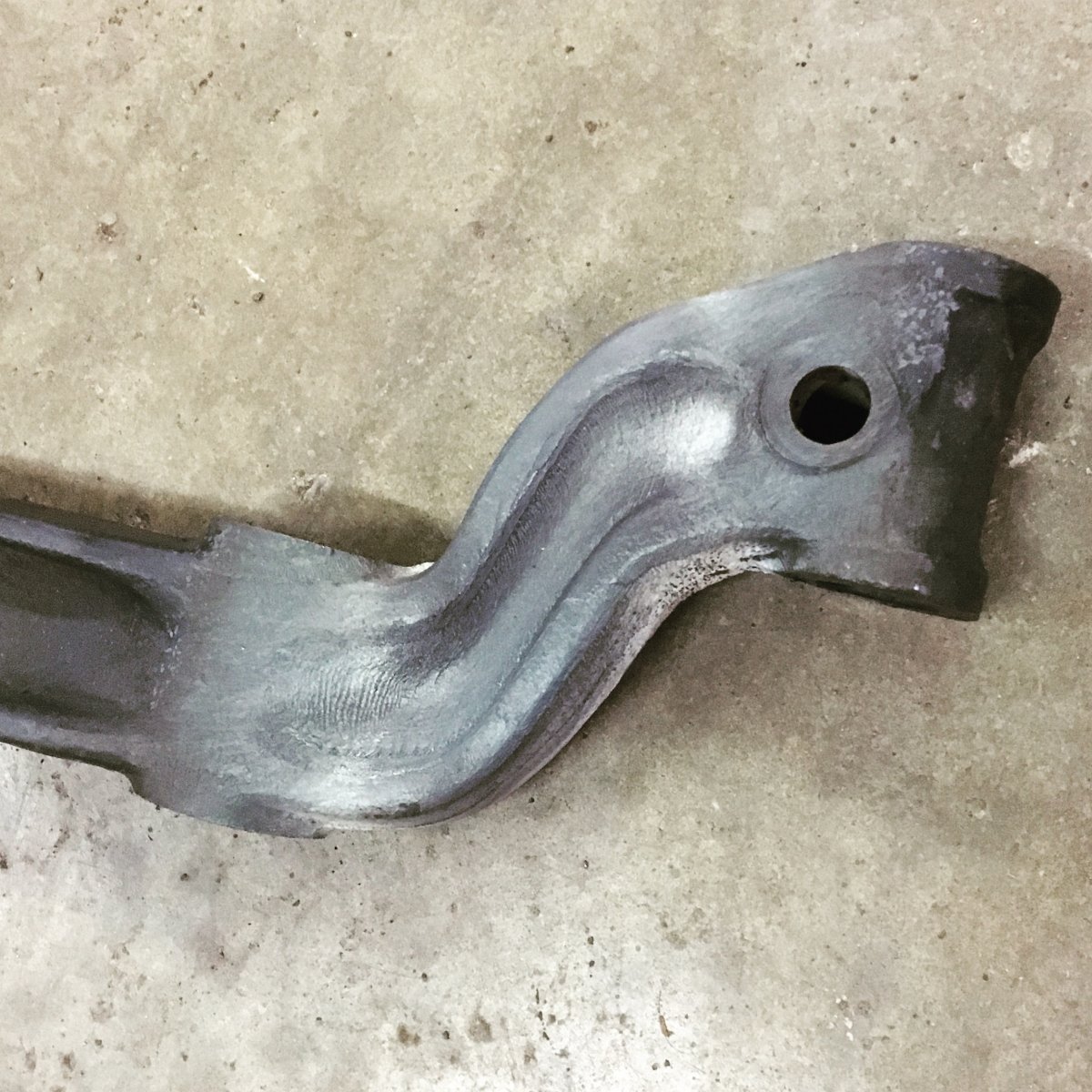

    image.jpeg image.jpeg Hi guys, thanks @trey32 and @Mark T for the plugs!
    I do drop all 28-48 axles here at my shop. It is true that dropping a 37-48 axle much more than 2" and keeping it looking nice can be a challenge. But to be honest, I don't reccomend dropping 32-36 axles more than 2.375" over stock either. Thankfully, Fat fender fords respond well to other small mods to lower the front end so it is still a viable path for a low front end. A 2" dropped axle with a reverse eye, dearched Spring will easily net over 4" of lowering beyond stock. Adding some longer shackles and a simple Panhard bar will get you in the 6" territory pretty easily and still ride and handle great.
    Here are a couple 37-40 I've dropped 2" recently.
    Andy

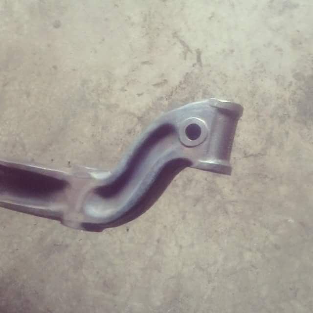

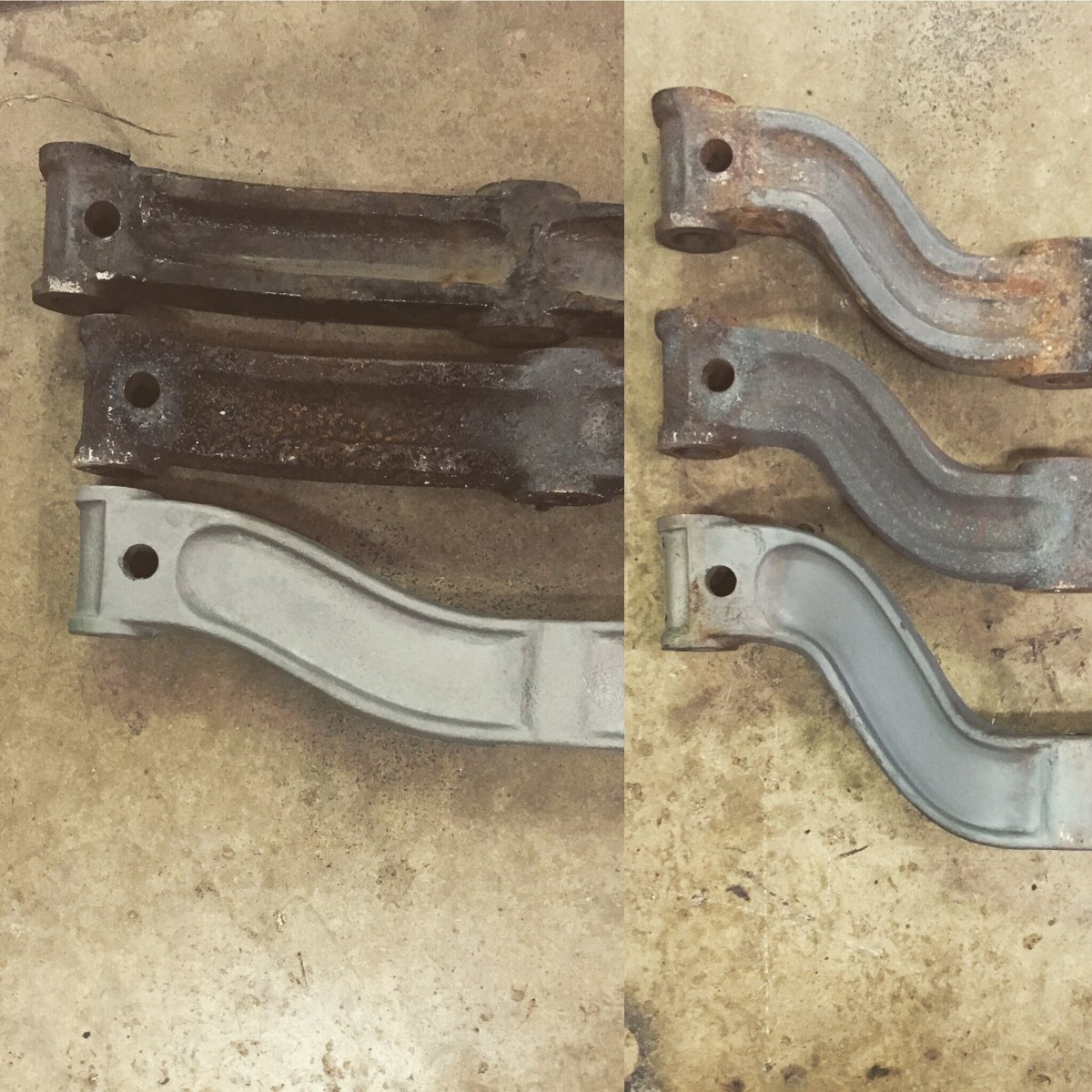

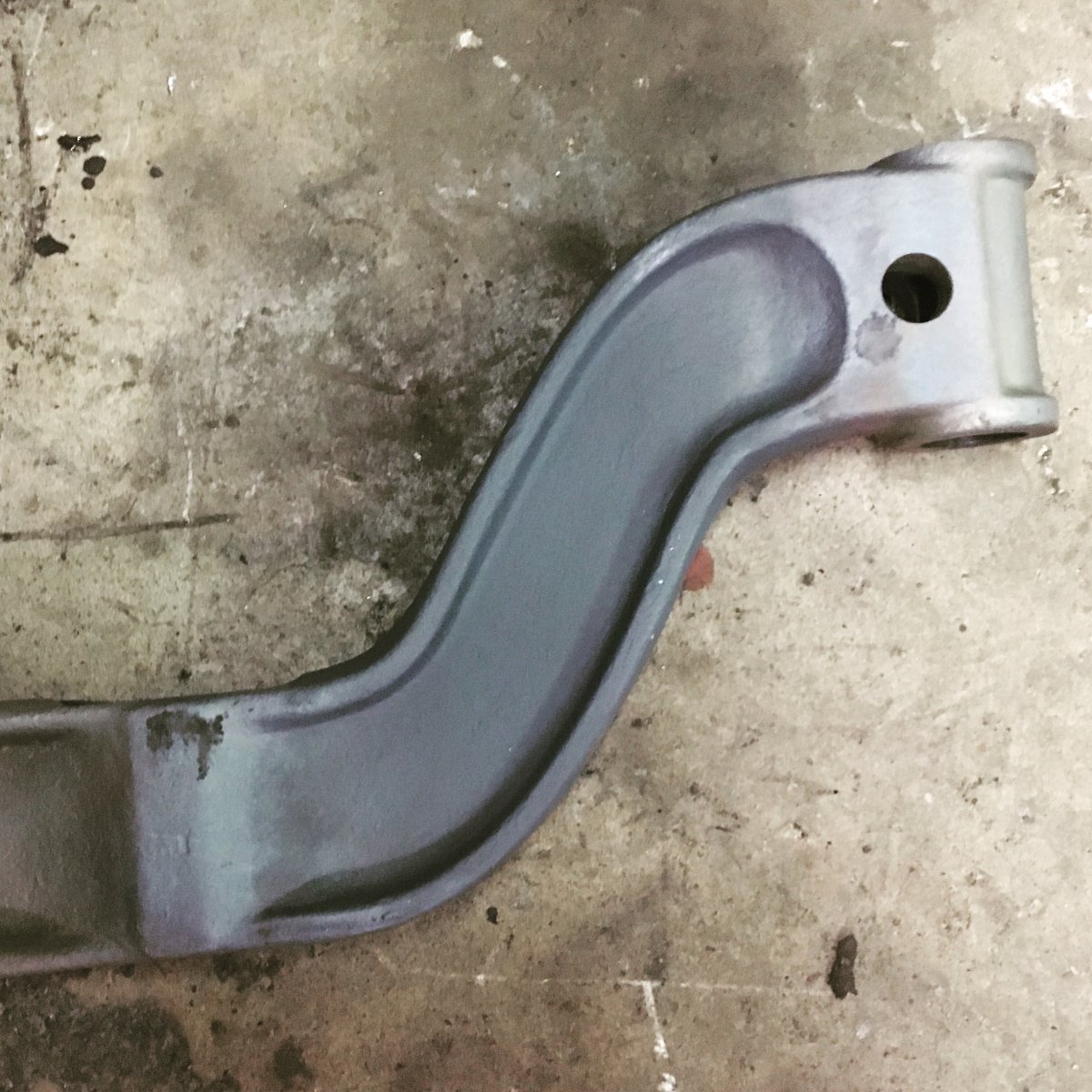

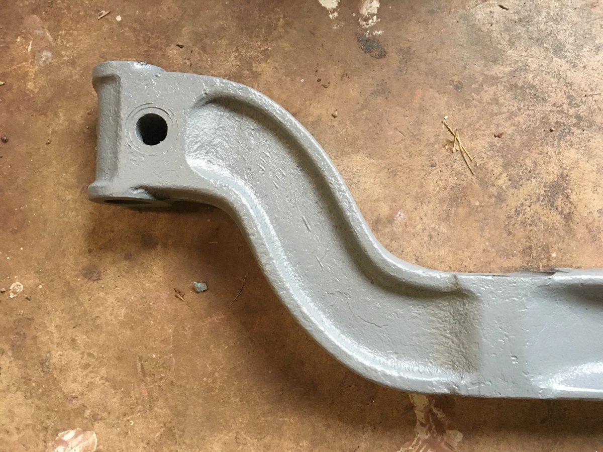

    image.jpeg image.jpeg image.jpeg image.jpeg And a few other earlier axles too...
