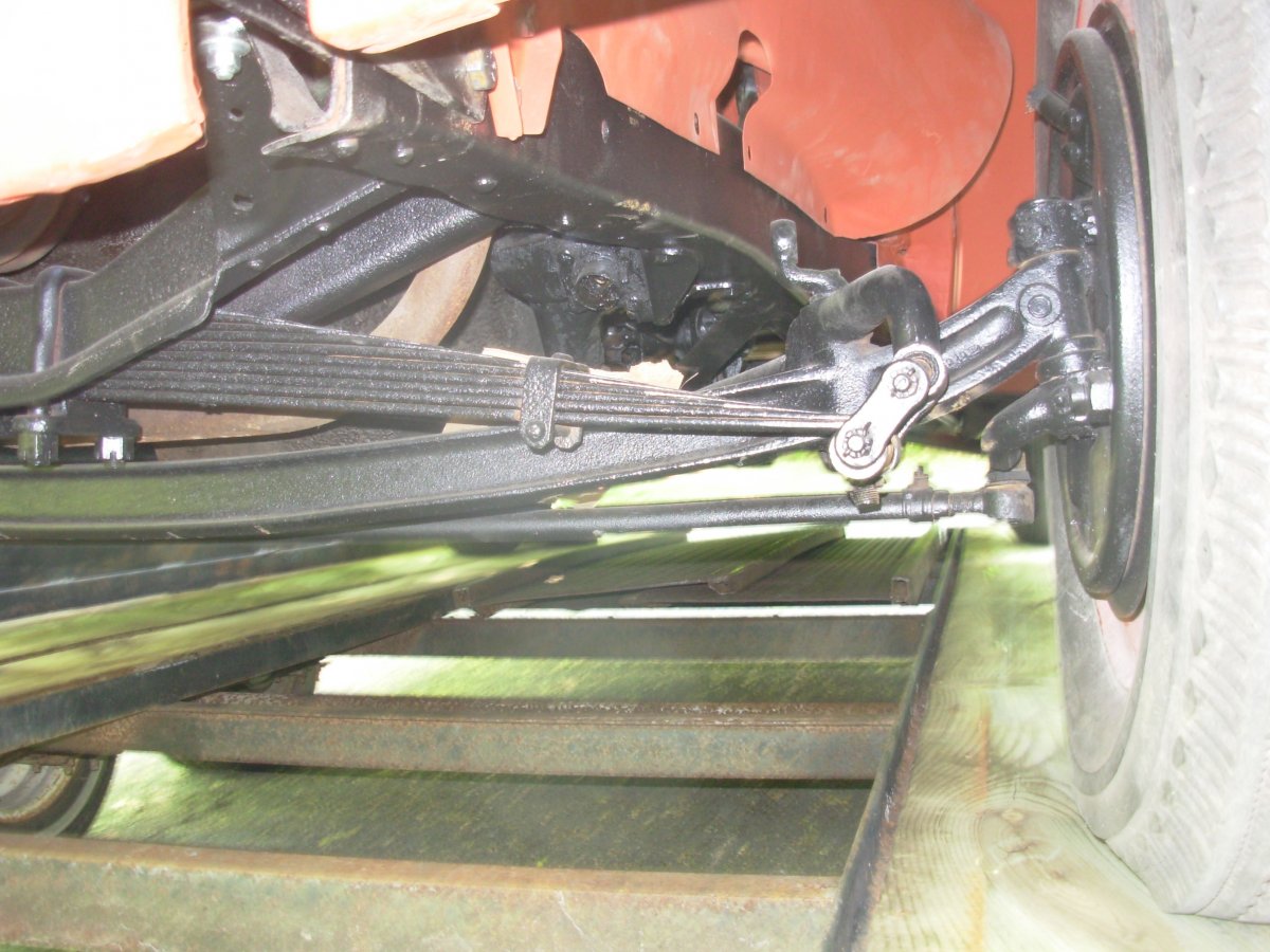

    I know that this thread died back in January, but I was reading it in the archives and I need to make a decision on a dropped axle for my 39 P/U. If I were to drop the stock axle 2", which would be about where I would like it, the wishbones become a lot closer to the Kingpins and I ***ume the steering lock to lock would be reduced by interference with the wishbones (I need to split them for my trans but only by about 4"-5"). Anyone using a dropped stock '39 axle have steering issues like this?

    It may even be more of a problem with the Spring Shackle as you can see in this picture...

    I will send Sid an email with my question, but I can't see how this can work with the spring shackle attached to the end of the wishbone like it is in the picture. I have checked some of the aftermarket axles for a '39 and most of them move the wishbone attaching points inwards by a few inches... ie. the C.E. axle has KP centre to centre of 47" with the perches moved in to 34" centre to centre. With the stock axle dropped, the perches will still be at 38-1/2" centre to centre.

    If you spit the wishbones, it will indeed move the spring perchs. You would need to heat them up, and bent them back to where they would need to be.
    Ford River Rouge forgings are incredibly tough. They can be manipulated with a torch without fear of damage.
