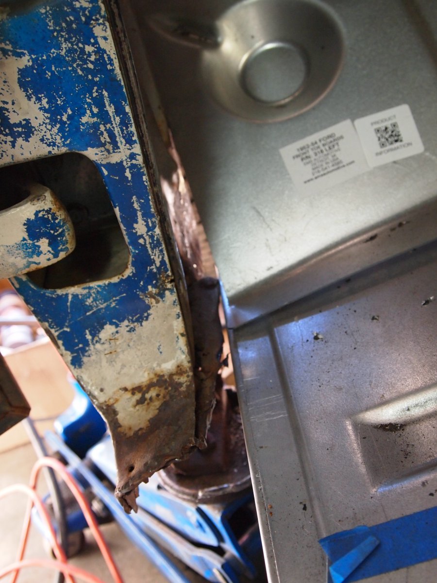

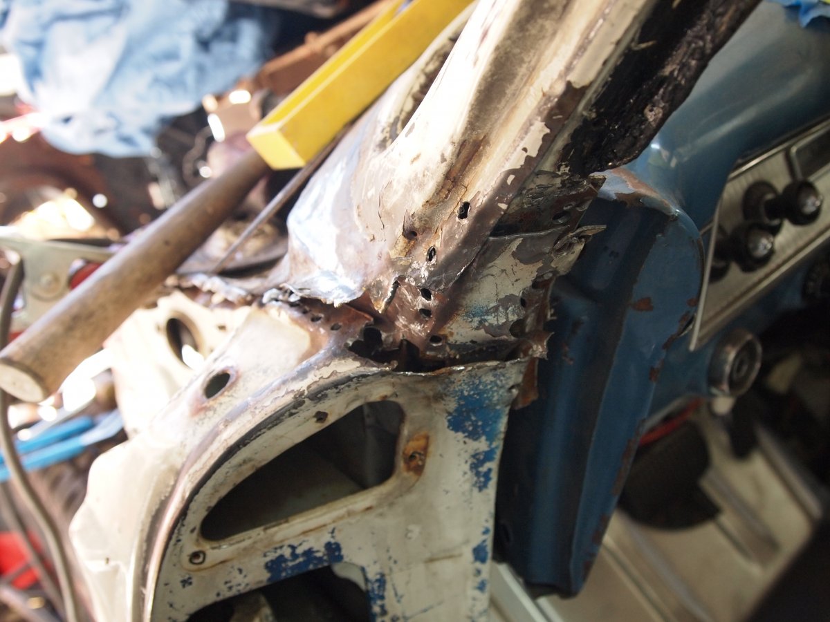

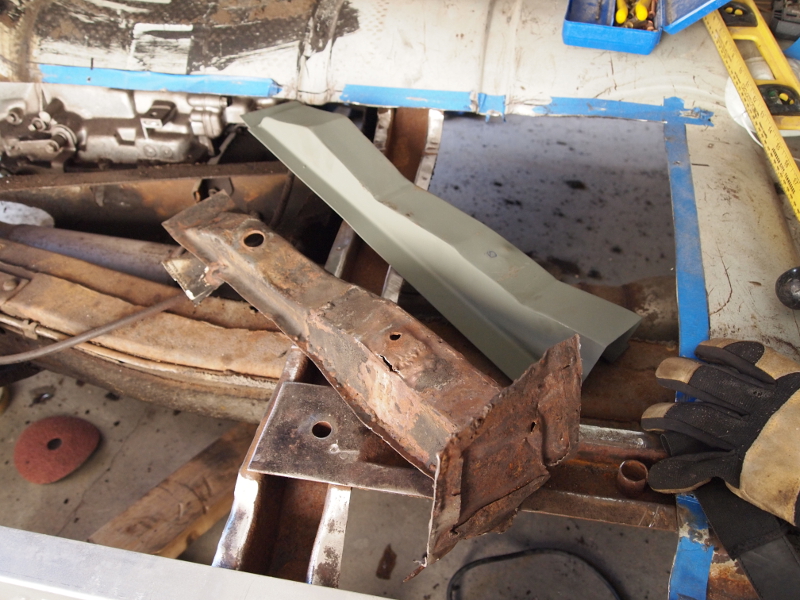

    Did some more things but nothing too exciting. I HATE GRINDING WELDS! Any tips you might offer would be welcome. I bought an air file but the compressor regulator is blow'd up so I had to use an angle grinder and a 36grit fiber disc. I get pretty nervous after patching in a panel that I will grind through the old adjacent metal!
    Finished up the floor brace and it turned out really nice. Old vs New
    Lastly just finished welding in the patch and got the welds mostly grinded down. I think I hate grinding so much I will TIG everything. Also made a little patch for the rocker and door corner.
    MyCrustyVW likes this.
