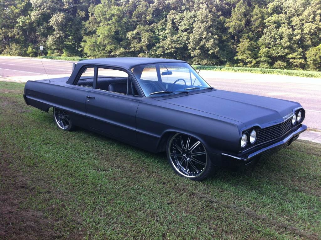

    I bought this car 3 years ago as a 4 door. I cut the posts out hung a set of 2 door doors on it that I had a off of a parts car that the frame was bad on and the body was just real bad. I cut the post out of the 2 door and welded them in place and went to town on the body work. Really the hardest part was welding in the inside panel where the rear window mounts and making the rear window work. I've actually got pics of it as a 3 door and I have driven it like that. People went crazy over it because they never seen a car like that. I told them it was factory like that.

    Wicked car, great job on the conversion!

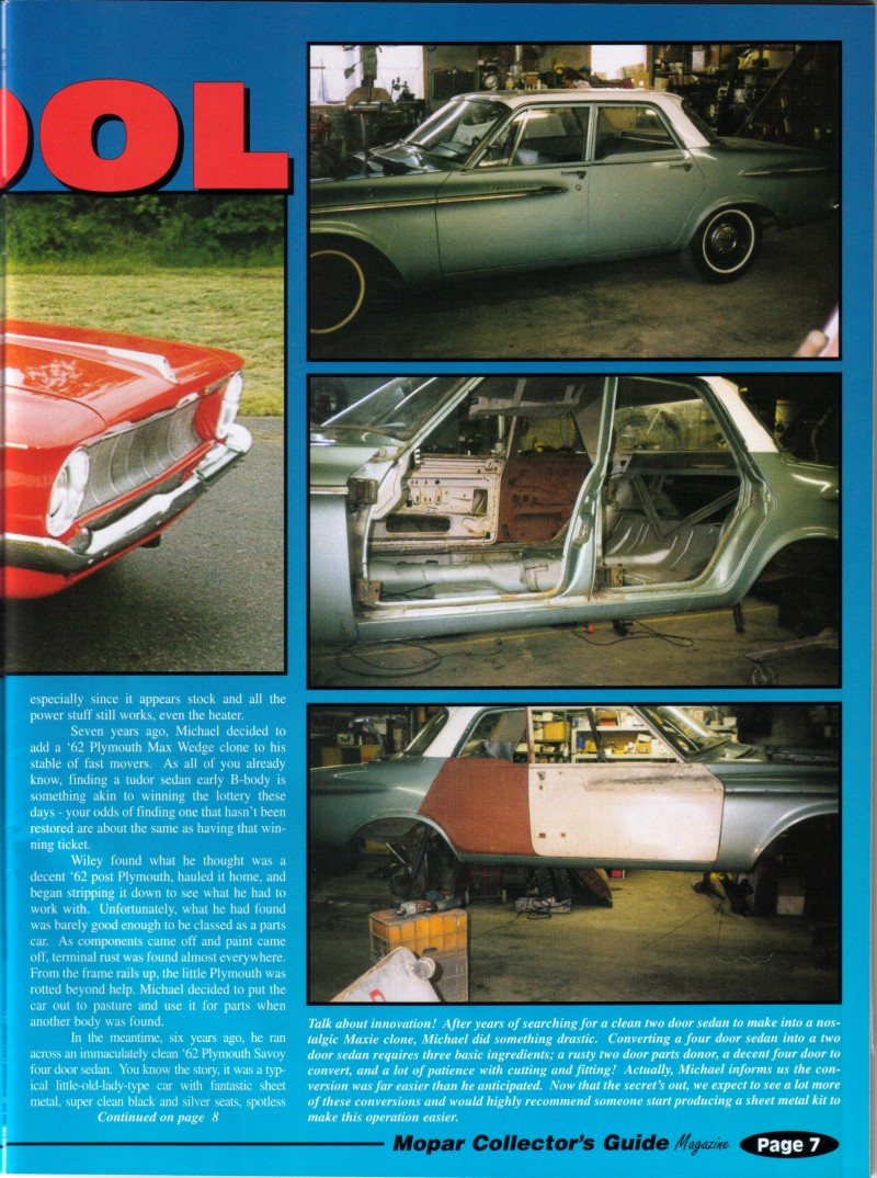

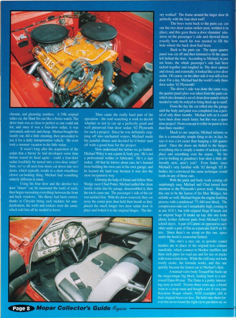

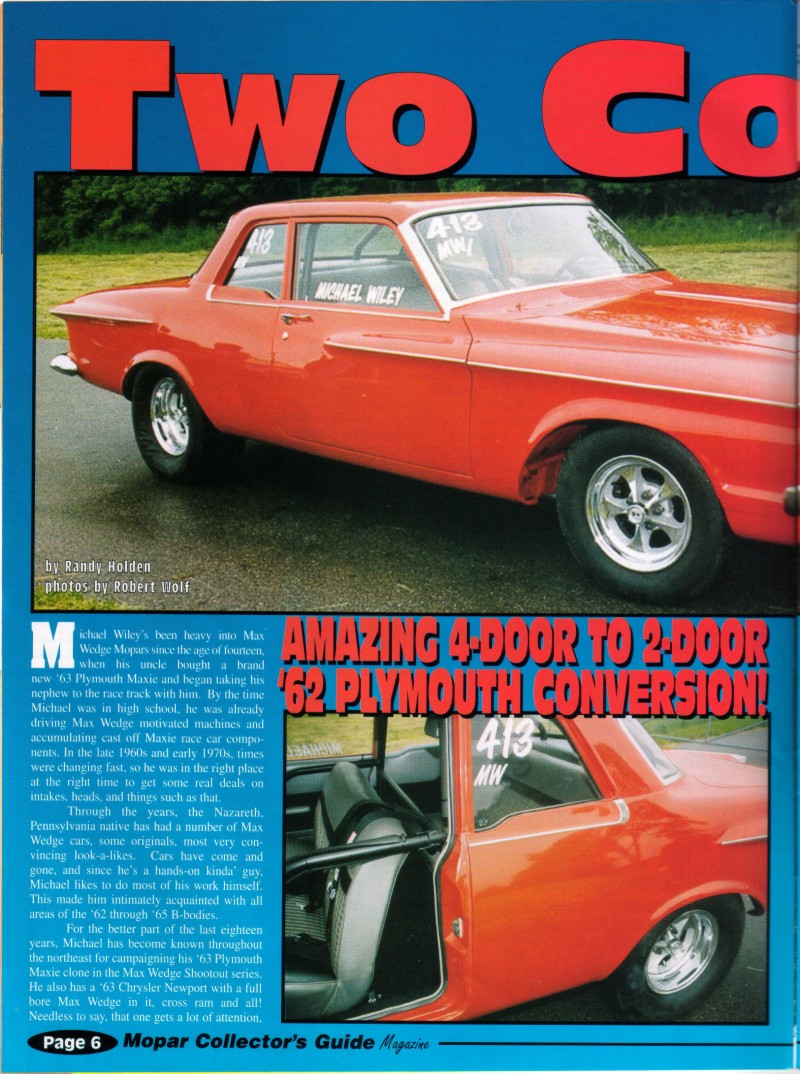

    The Mopar guys have been doing this to early B bodies for years and it is less time consuming than replacing floors in a rotter.
