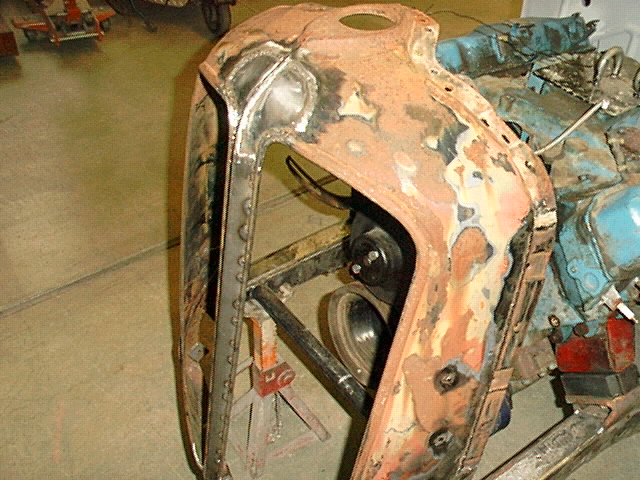

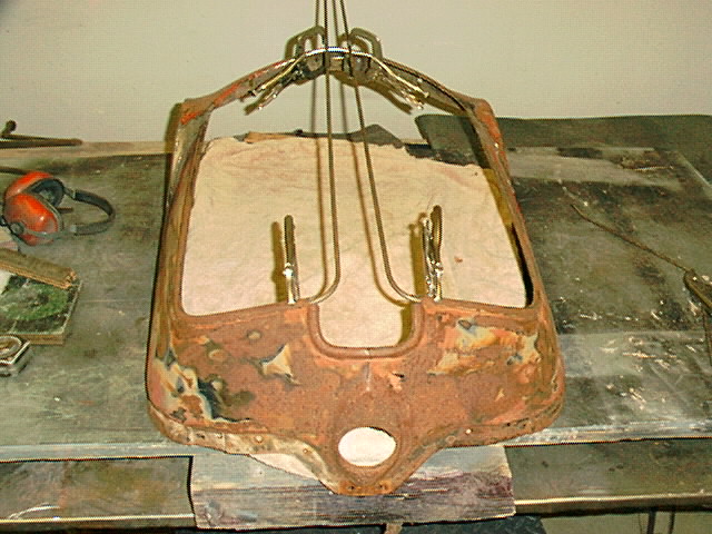

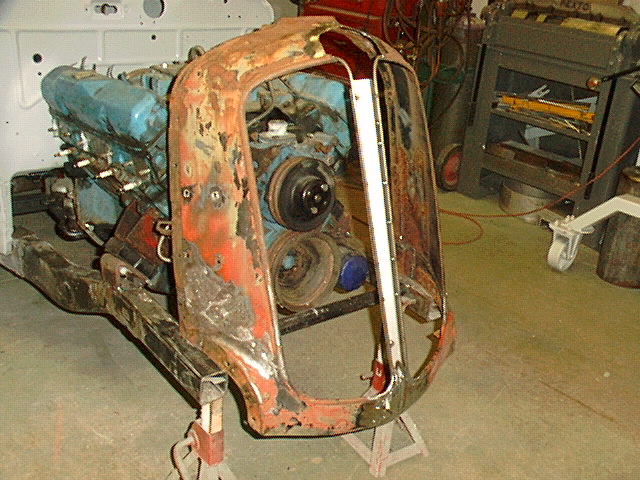

    So i'm still waiting for a front axle so i'm thinking about the grill. I have sectioned 7" out of the hieght and will take some out of the girth. I was thinking about puting in a center bar with a widow's peak and filling in the top. Starting to lay it out. Buddies say "just buy a gl*** 32 grill" No way! Butch what i got! Hand me my hammer and don't spill my beer! Ray

    Time to shake the fuzz out of my head and turn on the welder

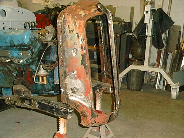

    So i had some time and formed the center peak and let it die off at the chin. As usual the style lines around the opening are a pain to reproduce. Will do the top next, Ray

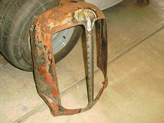

    So i finished up the grill. The center bar is hollow so i sould ad nutserts to the back to hold the grill insert and to ad strength. The widows peak goes from top to bottom now . I wacked 2" out of the side girth at the bottom tapering to nuthi'n at the top. And 7" out of the height. Still don't know if this is the grill for me or not but it looks cool! Ray

    Grill before

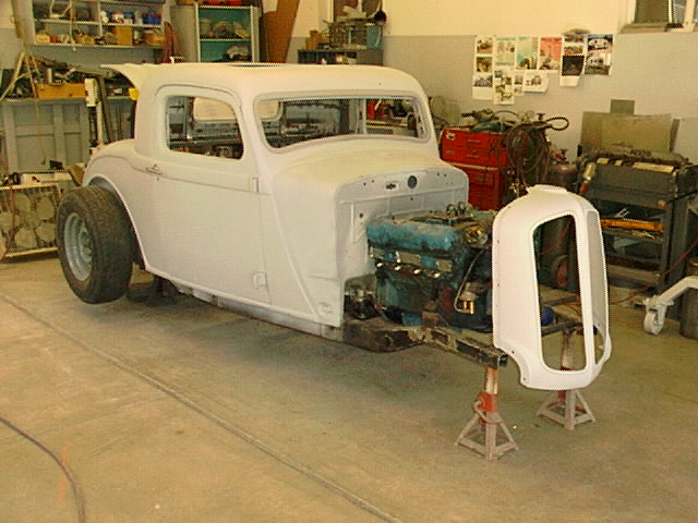

    Got some primer on the grill and trunk lid. Moving along!
