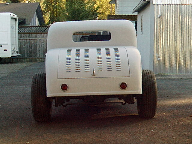

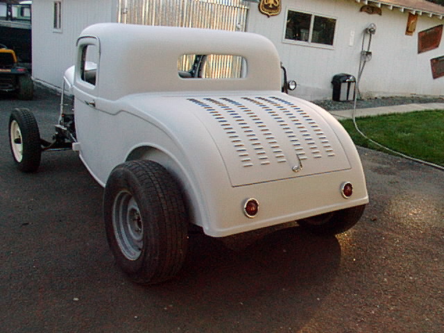

    Ok so i have it as a crude roller. I think i have got the guts of the shell built and the rest will be nuts and bolts. Not to bad for a first time body build that started in Jan. I think that someone walking past the poupe at a show or swap meet would think it's a coupe of some kind and that is what i was going for. I think i will let this thread wither away for now.
    Here is the build in a nutshell for those just tuning in. 36 Dodge 2 ton fire truck cab,3" chop,cab extended 6", recrowned roof and slanted back with a coupe style roof insert. hand built tail,quarters and louvered trunk lid.
    Truck grill with 7" out of the height and 2" out of the girth at the bottom. Widows peak center bar added. Drivetrain is a 440/727/8.8 rear and 36 mopar front axle. Will build as a altered/gasser style racer. Thanks for the support. My next build will be better!!!!!!Ray in Oregon
