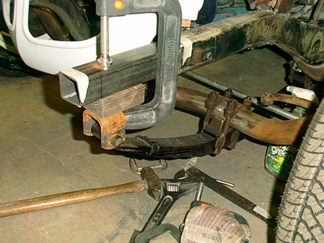

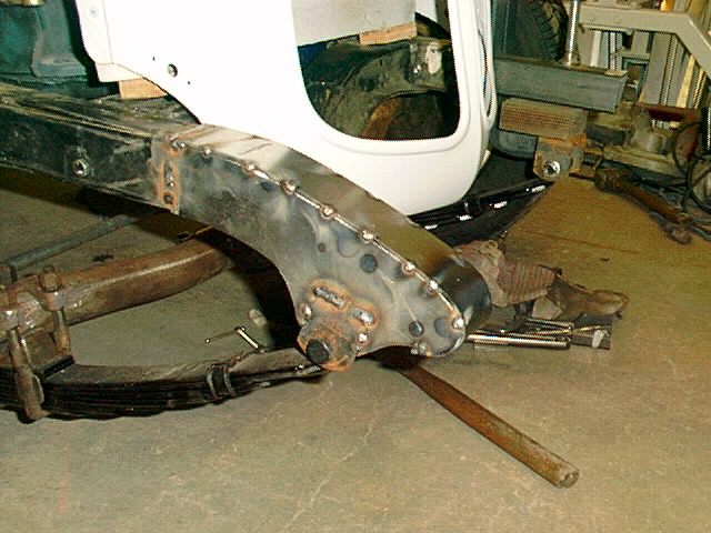

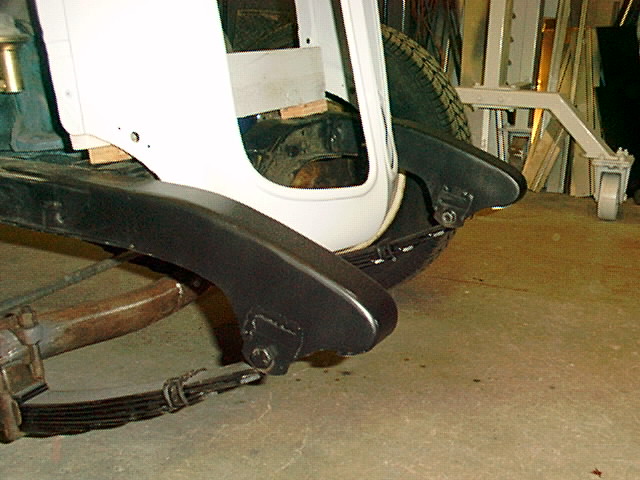

    So because my donor frame was to short for my leaves i had to hillbilly up some front frame horns after getting my ride height figured out.

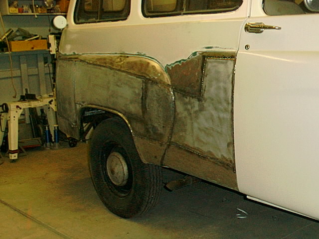

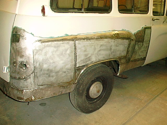

    I needed a diversion from the poupe and scratch built some rear quarters on a Dodge Town Wagon i bought for $50. A old hippie sprayed foam in them to insulate. Not good. Most people would have parted her out......Ray
  11. Squablow
    Joined: Apr 26, 2005
    Posts: 18,544
    Squablow
    Your custom Town Panel quarters look good, reminds me of what I did on my '59 Edsel. It's tough when no replacment parts are available.

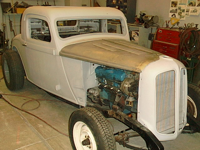

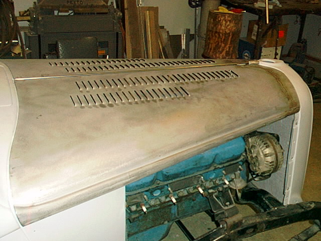

    So i did a little more on the poupe, I stretched the hood at the front 2 1/2" and louvered a couple rows. Now to make it a one piece lift off hood. Ray

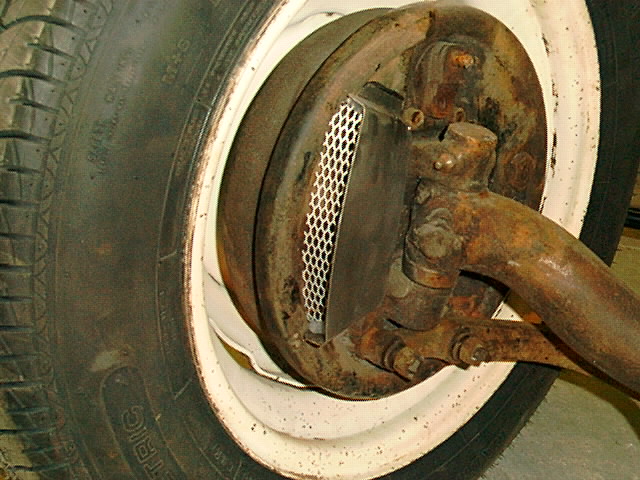

    Working on some racing scoops on the 36 mopar front axle.

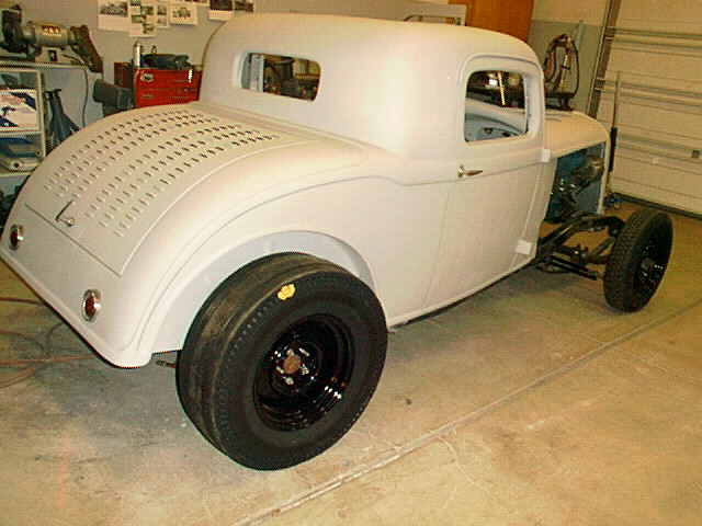

    Went to the boy's here in Oregon city and picked up some Hurst pie crust race tires. Cool!

    do your our louvering?
  25. ronbo
    Joined: Jul 27, 2008
    Posts: 15
    ronbo
    do your own louvering?
  26. frankinplymouth
    Joined: Sep 6, 2008
    Posts: 358
    frankinplymouth
    The rear deck lid is louvered on a flat panel with a turret punch and then welded to a frame. Tha hood is done old school by a buddy of mine. Ray

    Awesome. No criticisms to levy here. GOOD to see the POUPE on new shoes!!!
    (Any thoughts yet RE color, Ray? Sometimes I think those of us who've followed your build thread PUSH you too hard. But, seems like you are up to it!)
