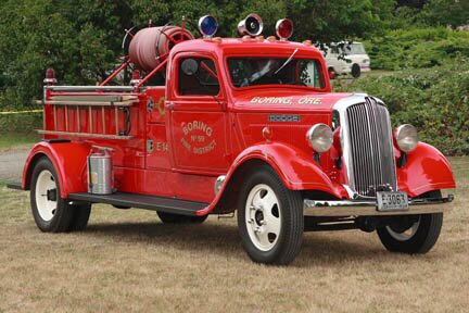

    This is the hood from the truck. It was a two ton. Don't know if i will use it?

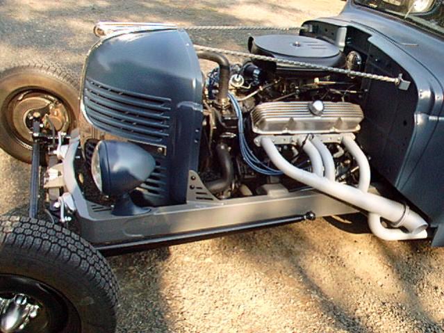

    Sweet, the hood side louvers look kinda like the ones on my '31 A. The Dodge badging would look cool, but might not fit with the style you're going for.
    I like the chop job James D did on it too.
    What engine are you thinking of puting under there? Or have you had time to dream that up yet? Since you've been bussy makin' it happen.:D

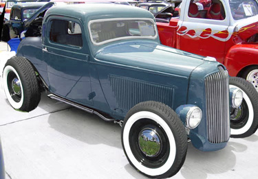

    I know, really bad Photoshop. Shoot me.

    Good photoshop! I was just going to have a go myself, but was having trouble finding a good picture. But then... check this out - have you seen the size of this thing!! Ne**usian was right about the size of that hood!
  11. frankinplymouth
    Joined: Sep 6, 2008
    Posts: 358
    frankinplymouth
    It was a pumper fire truck just like the picture! Ray

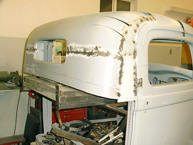

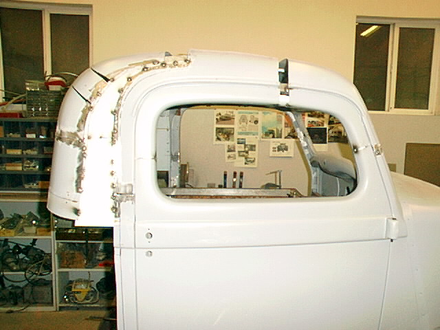

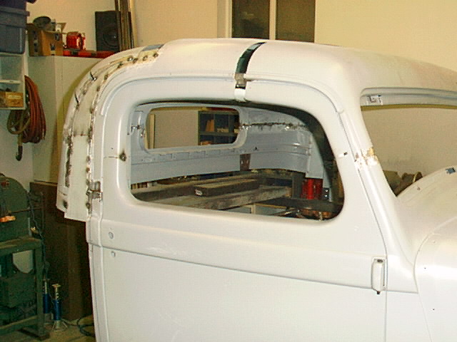

    Hey, so today all the posts and doors got sleeved and tacked. The sail panels are tacked also so now it's not such a wobbly mess. I had built a sliding platform from the cab X brace so i could move the roof back and forth as needed. The top of the roof will be replaced with one large panel because of the change in the crown and it was a mess from having fire truck lights screwed to it and me cutting it up. I won't finish up the top untill the tail gets made so this thread may slow down a bit. I have to go make a living to.........................Sheetrock is my life. Ray

    Have you thought about leaning the rear pillar of the door forward? to compliment the b pillar of your roof.

    I think the doors need to be longer to pull it off, but...
    I'm not sure if you're trying to make it look like any particular year car... or mimic a ford coupe... but what about doing this?
    kicking the back out-
    it makes it NOT look like a pickup... thats for sure...
