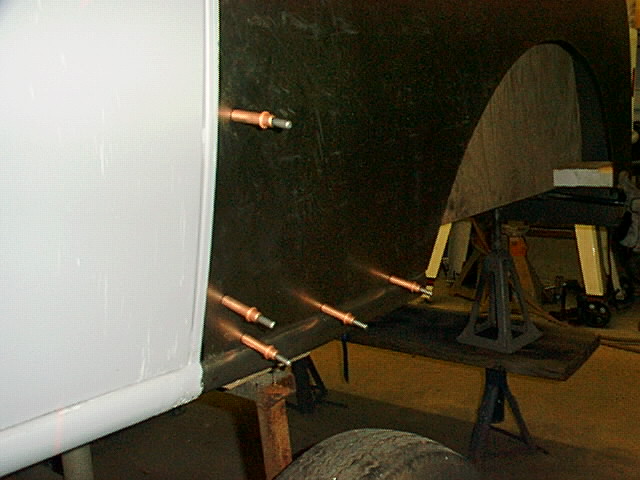

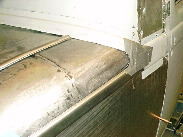

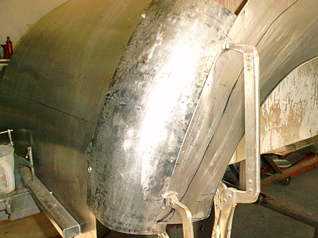

    So i had a little time and worked on the compound curve joining the quarter panel to the rear deck. Hours and hours........... and lots of s**** metal.
    I think i got the shape going on and may use the piece as a working buck or may save it and use it?? I will do the other side and put in the inner fender wells and style lines then weld it up and then cut the qaurters back off. Then build the inner trunk etc.. and put them back on.
    I'm hitting my limit real hard on this one. Hope it works. Ray

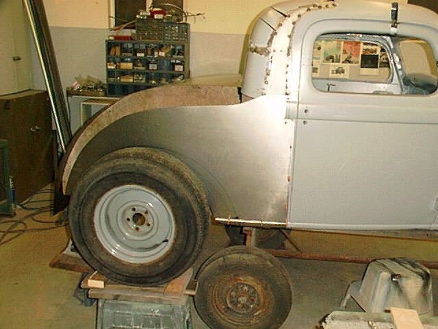

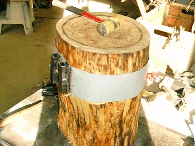

    So i worked on the finish panels of the rear section with the compound curves. I Have figured out that in the real sharp curves i can only work about a 9" square piece
    at a time to get the shape. I have to tuck and shrink a bunch and then smooth with the wheel. About 2 hrs per panel. Then weld together and do some more. This is a heavy learning curve for me but it's noy going to beat me!! I also spent some time making a stump work for forming. It works good along with a shot bag.

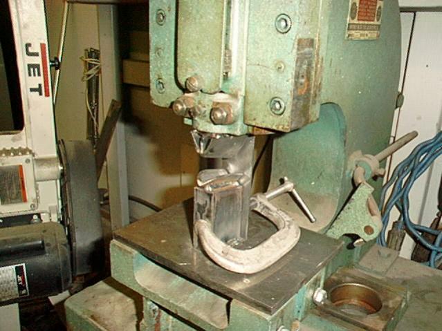

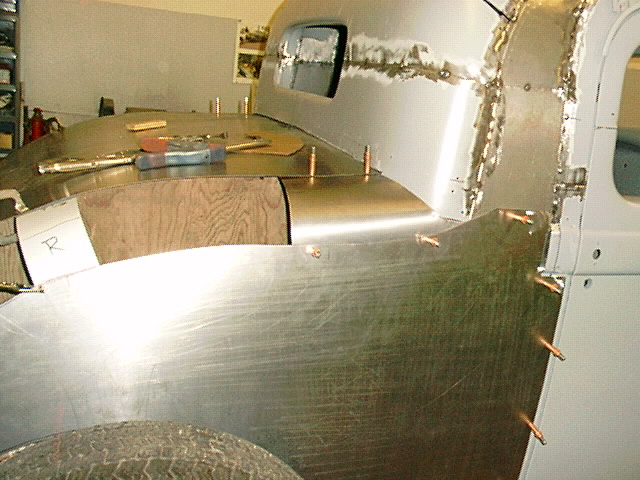

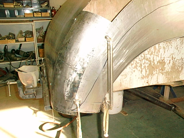

    Got the rest of the upper compound curves done on the quarterpanel now laying out the inner fender panel. Made a tucking tool out of a old single station punch....made lots of s**** metal.Ray <!-- attachments -->

    Put in the inner fenderwell today. Now i have to look at it a while. Went to the Portland roadster show this weekend, Now i'm thinki'n about making her a g***er! Blue truck still F/S

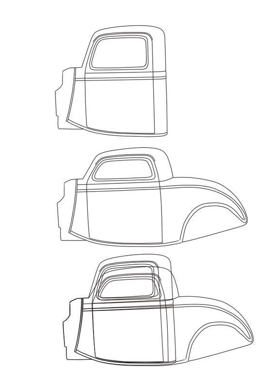

    so i was bored and did this real quick. A 35-36 for cab into a coupe. Looks pretty neat i think.

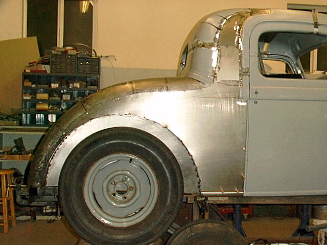

    Been working on the other side. Starting to think about the style lines. This is hard work!
