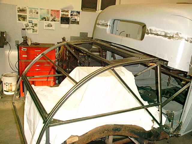

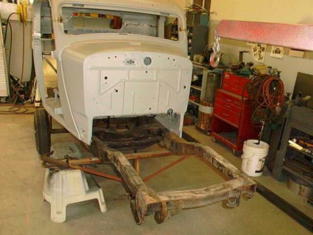

    So i decided i need to mount to a frame before i get to far along. I have built a tube frame for my other rig but found a good donor from a 80 nissan 2wd pu. It pinches just right and is boxed all the way. I will cut all the **** off it and run a straight axle.
  4. frankinplymouth
    Joined: Sep 6, 2008
    Posts: 358
    frankinplymouth

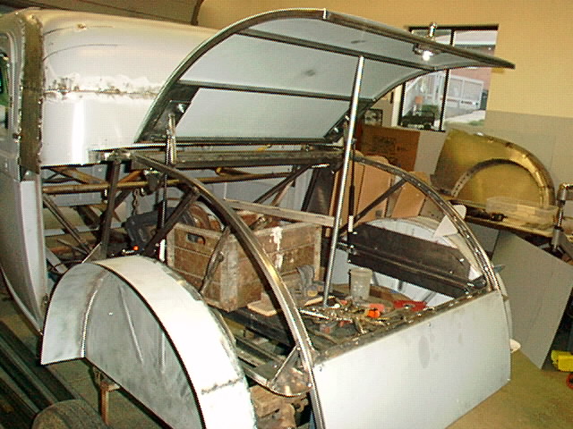

    Still here, I put the wood buck onto the jap frame to check for fit. Then off again and starting to build the skeleton for the sheet metal including a hinged trunk lid. decided to redo all the quarters again.....................Ray

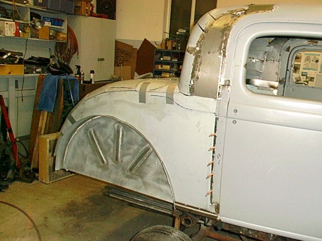

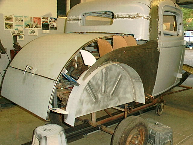

    Another week and creating more s**** metal. I have put on some test panels to check for square and fit. The deck lid will be full of louvers and the tail panel trimmed shorter as needed when i get the new quarters done. The inner fender panels will also be trimmed as i go. I think i'm seeing the end! Ray

    so today I roughed in the tops of the rear quarter panels. I need to fine tune each one and tack it down. Still need to make the style lines.....I feel good enough about the project that i will start looking for a 440 to put in it. Hope to have the thing in primer by the end of summer.

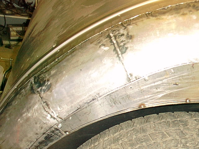

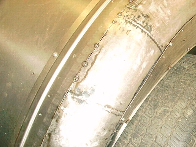

    How did you make the beads in the vertical part of the wheelhouse?
  15. frankinplymouth
    Joined: Sep 6, 2008
    Posts: 358
    frankinplymouth
    I used a plannishing hammer.........not bad for the first time.

    How did you keep the rest of the panel flat in there?
    It looks flat where it's 'sposed to be, in the pics anyway.

    When i did the wheelhouse I marked it out with a ruler and raised it about half way and then over to the flat bench with a large flat bar and worked around the edge of my line pounding on it to take the warp out of it and crisp up the edge , then brought it up more/pound/more.....etc.
    Today i trimmed the back some and the wheelhouse. Welded the upper quarter panels. Next the style lines.
