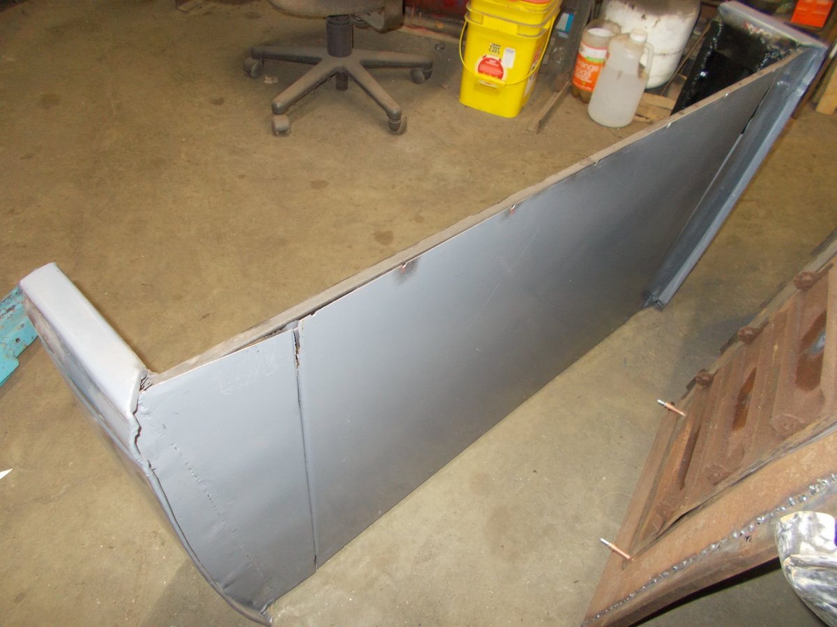

  6. [​IMG]Something im working on
    Runnin shine and chryslerfan55 like this.

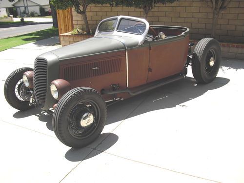

  9. wheeldog57
    Joined: Dec 6, 2013
    Posts: 3,905
    wheeldog57

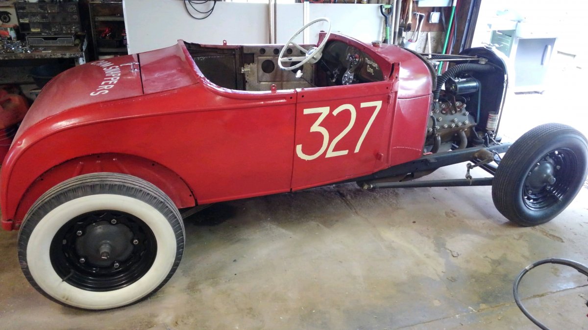

    This is a 28-29 roadster. The cowl is specific to roadster and phaeton. Coupe, truck, sedan share different cowl than this. Note door length front to back, they are very short compared to sedan or coupe doors. The quarter panels are longer on a roadster to make up the difference. Now sedan doors are longer than coupe doors also. This was my first early Ford project and I learned alot. Ask many questions and good luck!

  10. drew1987
    Joined: Nov 22, 2015
    Posts: 682
    drew1987
    That’s pretty much exactly what I want to build! Very nice
    So the cowl is different - can a sedan cowl be used if one wanted to? Or is it a no-go?

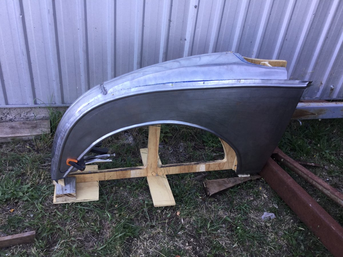

    If you are prepared to put in the effort, it’s possible to build your own from flat sheet metal. I am no expert but I fabricated these quarter panels last year, by using a bead roller, English Wheel, and shrinker/stretcher. I had used none of these tools before 2017 and have never taken any metal shaping workshops. I ordered a Ron Covell DVD that shows you how to create a 1926 Model T Roadster body, and subscribed to various YouTube metal shaping channels. These were all needed to learn what I have. Eastwood sells all these tools and they are affordable enough to be a worthwhile investment.
    vtx1800, Carmover, LSJUNIPER and 6 others like this.

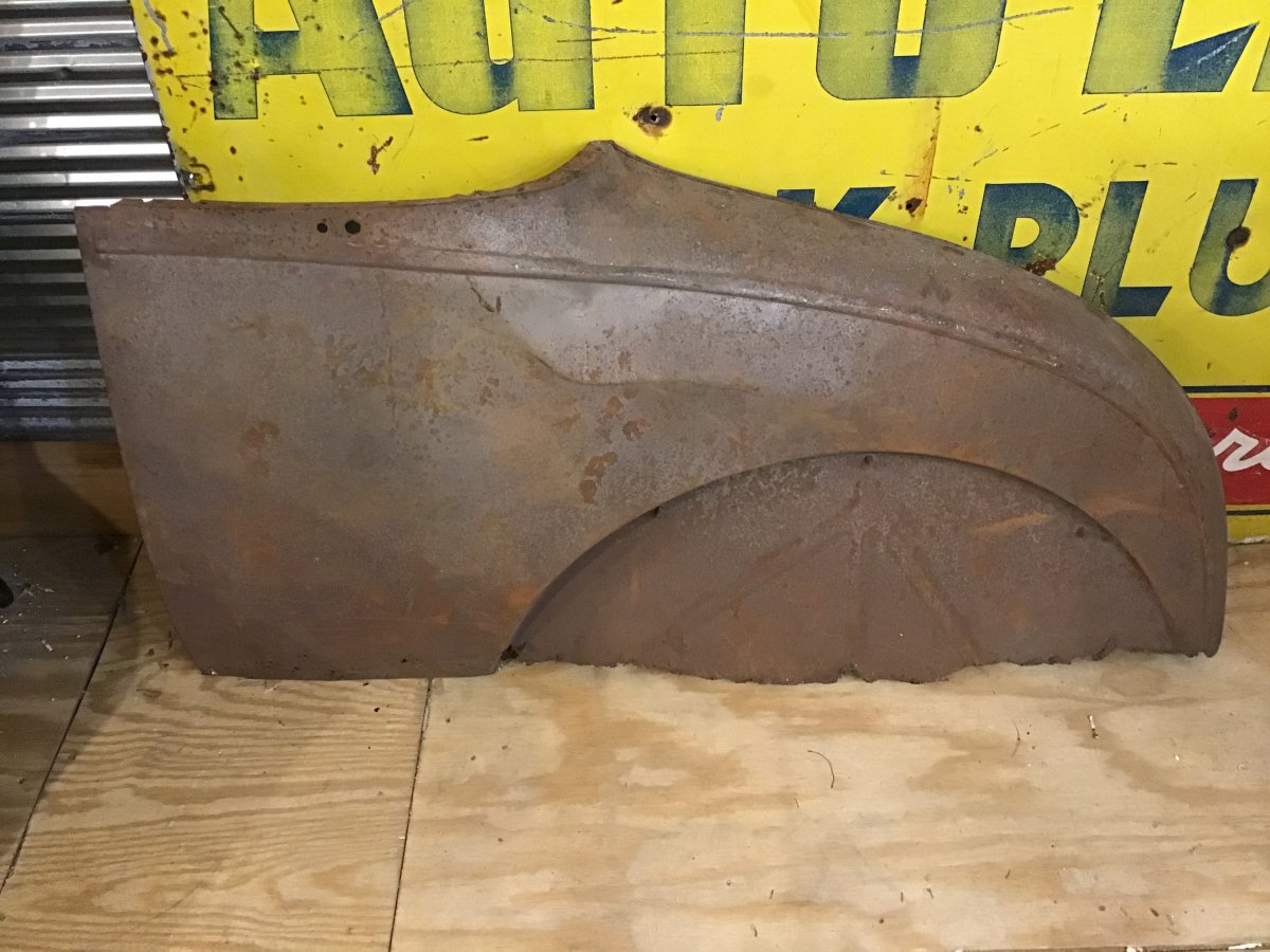

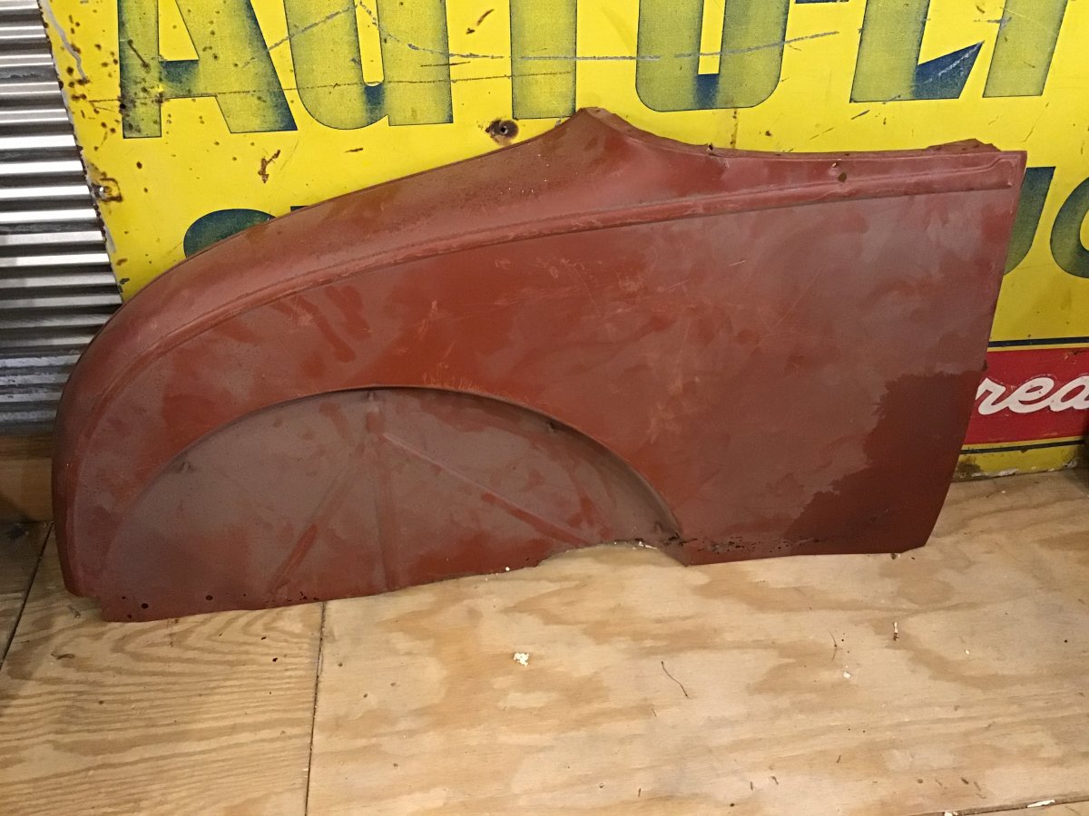

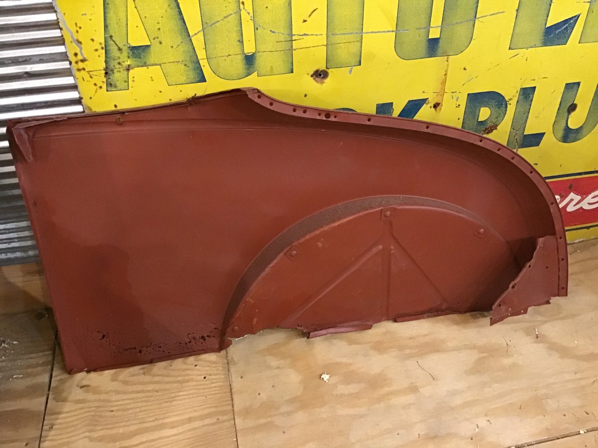

    I have a pair of coupe sports coupe quarters but not sure where the rusty Milky Way is:D.
    Have you thought about a pheaton tub and see bodies reasonable plus you can bring the kids with for ice cream...
