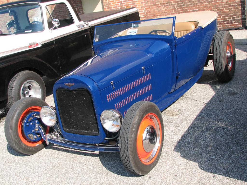

  5. I got no links but many a Tub has been built from a sedan. That is just a long roadster without a turtle deck. No doubt the sedan body could be shortened up to build a lakes style roadster from one, still without a turtle deck.
    I would do it if I was a roadster man.

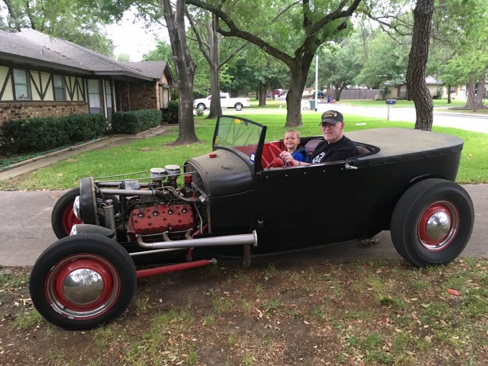

    from Denton

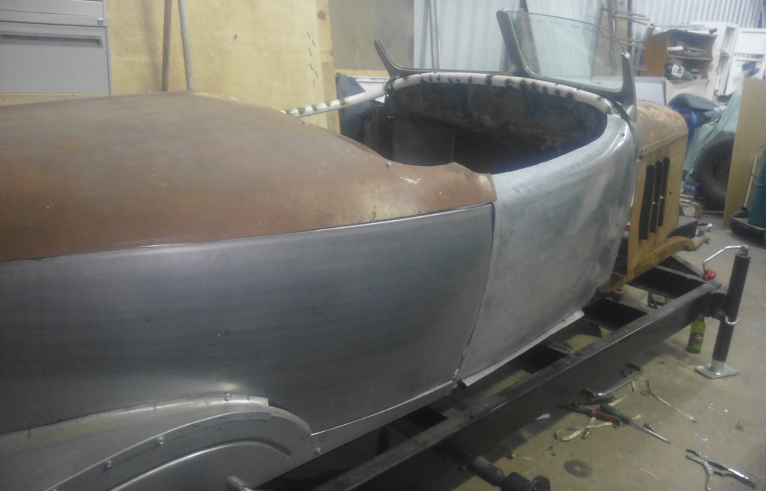

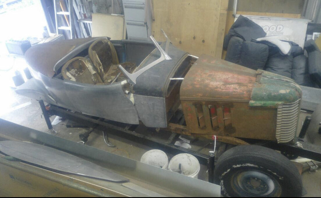

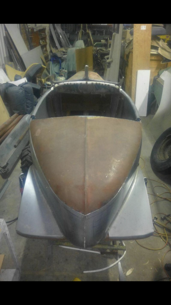

    I got the cowl for $100, the screen for $2 DF2D2319-071D-4F51-A666-C15F1509119A.png 72BED10F-68D6-4442-A119-AD04795E3CF3.jpeg 31FE3019-01E5-4C21-8696-03F4C6F1702C.jpeg 00 and the hood which became the boattail back for $50. Two sheets of 1.2 zincaneal for $120.
