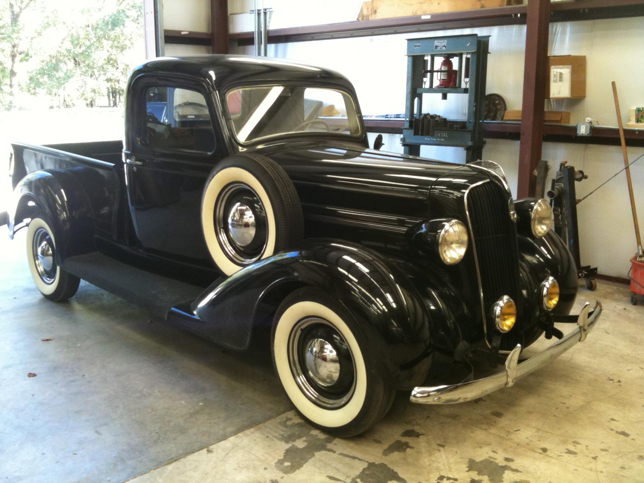

    It's time to make a decision on the '37 Plymouth PT50. It is 99% stock and original. It runs okay as long as you don't want to go faster than 50mph and stops okay as long as you can predict the future. Shifting is an adventure all it's own. Bottom line is I believe it is a hazard to me and others driving in all but a parade. I bought the truck to drive and enjoy, not look at in the garage or sit in front of in a lawn chair.
    I am ready to replace the suspension and drivetrain to modern standards, while leaving the exterior looking 100% stock. I will need to modify the firewall slightly to accommodate the engine, but will make it look like the factory did it. No smoothy nothing. Ribbed panels, etc... I will need to significantly modify the frame. Build a new one and preserve the original or modify the original? What is everyones opinion on this?
    Thanks, Craig

    It looks pretty damn good as is. But if it doesn't turn you on, you need to sell it or change it. Maybe a more modern motor and trans with an upgrade to the brakes and rear end, but keep the original vibe?

    update the mechanicals and suspension, leave the exterior as is. best of both worlds.

    I had a '41 Plymouth pickup that had a mildly warmed-over '59 Plymouth 230 flathead Six. I see what you mean, but I really had no problems at all driving it around town. The guy that bought it from me, drove it from OKC to Dallas at 55mph down the state highways with no issues. You might consider simply changing out the rear gears (likely 4.88s now, maybe 4.56 or 4.10) to a more highway-friendly 3.90 or 3.55 gears, to include swapping to a later rear axle altogether. Far as front brakes go, you'll have to research parts swaps if you want to retain the front axle.
    I'd really hate to cut that truck up solely to modernize it. It is your truck to do as you will, but I'd seriously consider selling it to find a truck that would be more to you upgrading/modernizing desires.

    I'm liking what I hear...modify the stock frame or build a new one?

    Don't cut it up too much. Try to find upgrades that will work with your frame. Don't put an IFS or anything under the front, just try and upgrade the stock axle. Rear axle swap shouldn't be too hard and engine and ****** are pretty easy. Try to bolt or better yet rivet in the crossmembers if you can to keep the original vibe.

    I had a similar dilema with my 35 Desoto years ago. Good motor not bad gearbox lousy steering and no highway mileage.
    I installed a 3.55 : 1 diff updated the steering box to a late model JApper and installed disc brakes on the front with a proportioning valve in conjunction with the later model diff. The car handled well - steered better and stopped very well. It would lick the pants off any stock 30's Ford V8 and cruise all day long at 60mph comfortably. This did not take away from its stock body or great running engine or gearbox. Most of this I did without taking the car off the road for any great lenght of time other than the disc brake conversion and that was only a long time cause of me.
    The diff change over was one weekend with the following week to mate up the drive shaft. The steering box was another weekend job with one extra day to finish off the droparm.
    Hey its your car and if you feel the need to radically change it go ahead however with some straight forward changes you can appreciate the best of both worlds
