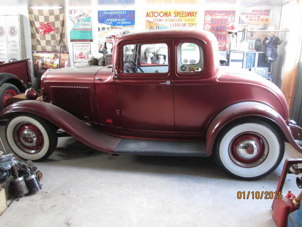

    Dupont had a product for years[tireblack rubber dressing] , I don't think its available anymore, but maybe you could find an old can on eBay. I've had a can for years and I have slimmed down widewhitewalls that were way to wide on 750/16 tires to match the smaller fronts. once on it never wears off. IMG_1290.JPG

    Great car, Tommy.

    Kan Kustom, are you sure they used Dupont tire dressing because I myself never had problems like you described and to feel it when its liquid it sure smells and looks like real rubber, Just wondering , thats all.
