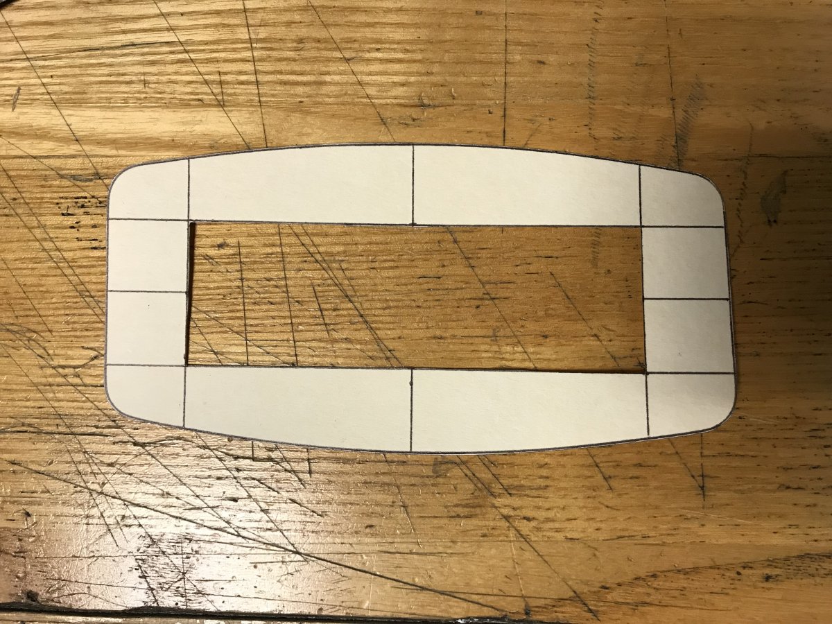

    I bought the same lights off eBay for my coupe, made up a template and used some 1/8” rubber from the hardware store. DC21B9CF-D373-4880-AA92-CB133093B694.jpeg

    They do need to be somewhat thick 1/8” - 3/16” for these particular lights to seal.

    51box. nice template. Want to mail me a copy of that?
