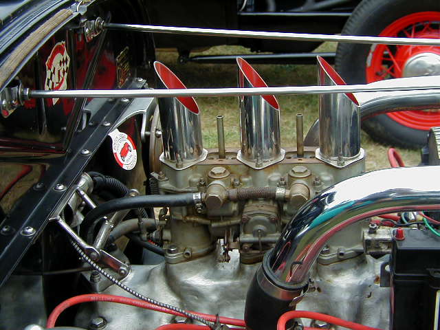

    Not on a small block, but this thing is really neat. It's a Webber 3-barrel adapted to a flathead. Pretty ingenious I think.
