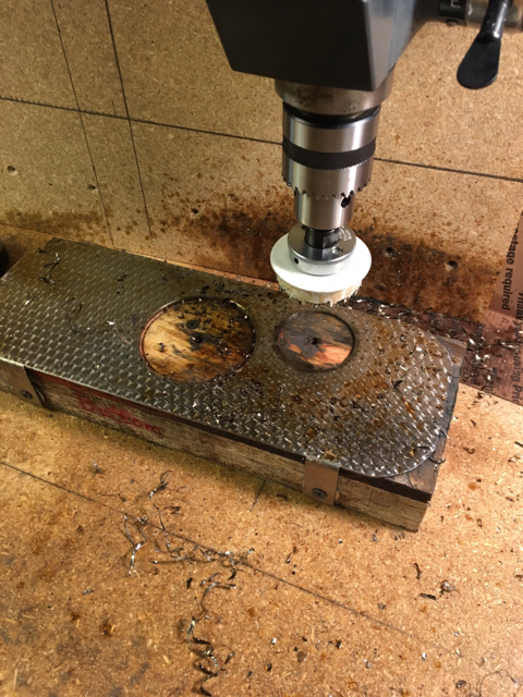

    Progress, finally. My 3” Lenox carbide hole saw arrived yesterday. Zoro has the best price on this, but glacially slow shipping.
    One 3” hole, four 2” holes. In less time than I spent not making a 3” hole with a bi-metal saw. If you’re going to do this, pony up the money for the carbide cutters, they’re well worth it.
    Still need to locate and drill the indicator lamp holes, and adjust these holes so that the gauges fit, but it’s getting there.

    So, it’s been a while since I worked on this. Today was a garage day.
    I started with the small gauge holes.
    The Lenox carbide cutter makes nice holes, but they’re slightly too small. Die grinder made the holes slightly bigger, until the gauges fit.

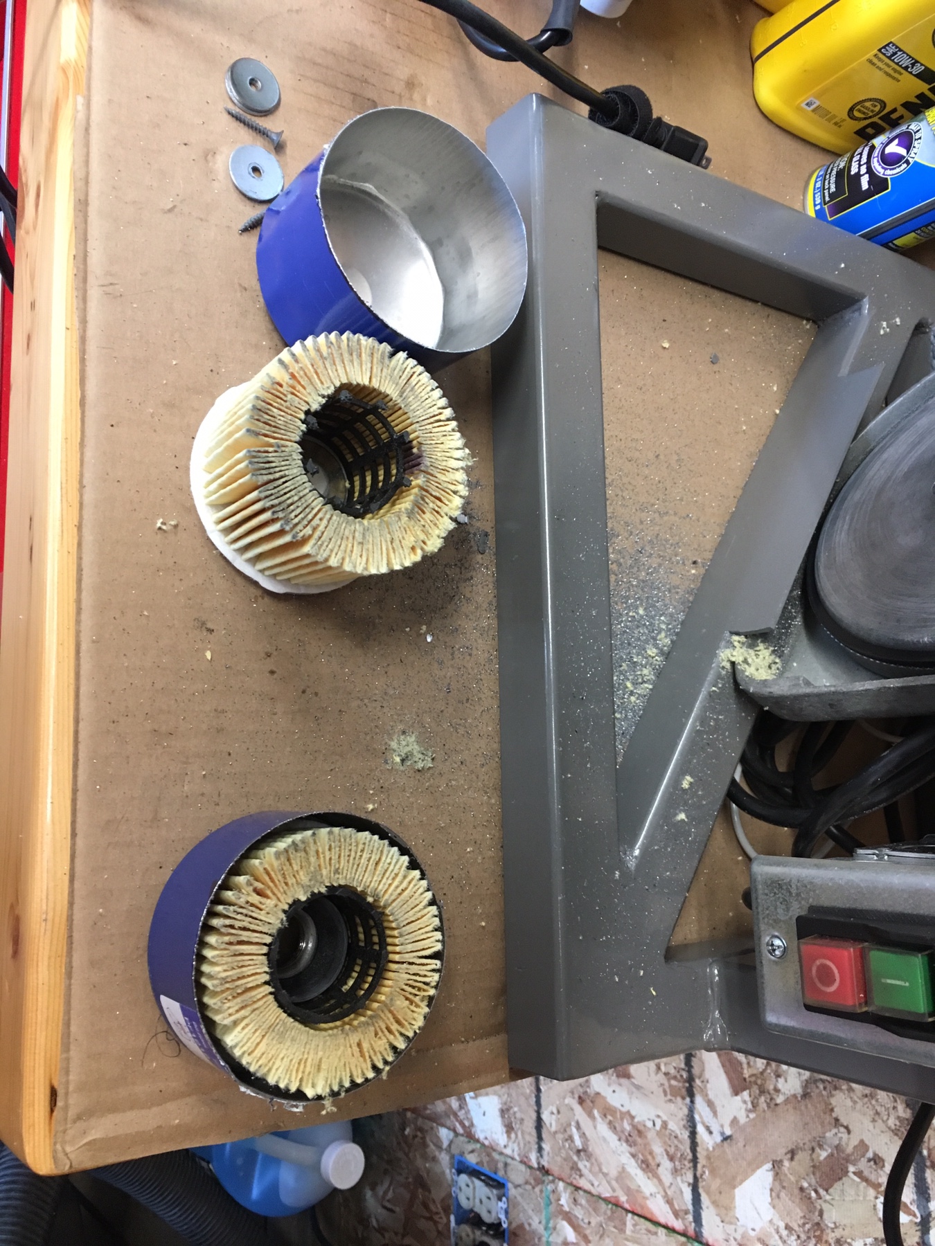

    Next challenge, mounting. The mounting hardware for the speedo is long gone, and VDO no longer sell or stock parts for this model. Previously I wandered around Farm & Fleet looking for ideas, and found that this oil filter is almost exactly the right diameter.
    I fed it to my bandsaw to reduce the height.
    Drilled some holes in the end, and added a nut from McMaster Caar (had to buy a 10-pack to get one, it’s a weird metric fine thread size...)
    And now it’s a mounting cup for a VDO speedometer.

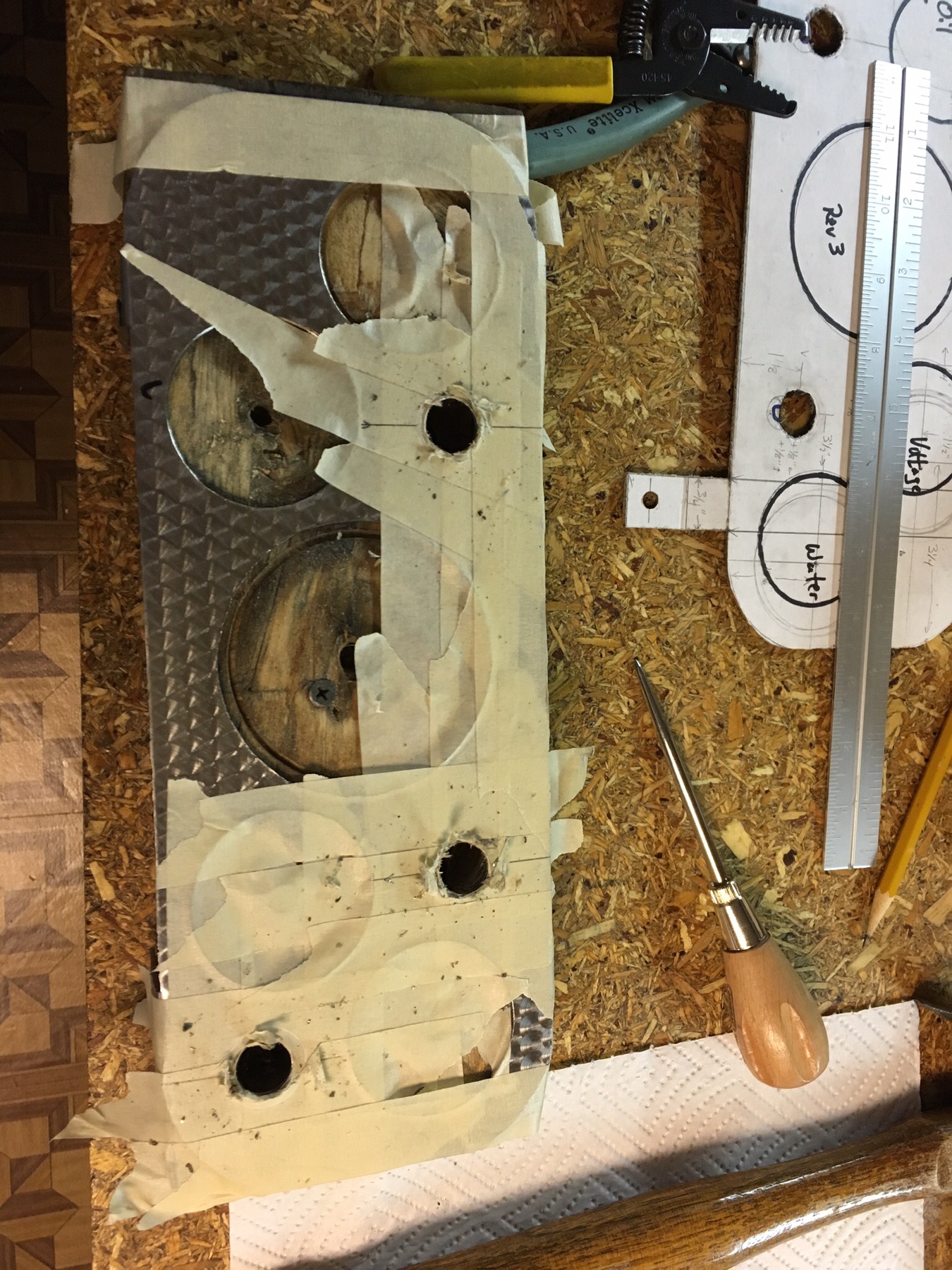

    One more mock-up
    to figure out where to put the indicator lamps. The upper right is blocked by the wheel, so I moved the high beam indicator to the upper left.
    Shadow Creek and mgtstumpy like this.
  9. David Gersic
    Joined: Feb 15, 2015
    Posts: 2,829
    David Gersic
    from DeKalb, IL
    Marked the hole locations to match the cardboard mock up
    and drilled
    I kinda like that pic, showing how far this has come from the rough cuts with my grinder, using this same piece of plywood.

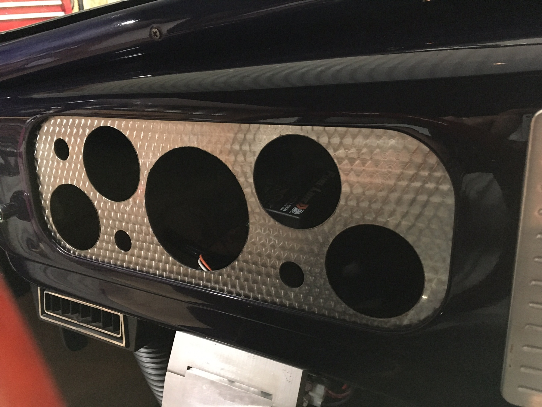

  12. David Gersic
    Posts: 2,829
    David Gersic
    from DeKalb, IL
    ***embly complete.
    Fortunately, VDO do still sell the mounting hardware for the small gauges.
    Tomorrow I’ll wire up a harness and I should be able to install the finished insert.
