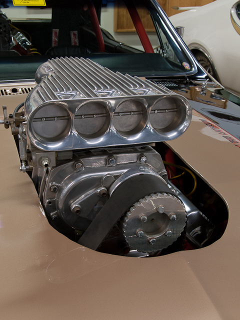

    I have a great big hole in my 'gl*** hood now that I'm not runnin my big carb setup anymore...need a blower to plug the hole :) Goal is to do something like the Hurst Hairy Olds,etc.
