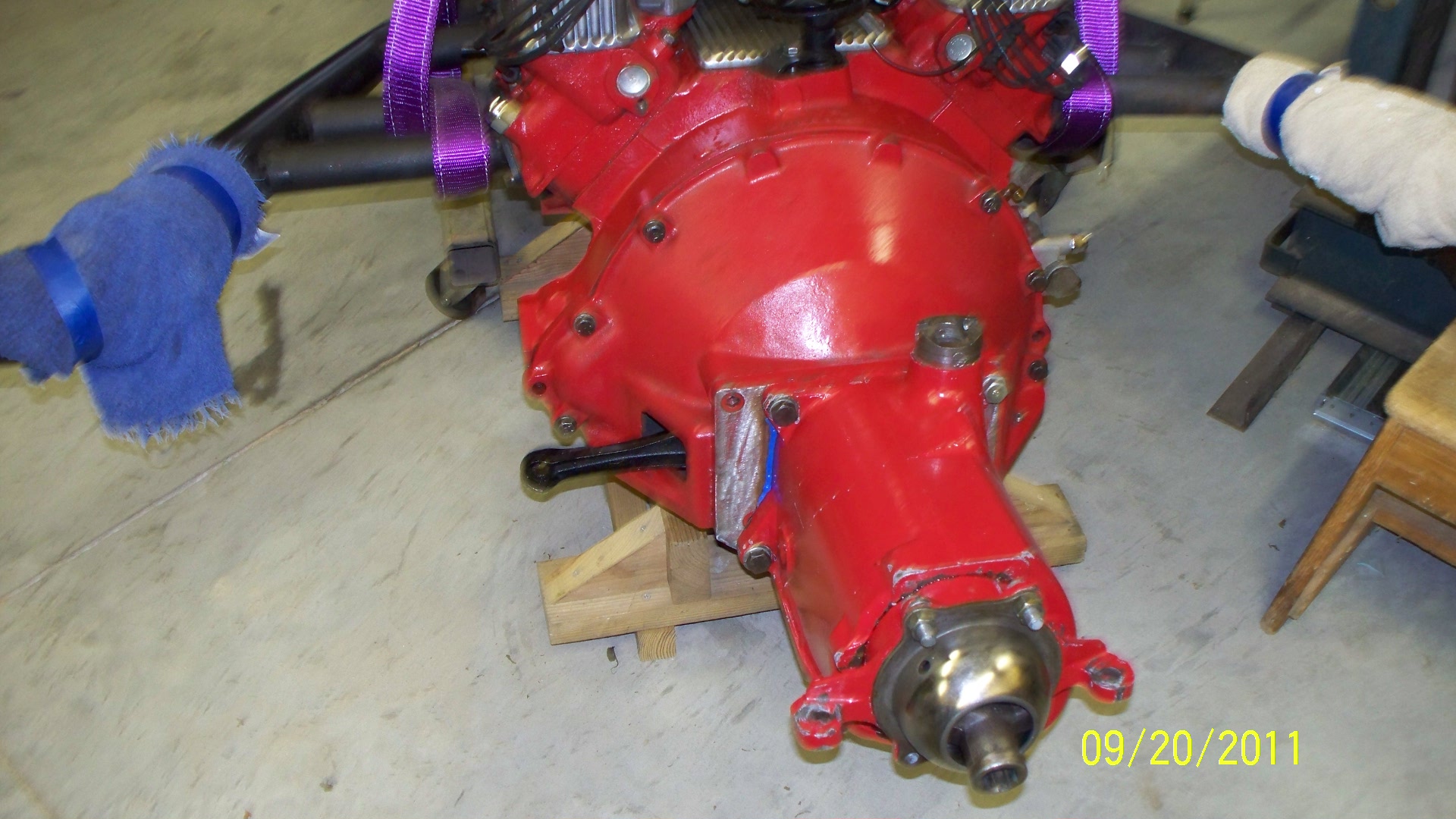

    In the picture above I have a couple concerns. It appears you have a bolt running through that square tube to secure your transmission. Does your tube that the bolt p***es through extend all the way through the tube? If not, you may want to consider it. Once you tighten down that bolt you'll have a tendency to crush the tube. You know the rest from there. Just checking.
    Second concern... I see what appears to be an early Ford transmission behind a Hemi with a 6x2. If you're intending on doing what I think you're intending to do, you may want to consider another transmission option... ;):D

    I'm definitely going to agree with Scott on the transmission. That Hemi will shell the teeth off the Ford transmission instantly... They are marginal behind a souped up Flathead.
    The other issue that seems to be a concern, is not. Welded pitman arms have been used forever. It's a forged steel piece. With the correct bevel and weld penetration, it's as strong as new.

    scootermcrad- Concerning the trans. brace, The round stock does go throughout, there is also a small amount sticking past for the head of the bolt to rest upon. This would be the only way to put torque on the bolt with out crushing the square stock, like you stated. I should have put up some build pics of this piece ( as well as others).
    Now, with the early Ford trans., which was also a concern of OoltewahSpeedShop, It prob wont last, I am anticipating this, but I am sticking to a theme and time period, and doing some research this is all you see that was being done, pre-1960. So that is the reasoning behind that, and it will stay as that pairing till i get sick of replacing 'em! hahaha

    I'd be looking for a '37 LaSalle transmission to go behind the Hemi. That's what I have in my roadster and it's plenty strong. Mine even has the Ford tail section, so you could keep your crossmember.

    I was thinking the same thing. That Hemi needs something sturdier and a LaSalle transmission would do it and still be period correct for 1960.
    I've decided that if I break too many early Ford transmission cases then I'm jumping on the LaSalle bandwagon.

    OoltewahSpeedShop- I like that! I am agreeing with Tex***peed on this one. I will keep the 3 speed fords till i get sick of replacing them and can afford a LaSalle Swap. It will match way better too, since this is a "LaSalle Roadster"!

    Another idea for the nuts on the ****** mount would be to weld them to a kind of C shaped brace between the two nuts going over the trans, that would stop them vibrating loose and make them easier to position once the floors back in if you do end up needing to pull the trans too.
