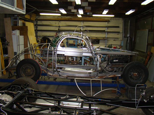

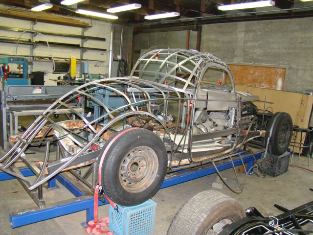

    Wow! That looks intense! What exactly is going on there? are you making a skeleton/substructure to then form the sheet metal around? or is it going to act more like a roll cage? I take it this is a one off 3w design, or are you basing it around a certain year, cause to me it reflects 35-36 Ford. I like it! I'm intrigued.
    I'll keep the pics coming, but I'm not sure if it'll do justice to keep your mind off your project!

    It is a scratch built design I drew up and am now starting the skeleton frame work. I still have a good amount of tweaking to do before I am happy with the design then I will build the drivers side of the skeleton. After that I will use it for panel patterns and fit during wheeling and forming. Once it is all done I will pull the panels off and weld it up on a different ch***is and that will leave me with patterns and the skeleton for the next project.
    It is avery loose 36 impression with some Zephyr as well. For the most part it will have a radicle 36 silhouette but be 100% different in the panels, details and fluid lines I plan on ending up with.
