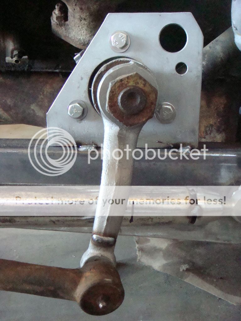

    Decided to build a trans. bar, that would be hard bolted, and than have the mounts be closer to the side rails. This is what i came up with. Should work.
    Next on the list was the steering. O, the steering. This has taken a lot longer than expected. My dad and I found a F1 box at a local junkyard out of a 51 f1 delivery. I removed the flange and will be welding on a new one closer to the box, which then will be bolted to the flange that is welded to the ch***is. My dad re-bent the pitman arm to flow nicely around the radius rods. The linkage I will be using is out of the donor '46 merc. My dad suggested to get away from the ball-and-socket, that the f1 uses. The merc pitman arm end is tacked on for the time being and will later be tig'd. We couldn't of used the entire merc pitman arm because the tappered holes were going the wrong way and would of had to been cut and welded anyway. We will also be using the rest of the merc linkage to tie into the steering arm. Here are a couple pics.

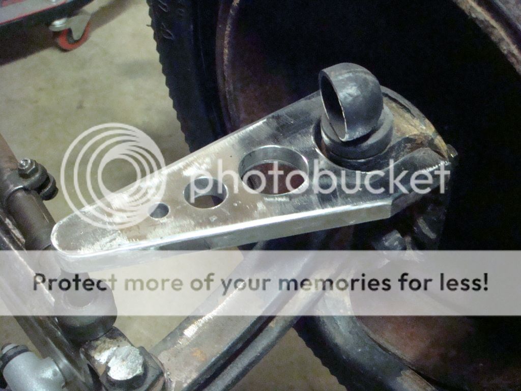

    This is what I have decided to do for a steering arm. I was thinking of going may different ways with this. First was to use 5/8" rod, bend it around an original tie-rod end bung, thread the ends, and nut it on the inside of the hub.
    Scratched that idea.
    Next was to use 1/2"plate, weld on ears to mount it to the hub, and blow a few holes through the plate, and drill a tapered hole to accept the tie-rod end.
    Decided against that also.
    I decided to go with 5/8" plate, drill and tap the ends to bolt through the hub to attach it, blow a few lightening holes, and drill a tapered hole at the end. We got the shape from hours of turning the steering wheel from lock to lock and trying to figure out the positioning to get the wheel stops to hit before the box bottoms out, and be the same amount of turns in each direction. It was starting to make my brain hurt. If there is a mathematical equation to this please tell. For now, its there because it works!
    I will be finishing up the steering arm tomorrow. I will get some more pictures up when everything is tied up.

    Now to drill the tapered hole, straighten out the drag link, and the steering should be complete and on to the pedal ***embly.
