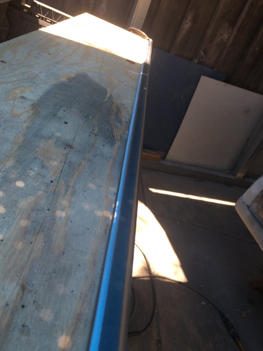

    I had a similar problem with my special coupe. The person who upholstered it also used to redo vinyl tops back in the day. Essentially she molded aluminum vinyl roof trim to fit. Behind the trim are some plastic snap receivers nailed to the old wooden frame under the metal roof panels. 84278BE5-7412-48B8-A3D6-0070F8D141D0.jpeg
    As noted above, it could be possible to bump/bend some trim as I have had done for me with some stainless for another purpose. These strips are 5/8” wide. I was able to bend this stuff laterally (carefully) and would think bending the other way would be easier.
    hfh, gnichols, irishsteve and 4 others like this.

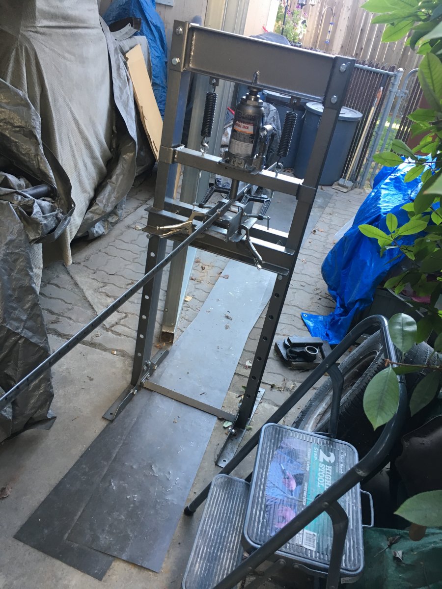

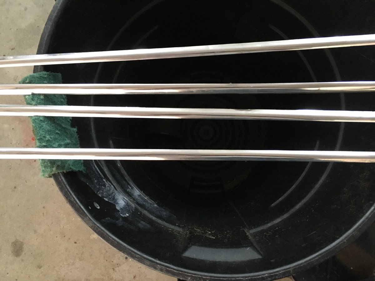

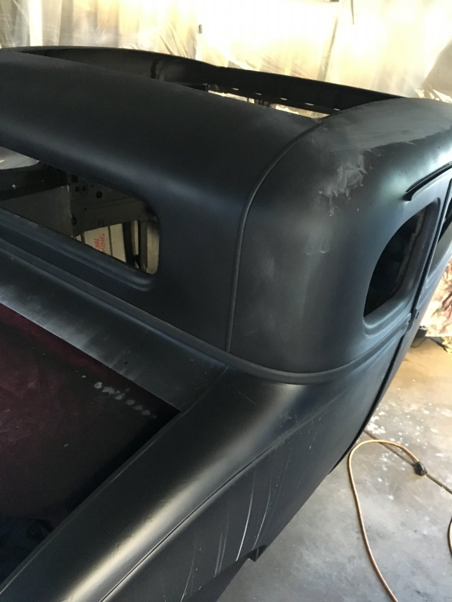

  24. Wanted to go an update since this issue don’t seem to be talked about too much on here. I looked forever and didn’t find hardly anyone that’s had to do this (yes a few have) but hoping this may help some one
    I got some 3/17 x1 flat bar, grinded the edges down to make a radius. Made a jig to put bends into the flat bar, then bent it around the car. I made a template but that didn’t work out so well so I just went for it.
    Used some small bolts,grinded the heads off, did some halfway drilling into the bar and welded the studs in. NOTE: before I did that I clamped the bar around the car and drilled the car from the inside out and that put a small mark on the bar so I’d know where to put the studs. I’m not completely finished but it is turning out decent.

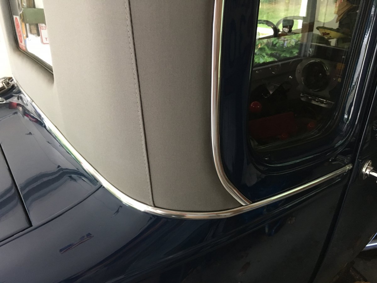

  29. Wanted to make an update of how the belt line turned out,also made the trim that goes up the roof. My model A ‘special’ now looks like a coupe

    Wow that looks clean. I like this idea as I have to do the same thing on my coupe.
