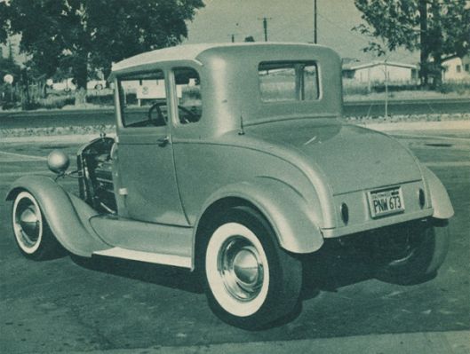

    I've had this picture for a while, and I never noticed that it is a converted Special Coupe from the 1950s-1960s. What gives it away is the belt line below the rear window that goes no where.

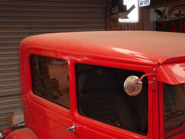

    This one is mine. Got a little bit to go. ;)
  17. yeah probably because that bend around the corners bends down and around. it was a bit of a chore for me to get both those bends in a solid piece, of you cut it a bunch of times it may be easier but then all the grinding And trying to get it to look smooth seems not so fun
