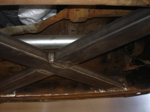

    I chopped the top off my 51 Plymouth. I built and "X" in my frame kind of like a convertible...Alot more work to do still, but I'm on my way!
