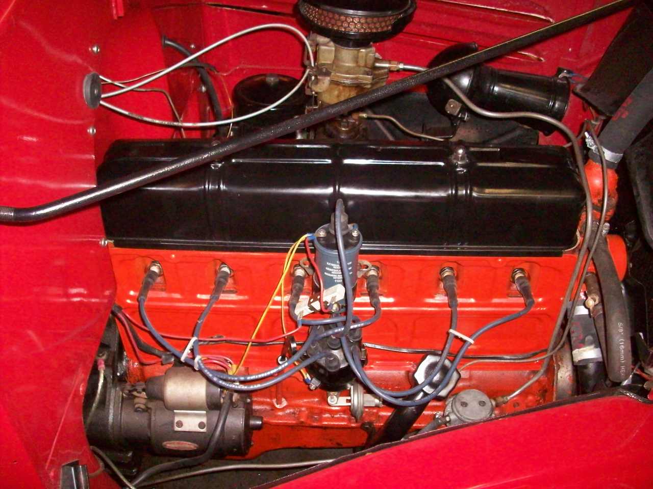

    Its going in this and if the new 235 is no good it might be time for a good Ford motor or one of the better GM motors like a Olds rocket,I would send it to the crusher before installing a sbc.

    I spent too much time and effort making the existing 235 look like a 216 so I really cant turn back and install a V8 so I hope the new 235 is good,if it eventually gets a V8 I want one to look like it was transplanted back in the early 50s. The existing 235 was rebuilt but has developed a couple noises that will require a tear down,I think I can keep it going until the new 235 is ready to go in.
