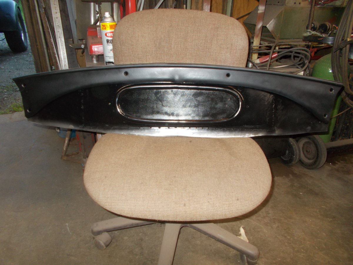

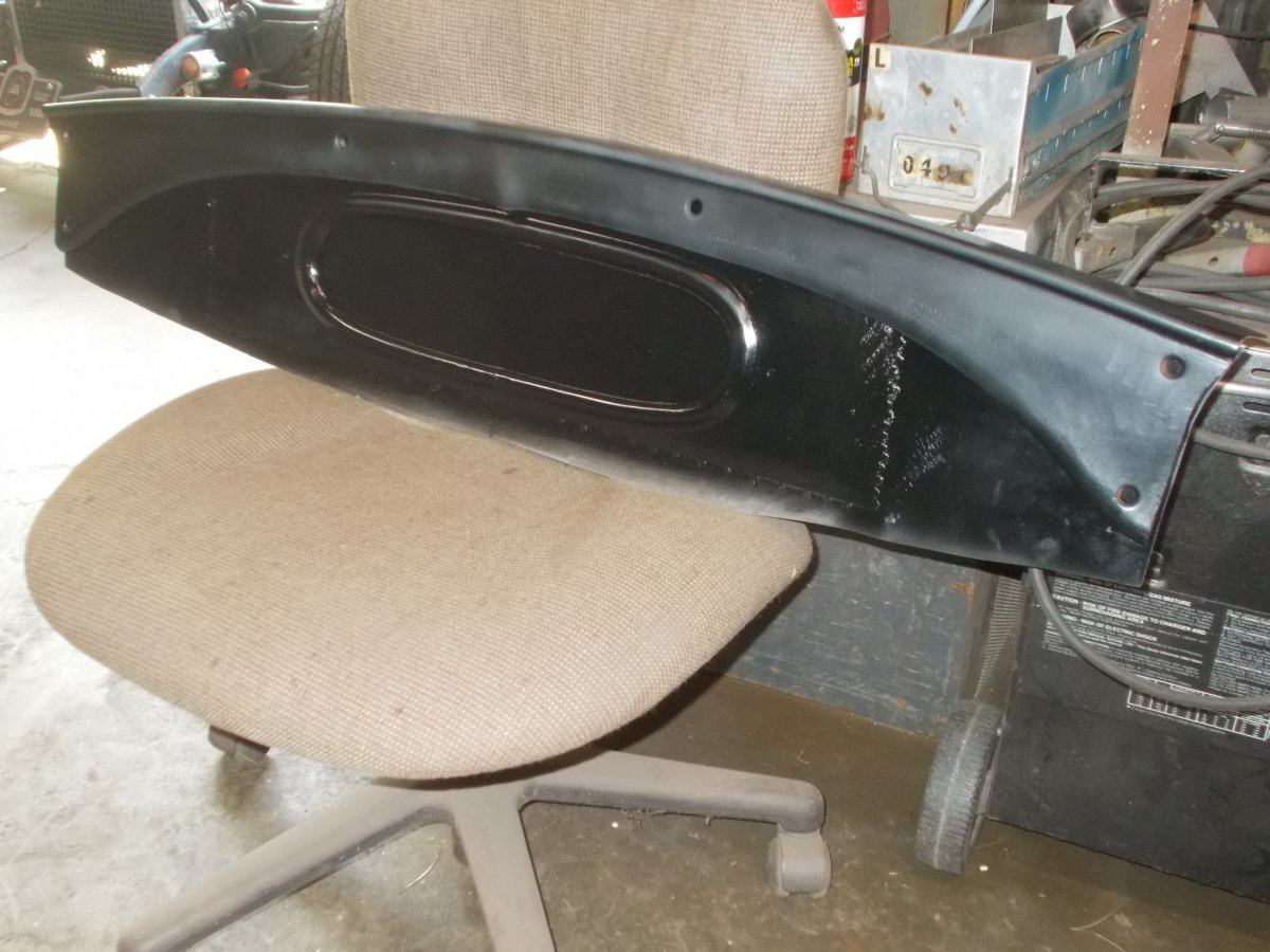

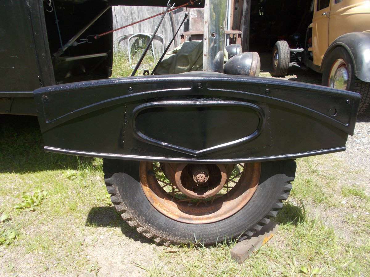

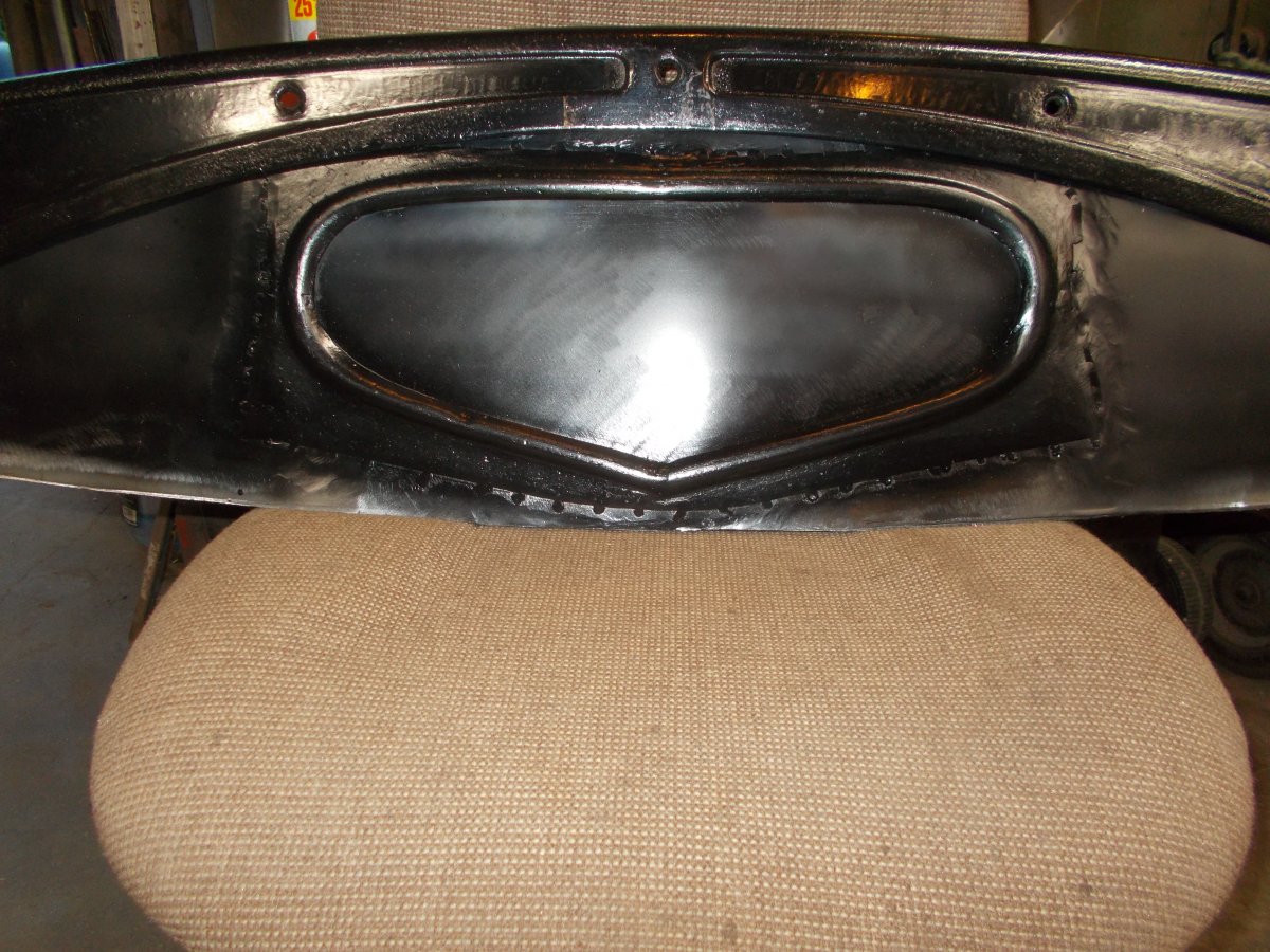

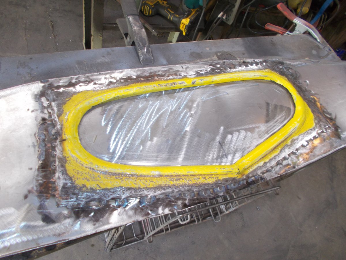

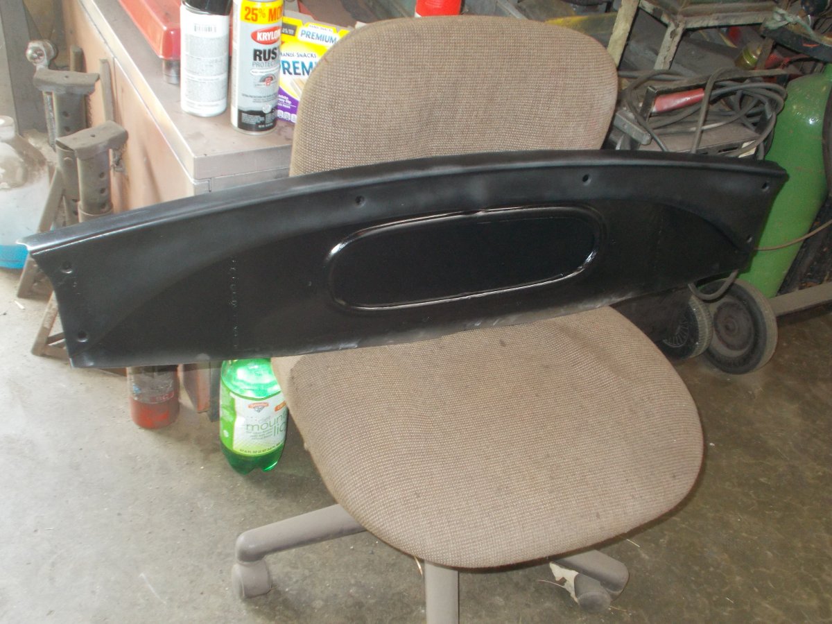

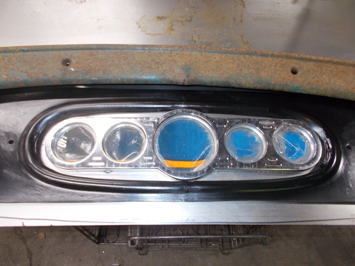

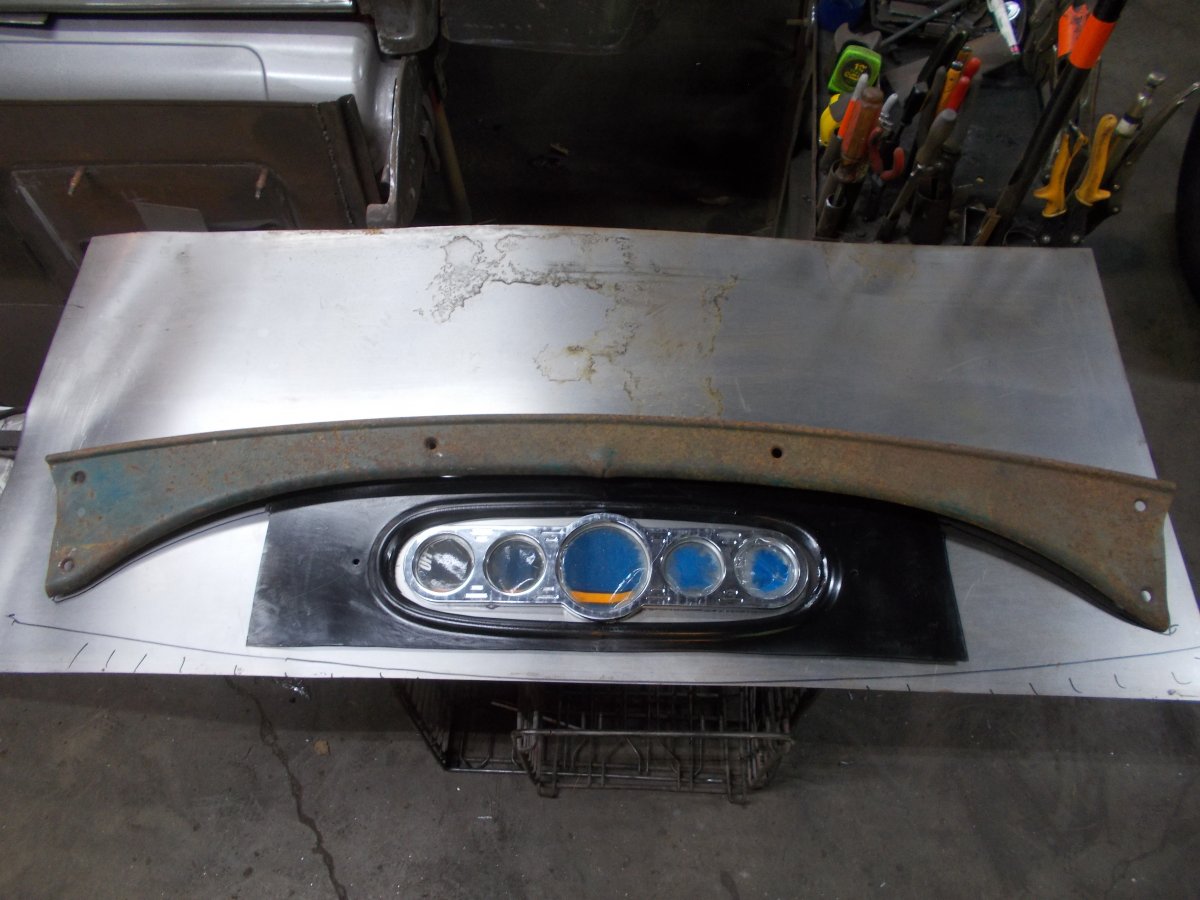

    I took the '28 closed car dashrail in trade... would work with either model A or other make dashrails...
    the radiused insert halves were '46-'47 truck hood side opening reveals … used about 8" from each side... ****ed them together...
    $47.00 aluminum gauge cluster = hot rod dash...
    ship luck, the vacuum packing stayed sealed on the polished surface... protection from me.
    View attachment 4701580 View attachment 4701581 View attachment 4701582 View attachment 4701586 DSCN6458.JPG DSCN6461.JPG
    with lower conduit added.

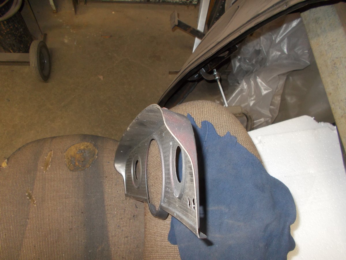

  5. sloppy jalopies
    Joined: Jun 29, 2015
    Posts: 5,256
    sloppy jalopies
    thanks boys,
    An atta boy now and then... Rocks the Casbar !...

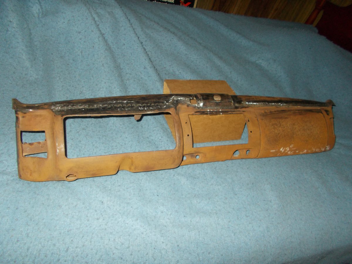

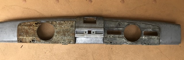

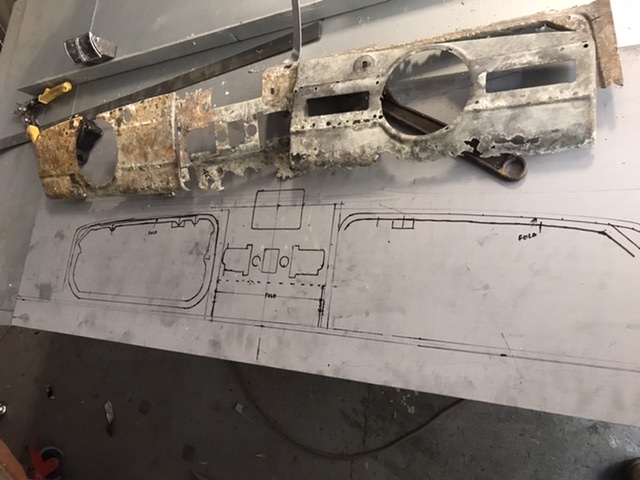

    I have a '41 to '47 truck dash...they must be cut out of the cowl...
    will graft the top half of a '35 car to it...
    I like them as the cluster and glove box holes are the same size...
    once you set up the stock cluster with a glovebox door insert you could use multiple layouts of "gauge, speedo, gauge" combos on other glovebox doors, as well as the std and dlx '40 units...
    swap them when wanted...
    '40 truck has a raised [embossed] rectangle with '40 car chrome style script in the center...
    '41 to '47 have a smooth center having an inch thick rectangular, chromed, ford script, die-cast block screwed on...

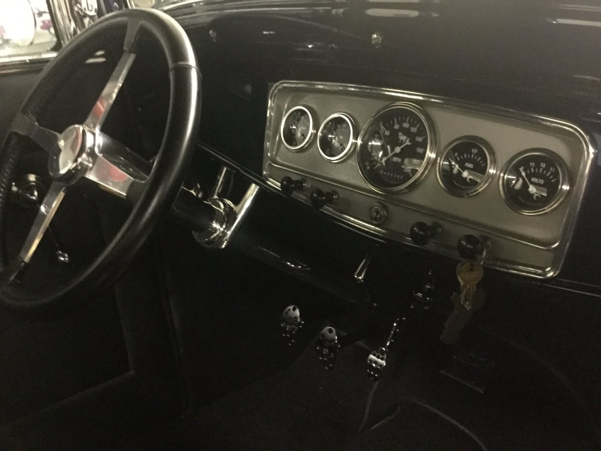

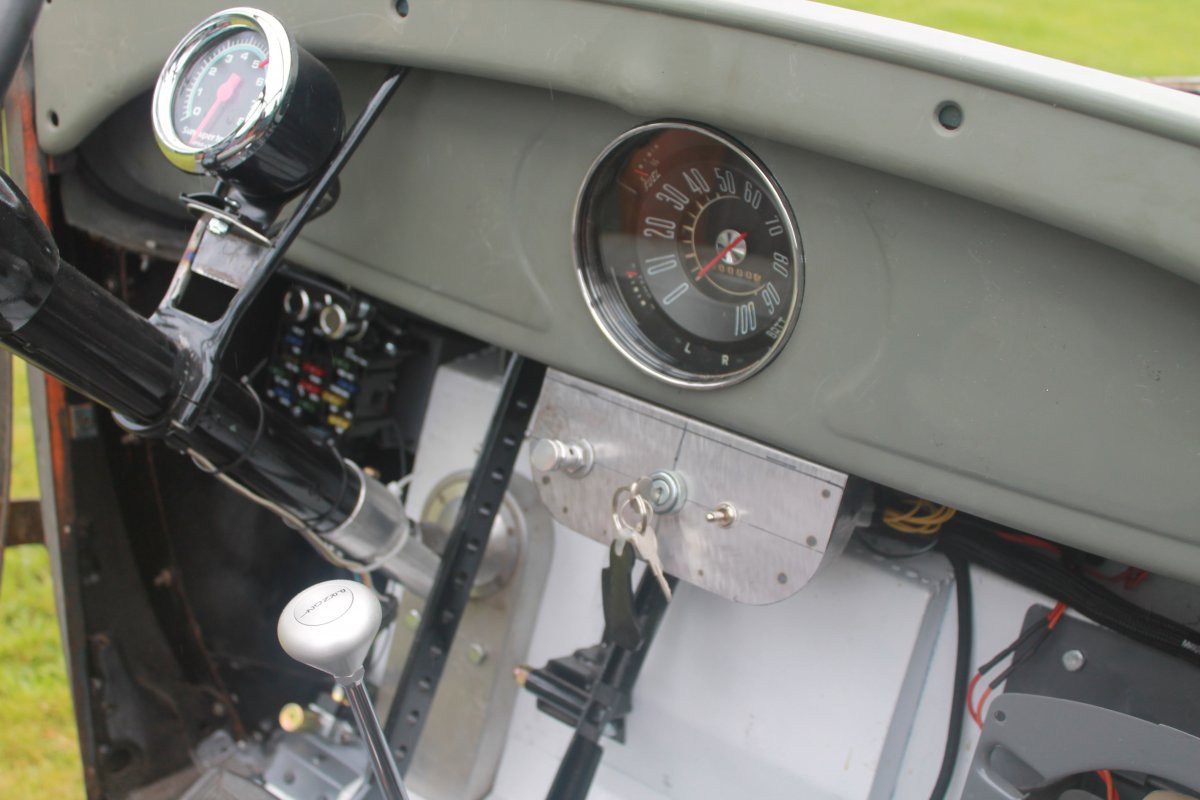

    Here is the one I did for my 31 A.

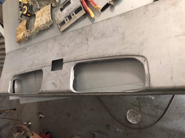

  10. CadMad
    Joined: Oct 20, 2012
    Posts: 886
    CadMad
    A4782E7F-7844-459F-BD52-4B05B2EEF6D5.jpeg F608CDA2-2026-4154-81C8-BED0D933C174.jpeg D4E58051-6A35-4CA4-B404-7859E6B5C2E2.jpeg 254E1588-2A44-459A-96CE-3F6372C24EE6.jpeg 8FA57B8E-481D-405F-B51D-57B97F0F4F4F.jpeg E3B3778B-8CE2-489C-BD15-360135CE9886.jpeg

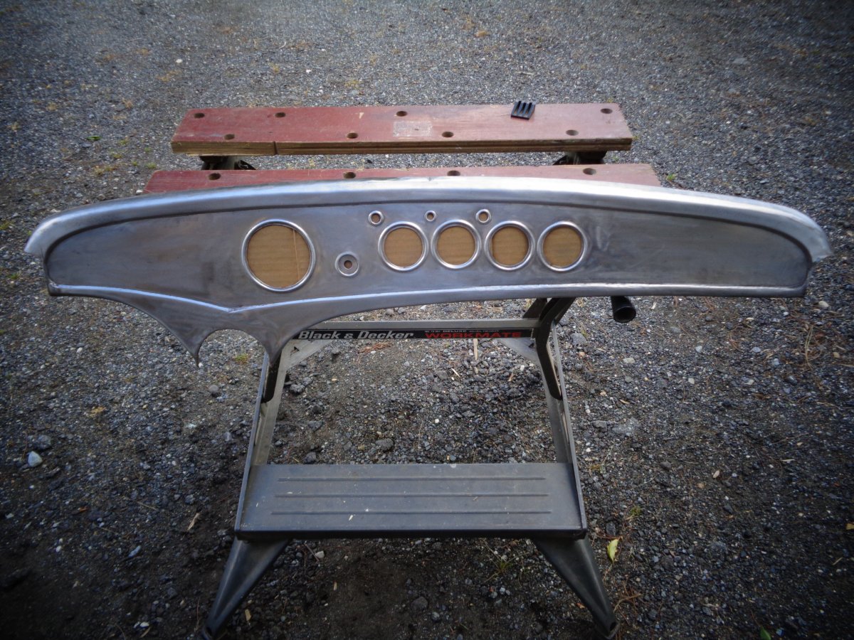

    47 shortened and grafted to a section of 31 dash rail , glove box lid has been tweeked to fit better than it does in the pics copper trim is just a filler piece with a couple of studs soldered to the back side and secured to the dash.. plan is to fit the chrome strip on top of this piece .. maybee

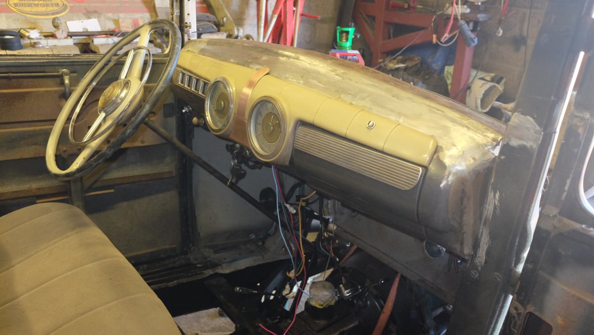

    My '39 Deluxe coupe, I continued on where the previous owner had started..filling some holes adding an additional chrome strip on the bottom, then painted and added SW gauges.

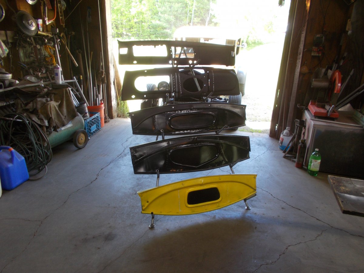

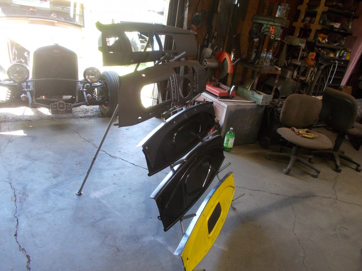

    If we ever have safe swap-meets around here I will be ready to plant my flag... and my lawnchair..
    1/2" conduit... [2] 5' legs and [1] 4'6" back leg... [10] 5"ish pegs... foot pads... chain "stops"...
    holds [5] dashes that fit in Model As...
    the legs are 5' because that will fit inside my closed trunk...
    you could bend up [5] various length x 6"deep and 3" tall L bends to use as shelves... wire ties fit where you would slide them over the pegs so they don't tip...

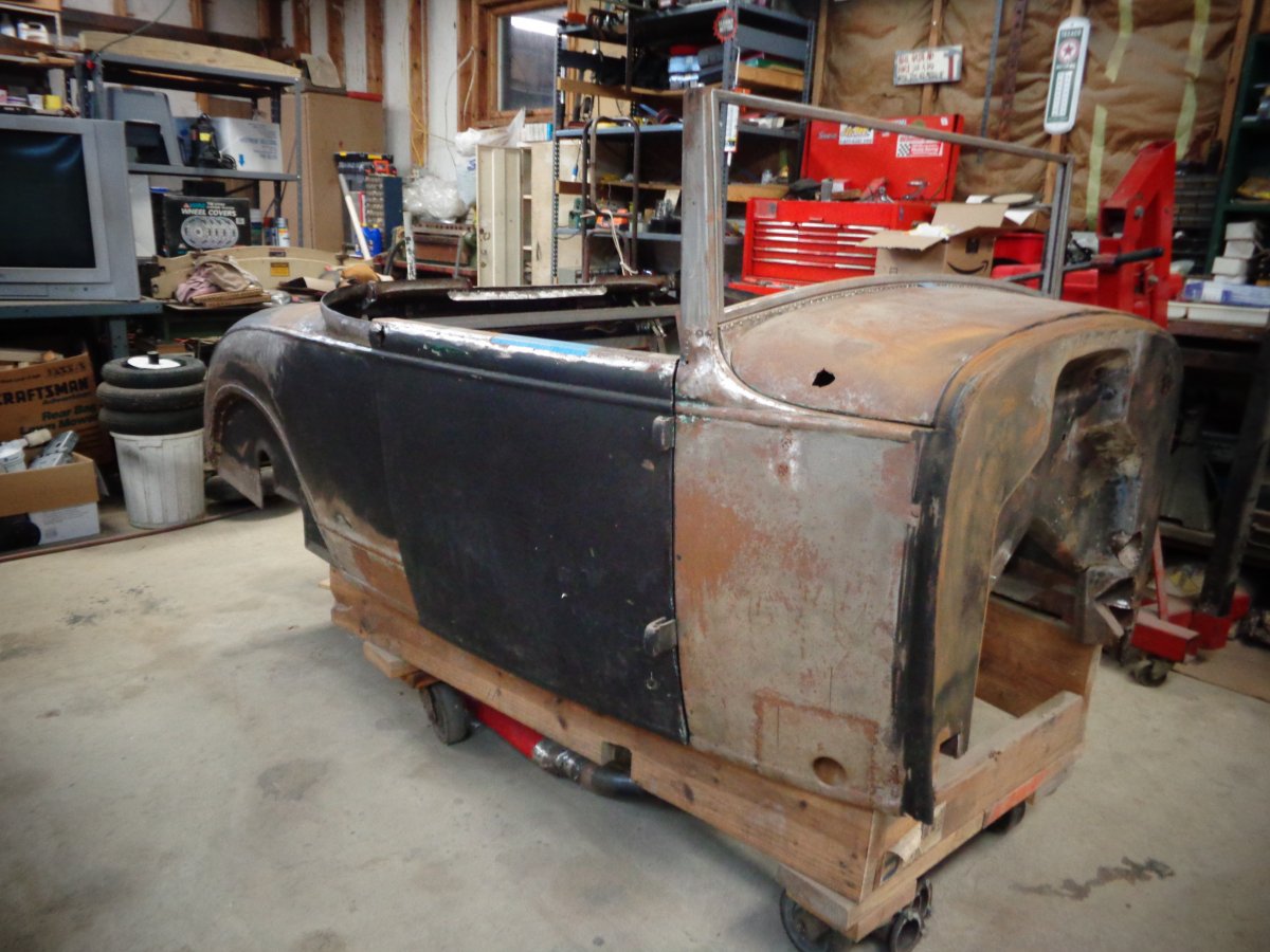

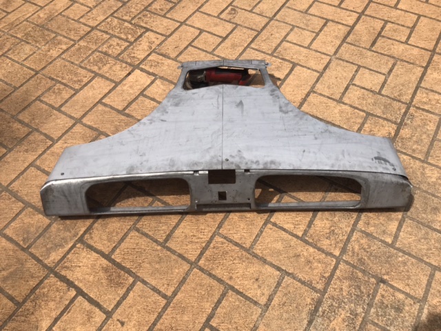

    Thanks Sloppy Jalopies. I enjoy watching you make viable bodies by s***ching left overs and junk together. One of the revelations of adulthood was that you could buy material to fit a project rather than fit the project to the material at hand. Even now, I am still more likely to see what I have and figure out how to make it work than go buy exactly what I need. Here's a couple of pictures of the body. It was a coupe with no firewall, deck lid, inner fender panels or sub-rails. Then I cut the roof off before I learned about bracing. You should try squaring something up before you discover that someone has patch paneled the right quarter 5/8" shorter than the left.

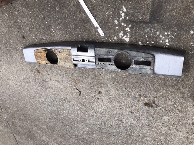

    Just picked up a '63-ish pick up dash insert... big hole, gauges around the speedometer... clock and tack hole... ribbed face... but 3 dimentional…? DSCN6516.JPG DSCN6517.JPG
