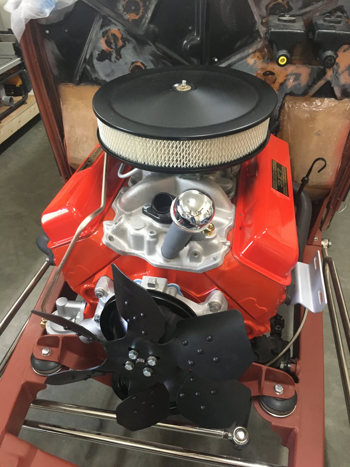

    4462764-e4efcc3cc0e2fb6732907205c0f83516.jpg 3AFBCE21-7792-48FE-9769-8F79C1BEF840.jpeg I went that route with the 350 crate motor my wife got me for Xmas a few years ago. Grinder, high temp epoxy and a few hours change the look. Also was lucky enough to find a mint set of 62 Corvette valve covers on Craigslist.
    rod1, Tickety Boo, v8flat44 and 6 others like this.

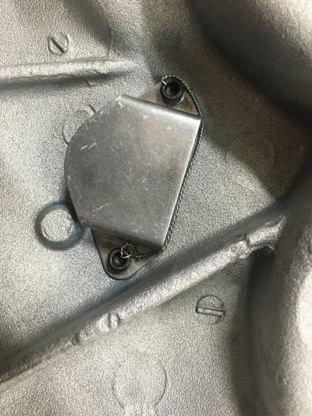

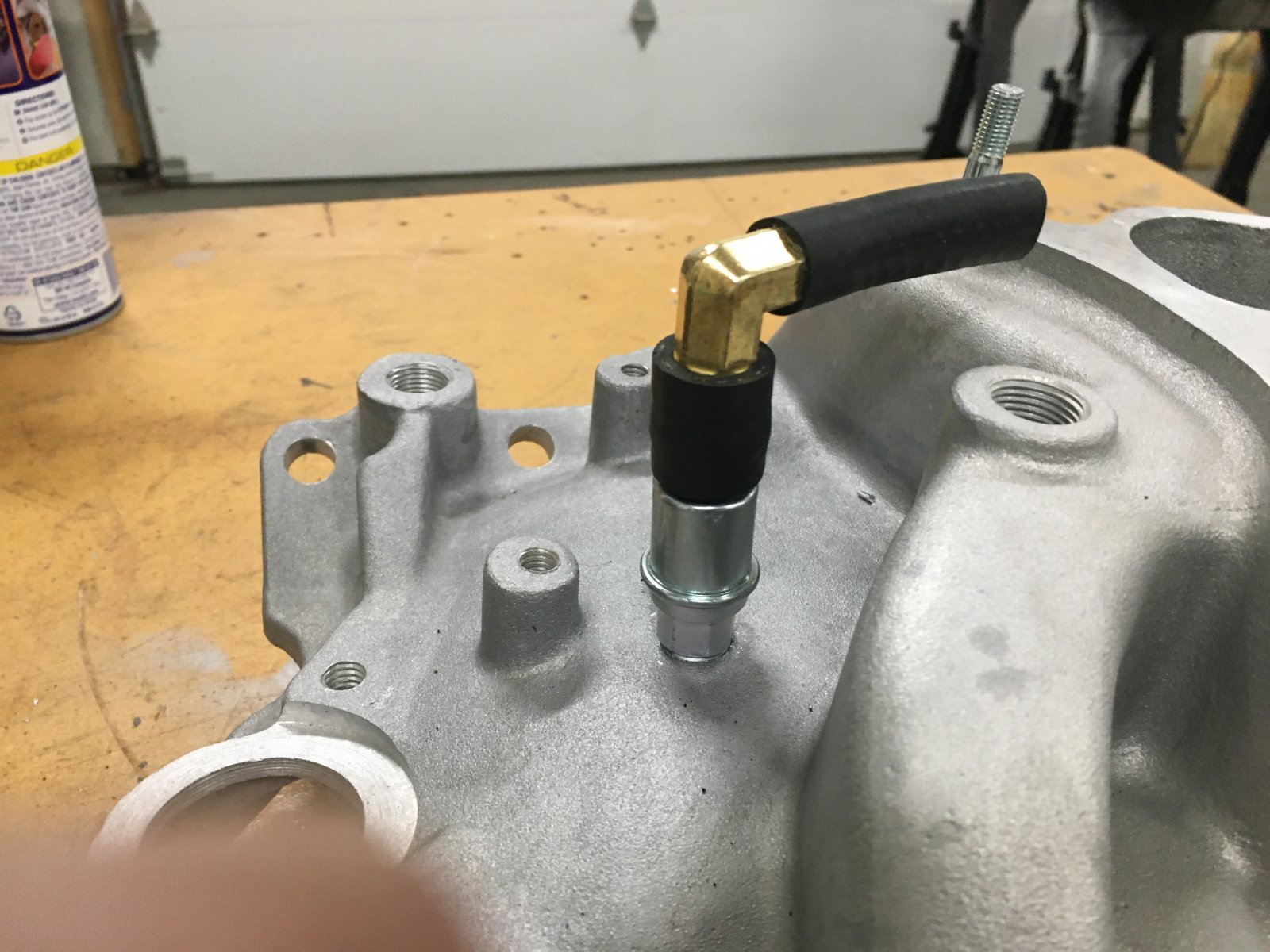

    52D716B9-D524-4C70-9475-4E11DF68E972.jpeg 4187F53F-546D-427C-BB50-BE777B694DE1.jpeg
    Right you are! Got creative. Pcv valve tapped into intake with baffle to keep oil out plus a lifter valley windage tray. Hose connects to vacuum port on carb base.
    Seems to work so far. The first time out on the road with determine it's ability.
