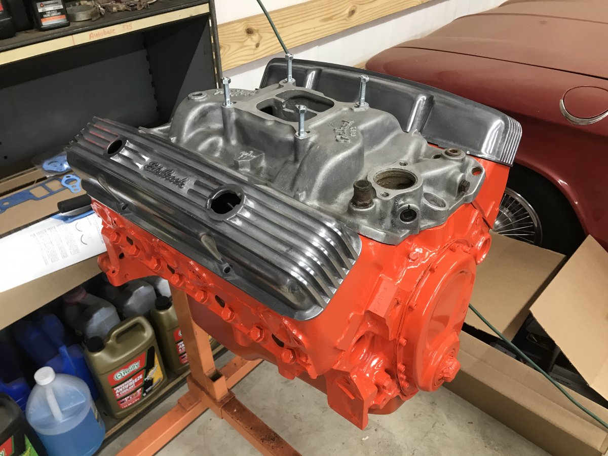

    There are script valve covers that are not the staggered bolt pattern. My 65 El Camino has them. Edelbrock makes a 4 barrel intake with a knock out to install an oil fill tube.
    I have seen posts here by others on how to vent the crankcase and not cut up the valve covers. You may find those if you try a search for it.
    Good luck. I saw your previous thread about replacing the 383. I think this path is better in the long run.

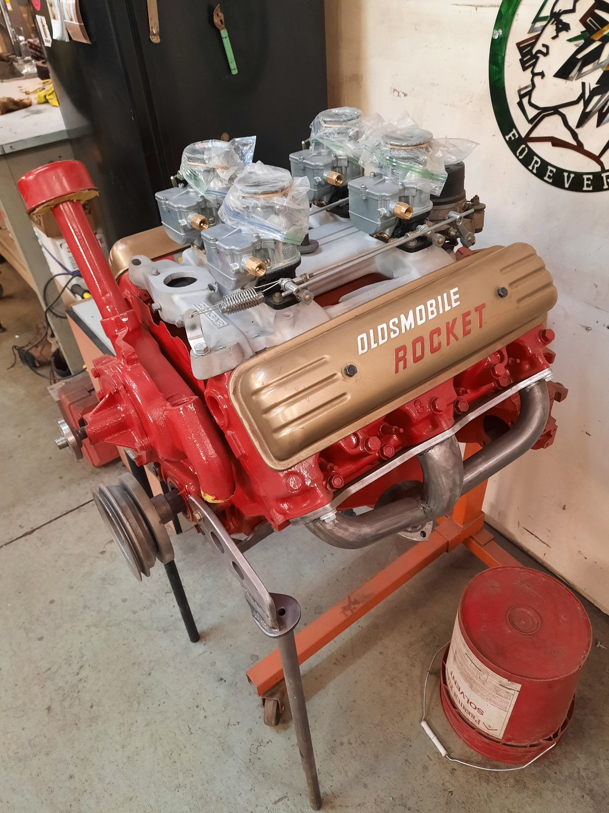

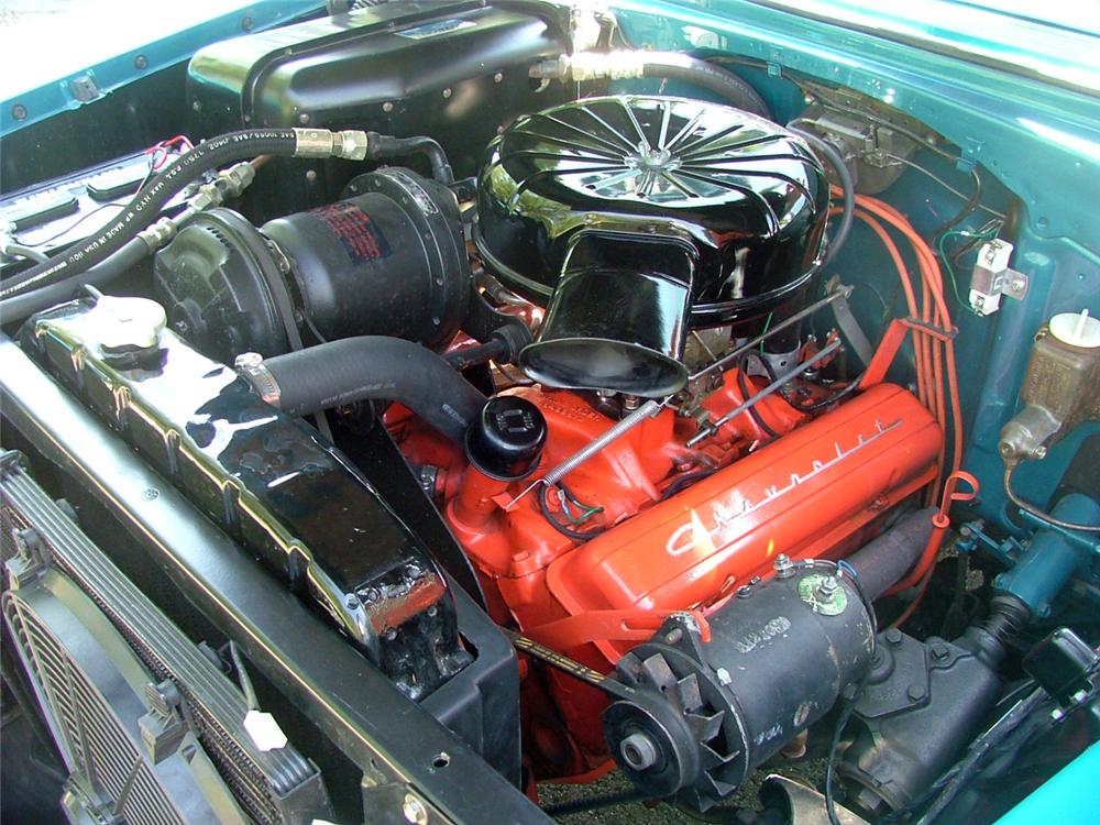

  11. DDDenny
    Posts: 23,429
    I took the easy way out and used vintage NOS parts, not the cheapest, or the more common "whatever is laying around" approach, though it did not happen overnight either.
    The key parts as people have pointed out are the intake manifold, carburetor, valve covers and oil fill (intake) to start, air cleaner choice too, kind of depends on what you mean by "vintage", as there are more than a couple eras to consider, ***uming you want to follow HAMB law.
    It's also the peripheral bits that can send this plan sideways, things like PC valves, fittings, hoses, clamps, etc.
    My example.

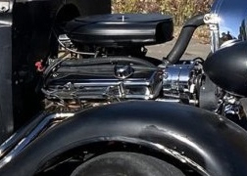

    Perfect? No. But close enough for me.
    And I've put 60k miles on it.
    Yes, I usually keep the hood closed, but am happy to open up if someone asks.

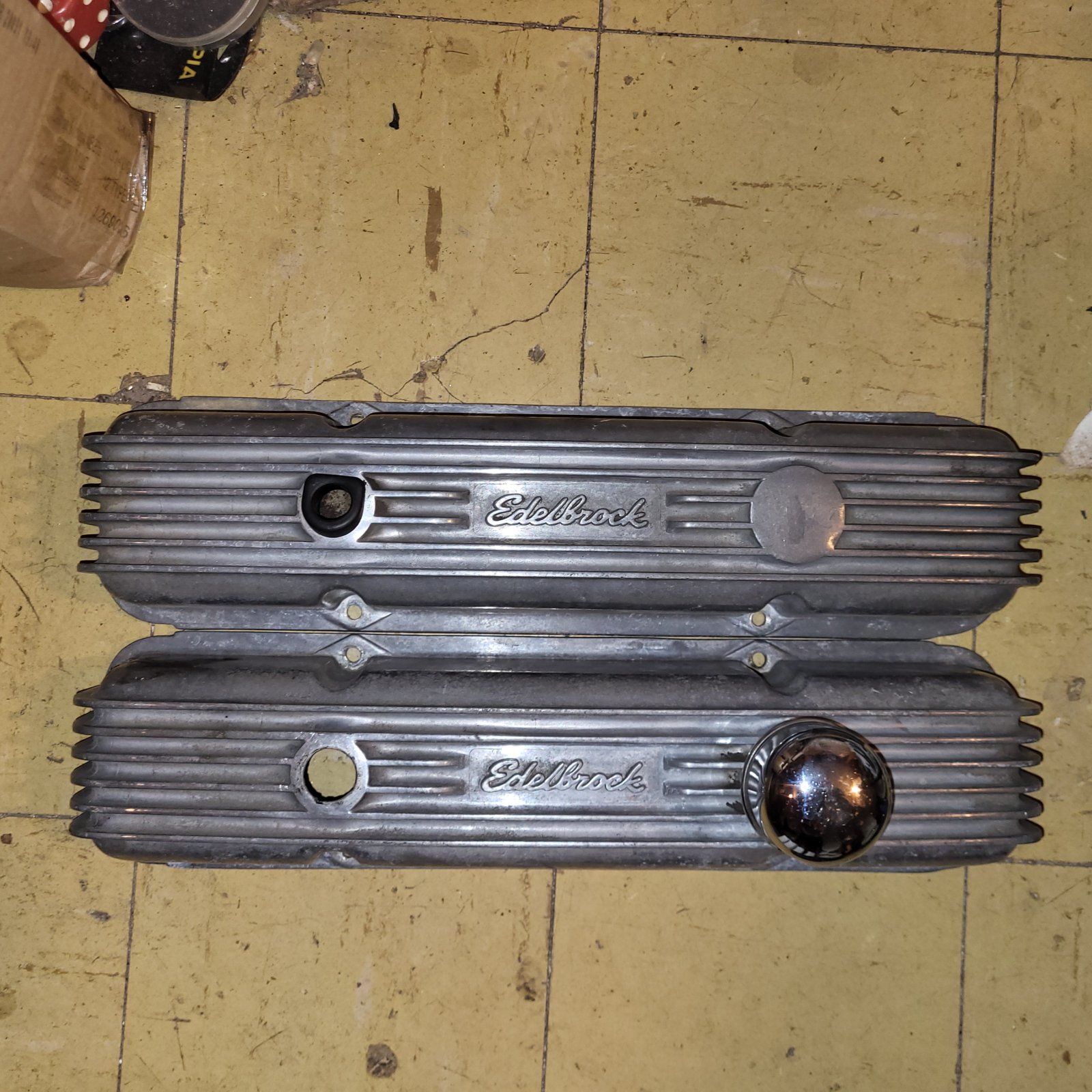

    Picked these up for $30.00 at a swap meet last month. The vintage look, but suitable for the '69-'86 engines. 20221228_215042.jpg

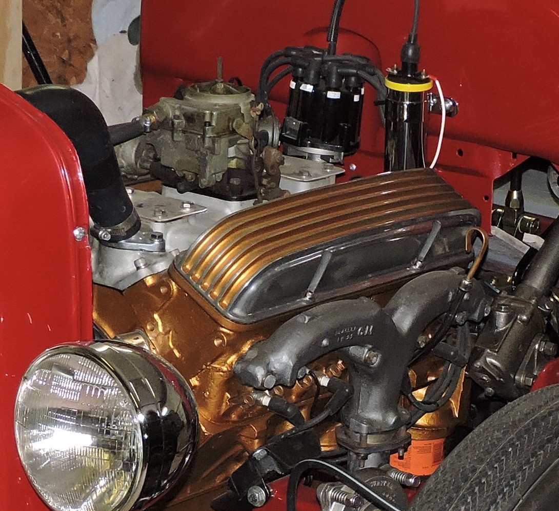

    Yep, I like the way they look on this 70’s 350 along with a C3BX intake that we will put the oil fill tube in. I think we have about $80 in the valve covers and intake together.
