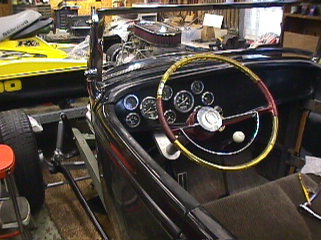

  6. Okay, got the mold part down...next question. I just need to do the clear part of this wheel...just cracks in it, no missing chunks. What's the best and/or easiest water clear stuff to use...urethane, polyester, or epoxy. I DON'T want the clear to pull or shrink away from the chrome rim. Once the mold is made, I'm going to remove the yellowed/cracked clear, then recast...

    Looks like a 1961 Pontiac deluxe wheel. :)
    My understanding is when you get these wheels professionally recast is they do the whole thing using clear, then paint the parts that are solid color.
