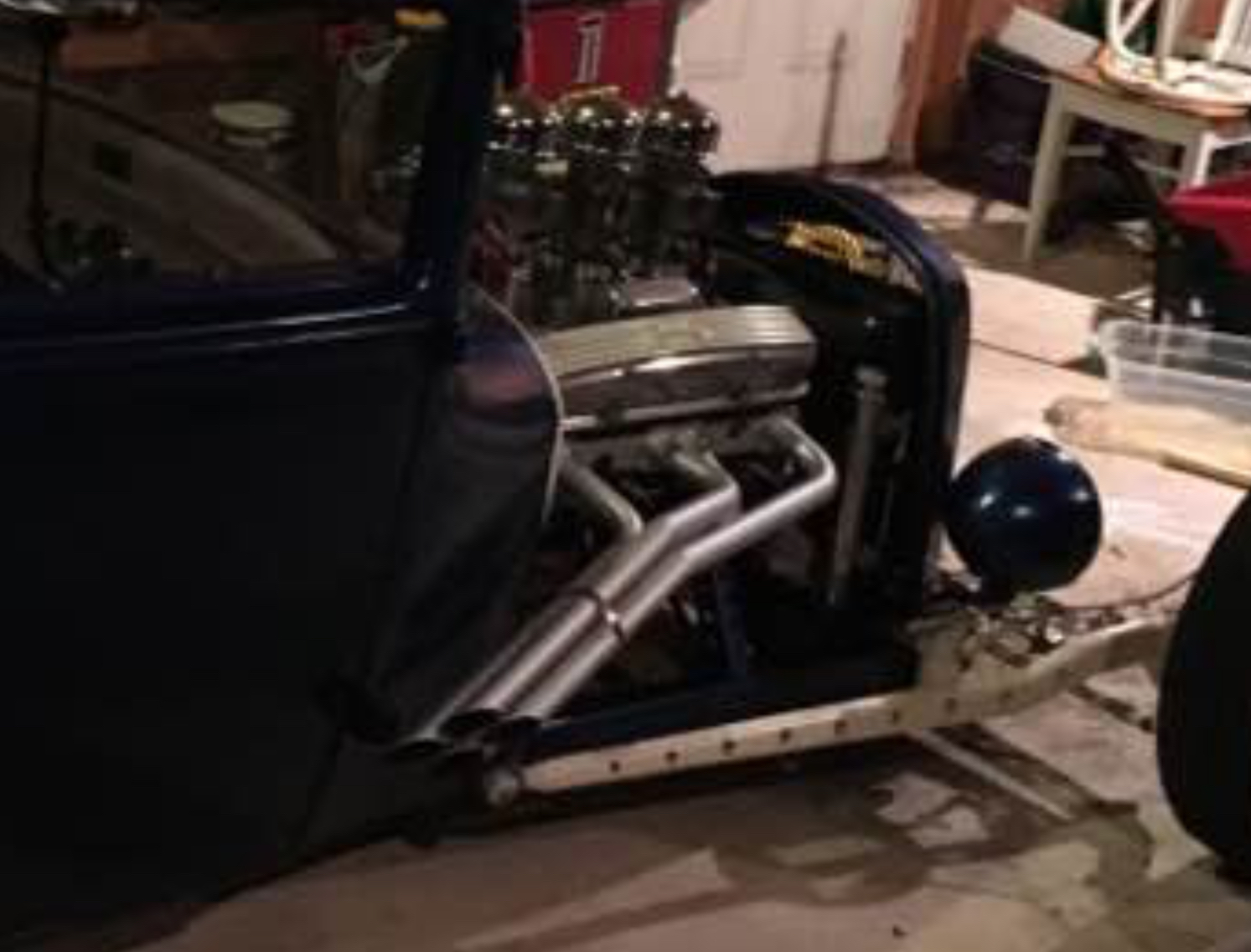

    There is Cerakote. They use it on guns and hot metal pieces. Many colors available. I had the headers on my old coupe done in Cerakote bare metal color. Turned out like this ( sorry for the grainy image, best I had ) IMG_3024.jpeg

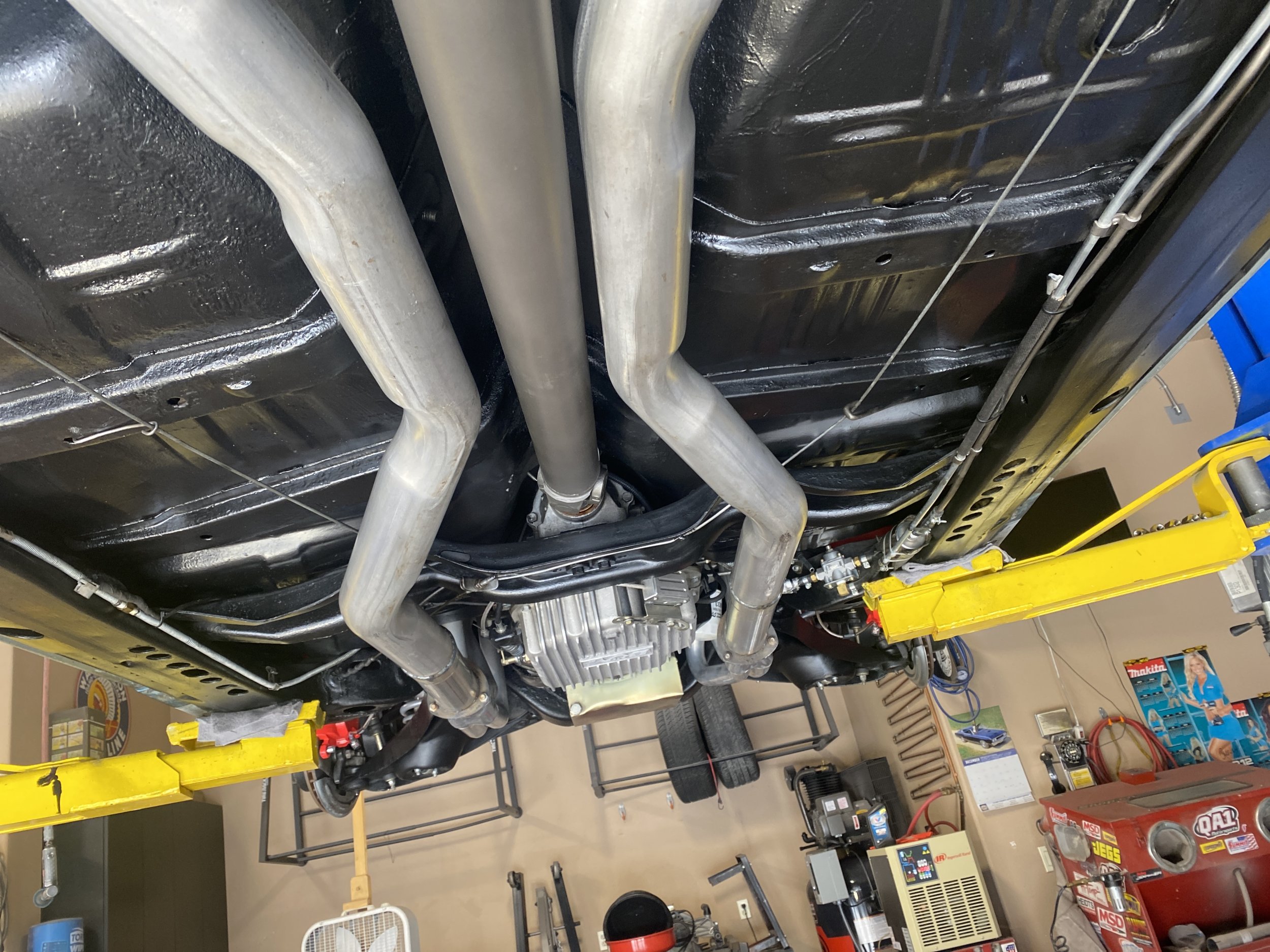

    This is what a 17 year old exhaust system looks like on a car with 98,000 miles and gets driven in any weather (no snow) using a little VHT and steel wool like I described above. I have polished SS systems on my roadster and PU, this is a part time drag car and street car. That doesn't mean it I don't put it on the lift and clean it up once in a while It looks like that right 3" tube is tight to the driveline but the car is hanging on my 2 post lift . Looks as good as the day it was installed. That stub in piece up front is where I removed the Y pipes (used to have cutouts).

    Yeah, that looks GREAT!
