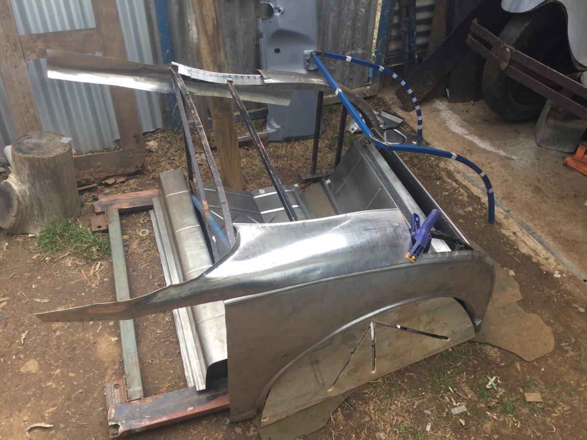

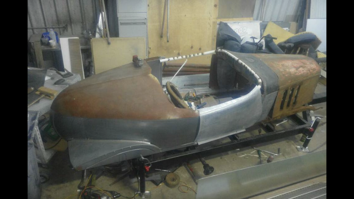

    If I find tipping dies and offset dies will do 60 percent of everything I need to do. I am building a roadster body and floor pans at the moment. Next week I will be moving onto doing the roof panels for a 29 Model A Tudor and Coupe and 30 Pickup. The tipping dies will put all the folds in for the flanges.
    098B49FB-AE8B-4002-8759-3D874090A085.jpeg 95082539-9312-497C-88C9-7A2550B220C9.jpeg
    CadMad and 66gmc like this.

    Very nice work, put some pics up as you do some of these jobs.

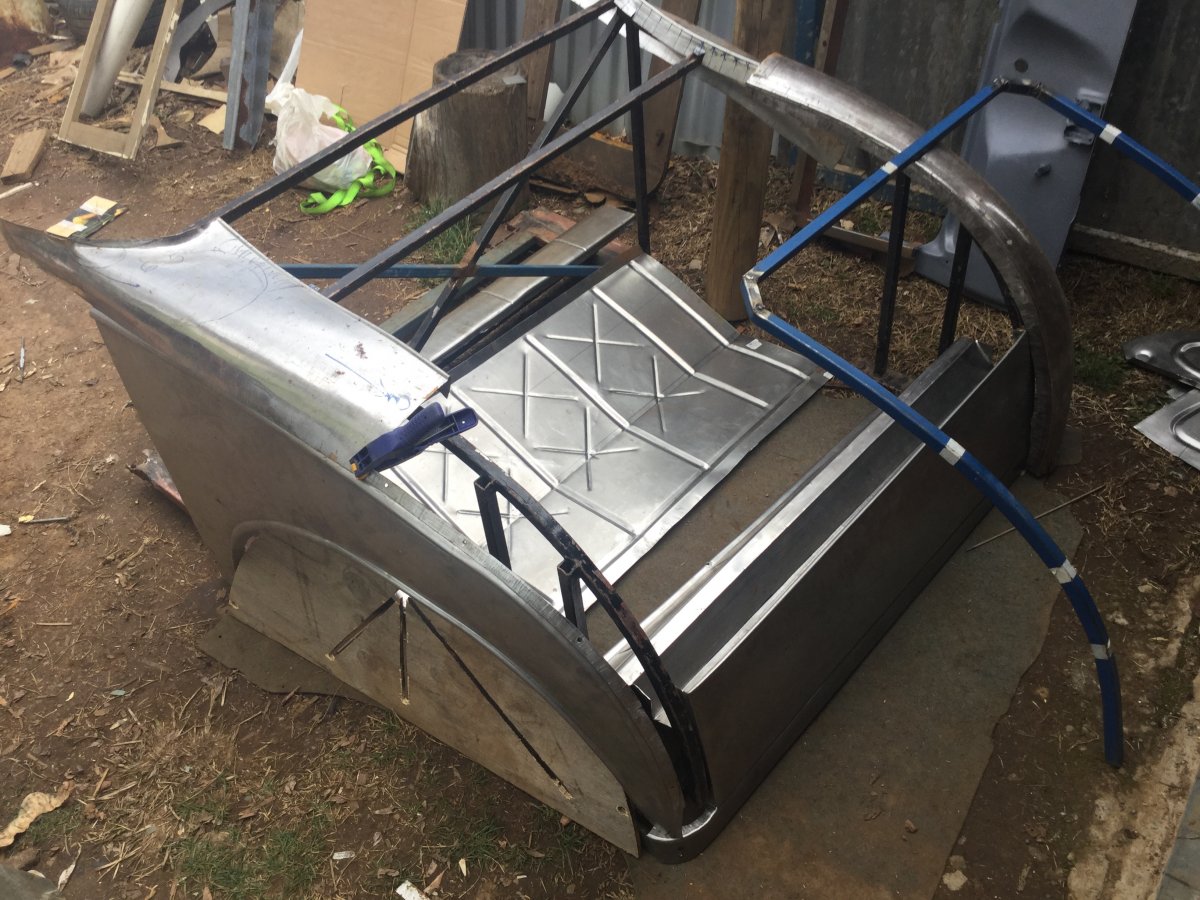

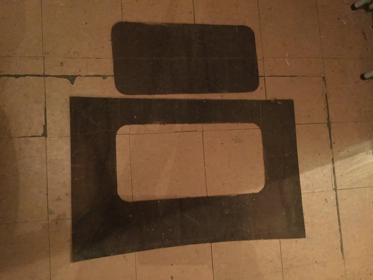

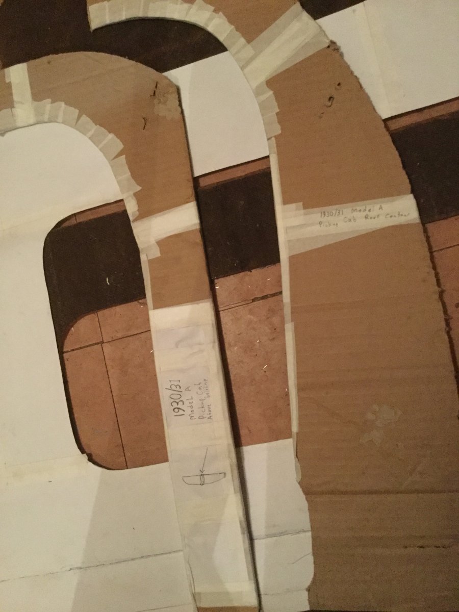

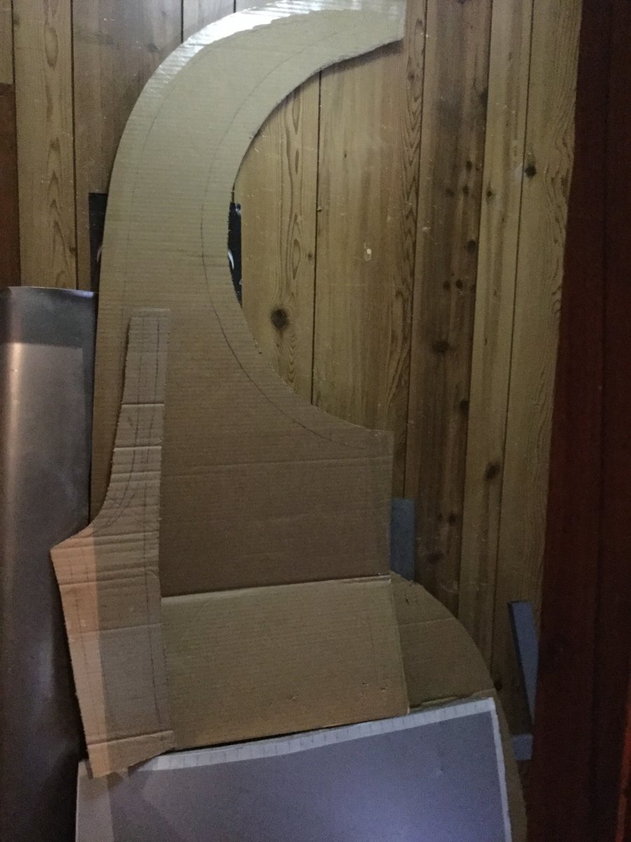

    These are the templates for the roadster panels and roof panels.
    97A0A989-B9E8-4DDE-AFA1-B3AFD78B4600.jpeg BA1B633D-BEE2-449F-886F-641CAE6E6329.jpeg E5C7BB0F-3E30-4D18-AF58-5404BE2D0447.jpeg

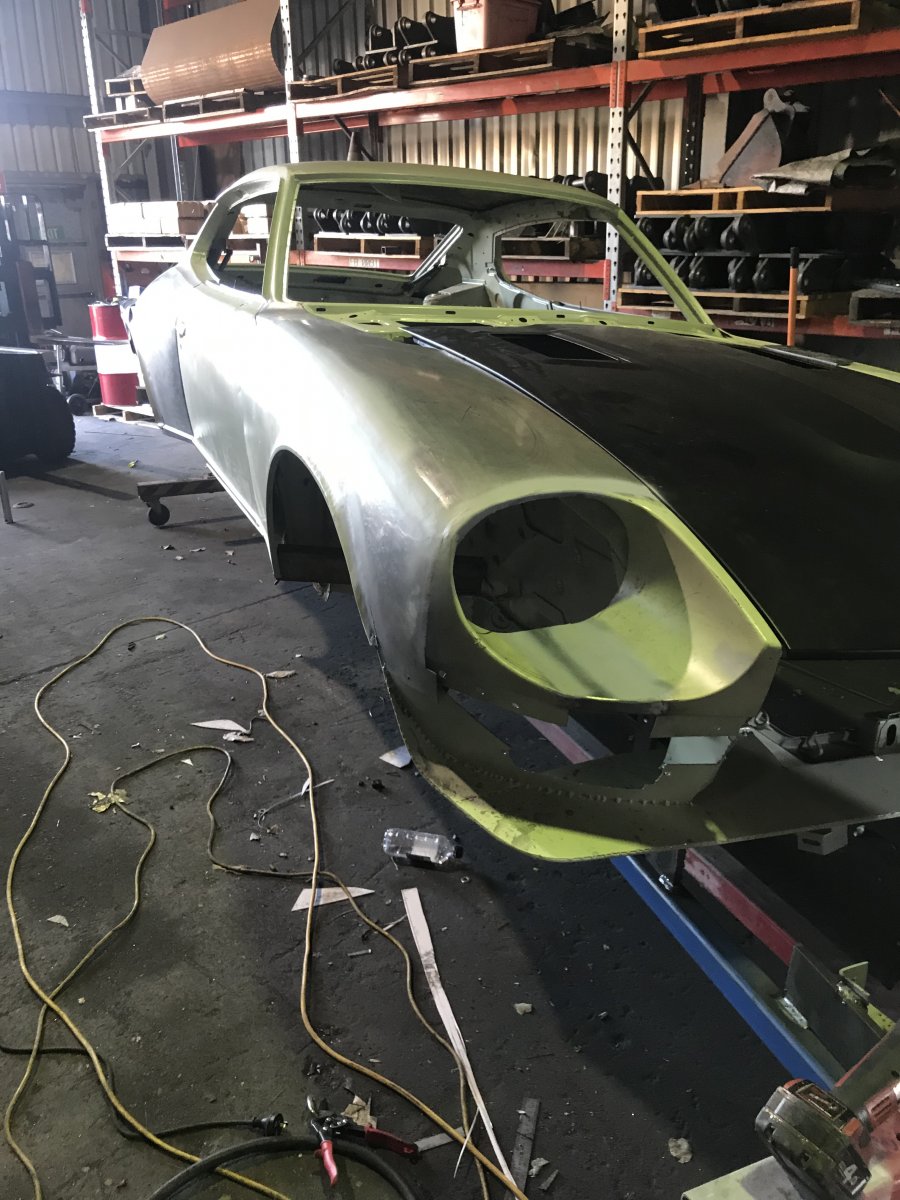

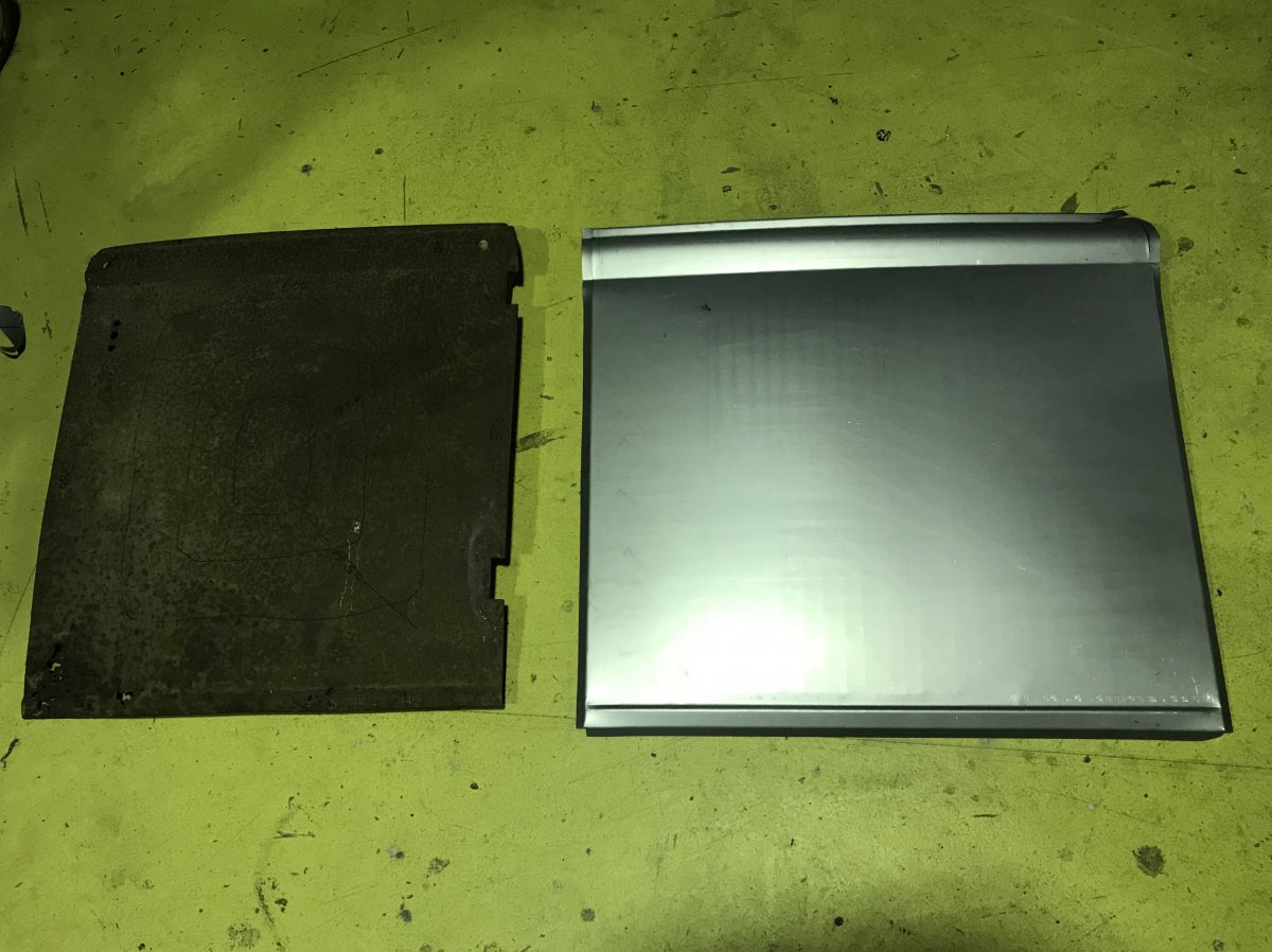

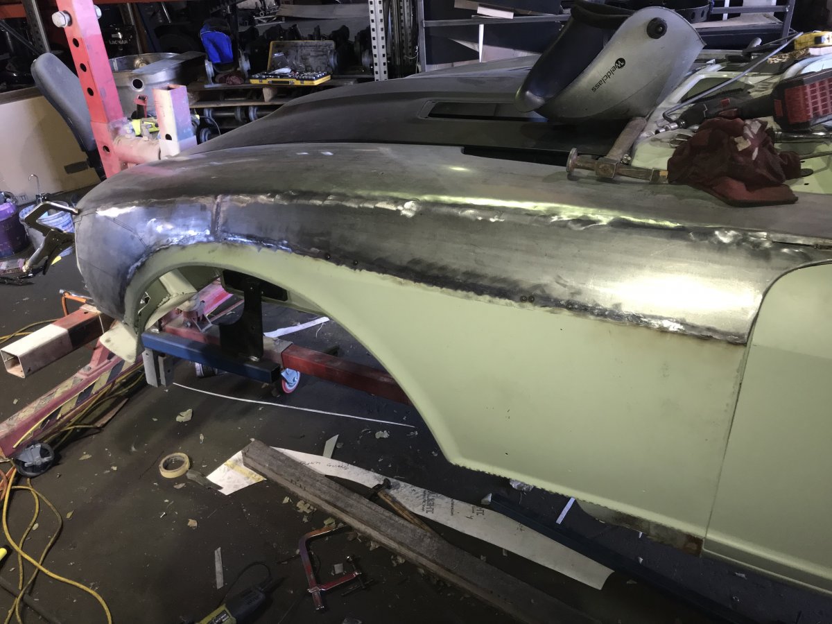

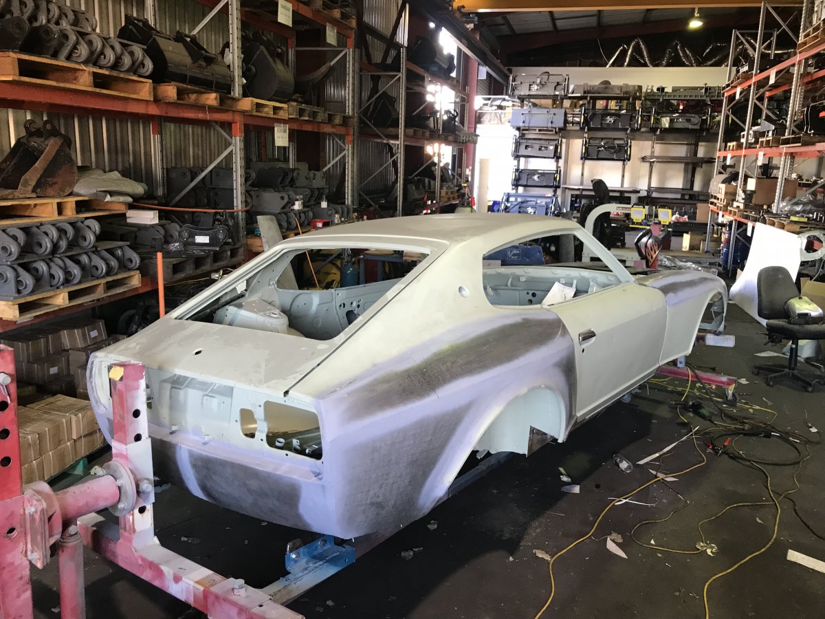

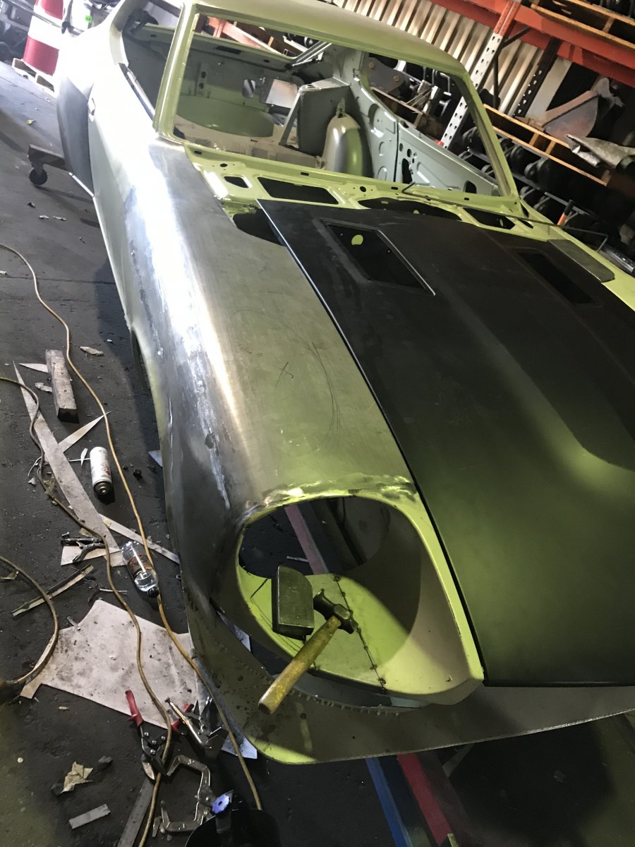

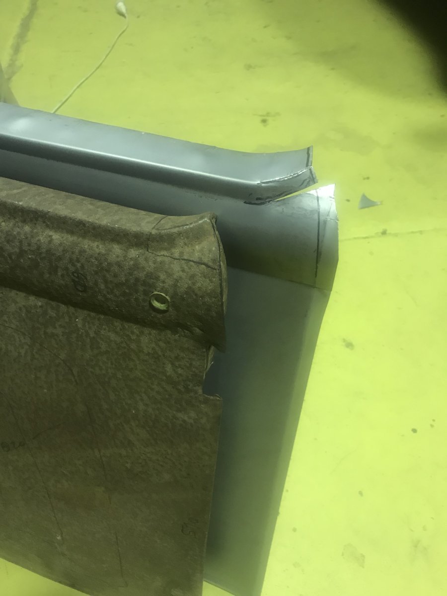

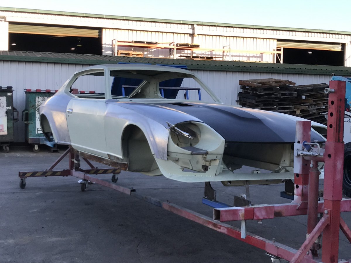

    Agree with buschandbusch. I know this isn’t hamb friendly but its the same process whether a Datsun, Duesenberg or Model A. I banged this out this month 535F69A8-3129-42A4-B650-2FA9A26DE213.jpeg 781880F5-515B-4B2B-8CF1-715844CA5049.jpeg 9CB001EC-054F-4076-928D-D27B1EDF25F7.jpeg 4BA0CEA5-099E-476E-ABCE-16CC7E05E303.jpeg on a cheap but good $600 English wheel and $400 shrinker/stretcher. Actually I didn’t even use the stretcher, a $50 sand bag and hammers.
