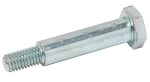

  13. toxic waste
    Joined: Dec 18, 2011
    Posts: 383
    toxic waste
    from Iowa
    Why dont you use a shoulder bolt ? That's what there made for .Fastenal and Mcmastercar has them.
