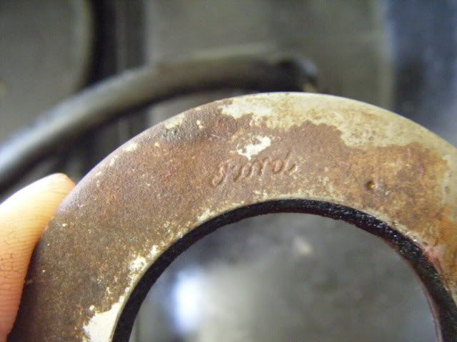

    Today on my lunch hour at work I ran down to our warehouse to use our new parts washer to clean the wheel components I had removed. It is one of those fancy ones that warms the fluid, has a brush and a faucet and nozzle and a drip tray --- but I digress…
    The bearings and seals all appear to be in great condition. No chips, no scars, nothing. Even some genuine Ford parts!
    This bearing has come full circle. Timken bearings are made here in Canton, Ohio and now the bearing is back again!
