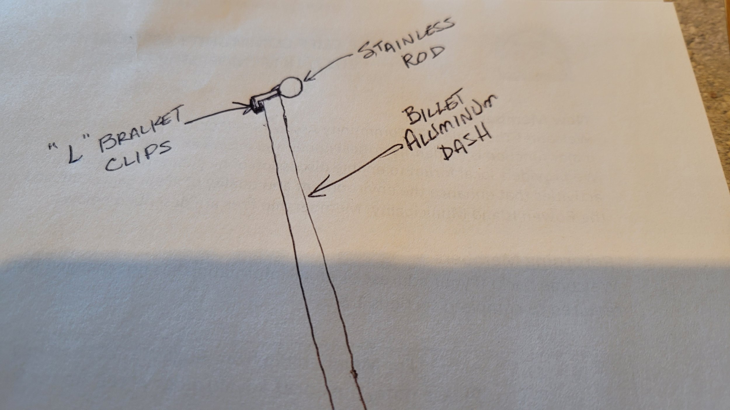

    @anothercarguy That looks AWESOME! How did you attach the stainless rod to the aluminum panel?

  4. Thanks guys, I too was pleased with the outcome.
    I tack welded 4 small (about 3/4" wide) "L" shaped tabs around the perimeter on the backside of the stainless steel trim ring. The tabs hold the ring from coming forward, and between that tabs on the back and the offset/overlap of the ring to the aluminum billet in the front, it clips into place. Here's a quick sketch of the sideview to try and show my explanation. There is enough flexibility in the ring that I can unclip it one clip at a time with a gentle pry from the backside.

    GENIUS!!

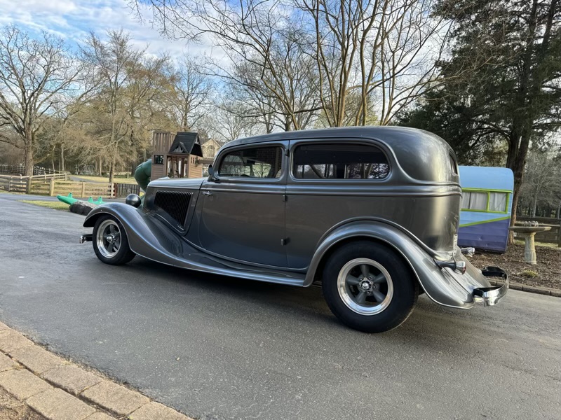

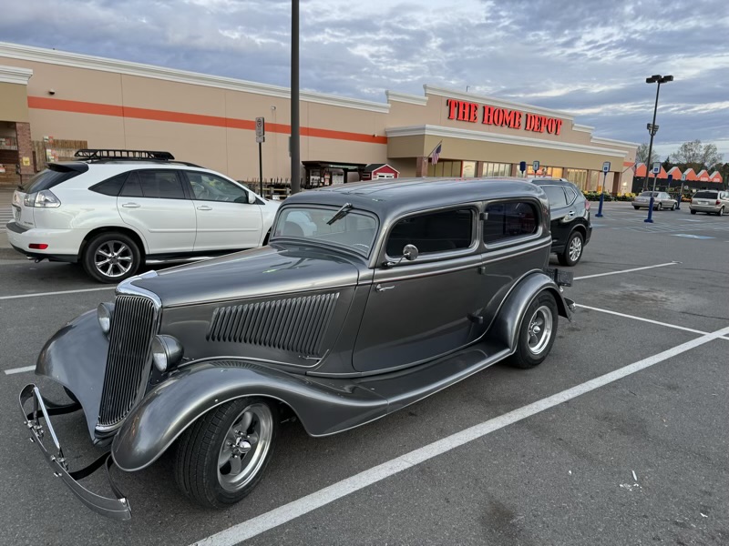

    That’ll do pig….
    You can put a kustom guy in a hot rod, but you still can’t get the kustom out of him….bullet center caps and lug nuts. Lol
    Obligatory run to Home Depot after dinner… lol
    I wouldn’t mind the tail down a bit to tuck the tires up in the fender a bit, but not sure how to do that on a four bar, coil over rear end. I’ll have to look and see if I can adjust the shocks any I guess.
    For the curious…those are 195/55/15 up front and 235/70/15 in the back. The steelies were 185/65/14, which are pretty much the same size overall as the new 15’s and the rear were 225/70/15…the new ones are 1/2 taller and an inch or so wider…and now on 8 inch wheels.

    You sure have a great eye for what looks good, great rim addition! You should have some adjustment on the coil overs but will be limited by the frame to axle spacing. I’ve got mine at 2 1/2 inches but that’s required a pretty stiff shock so rides on bumpy roads are a thrill a minute! Hope you drive the hell out of it!

    @drdave The wheels are PERFECT!!!!!!!
    drdave and HOTRODPRIMER like this.
  18. HOTRODPRIMER
    Joined: Jan 3, 2003
    Posts: 64,772
    HOTRODPRIMER
    I totally agree with Brett, nothing would have looked better! HRP

    Thanks guys! I really like the look. Torque thrusts are probably my favorite mag wheel. And of course, who doesn’t love polished, but I think the grey centers really hit it with the paint in this case.
    Thanks for the info @wide34, I’ll have to get under it and look to see if there is any wiggle room back there. …and don’t worry…it’s getting driven plenty, between the Impala and the Tbird. I could be driving the A, too, before I take it apart to finish the interior install I guess, but since it’s leaving I almost don’t consider it mine to drive. Weird. Lol

    Who doesn’t love Torque Thrusts? Although I prefer the straight spokes. Great addition to your car! And the non polished look suits the car much better IMHO. Gorgeous car, what’s next?

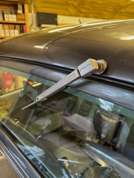

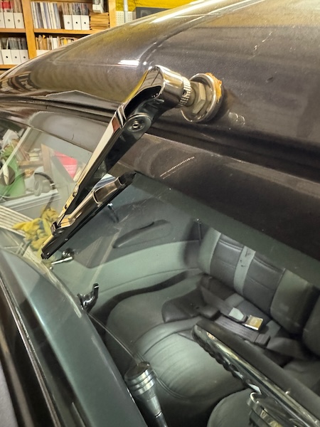

    Then, after an inordinate amount of time looking for the new wiper arm I bought (why couldn't you find it, Dave? Shop looks immaculate and so well organized...... :/ LOL) I got that swapped out. The new one won't seat down all the way on the splines, but it's still better than the squaredy billet one...

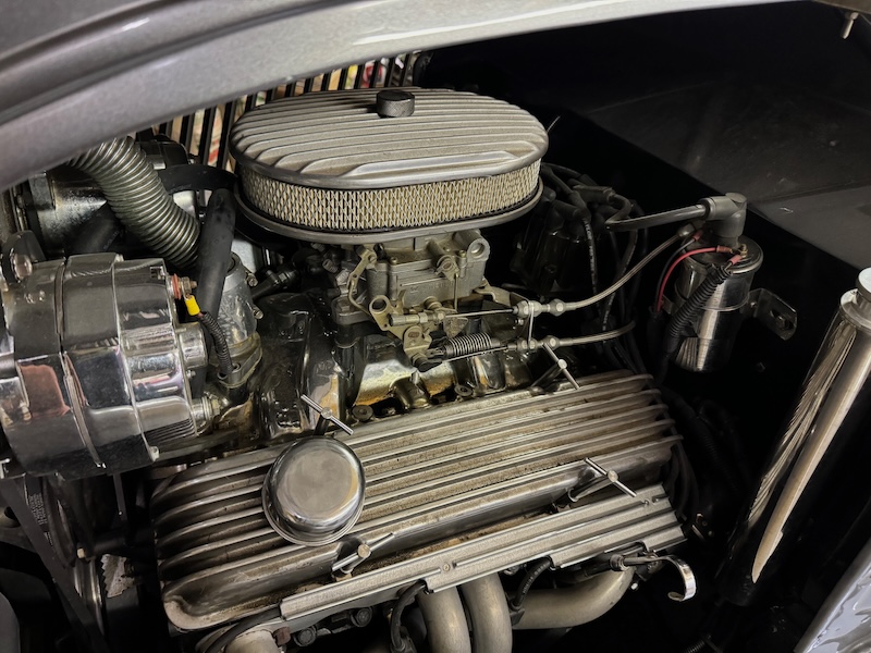

    Also robbed the finned aluminum engine goodies off the dead Merc motor and switched them for the cheap chromed diecast "billet" that was on there (see first post). They need cleaning of course, but the whole engine needs a degrease when I wash the car next week for the Stray Kat, so I just threw them on.

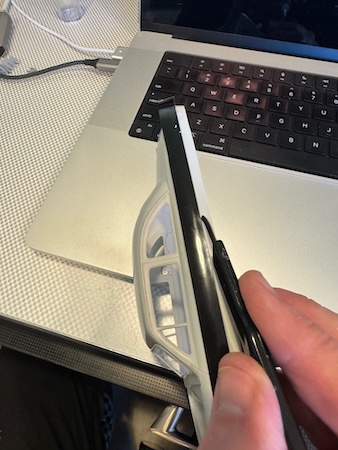

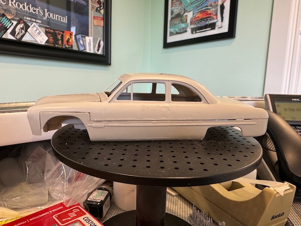

    Also sectioned a '49 Ford coupe quick last evening....I doin't know why everyone says sectioning a car is sooooooo hard. LOL

    Much less welding when they're that size! :D

    This gonna be for Mick's common kit build at Lead Ain't Dead??
