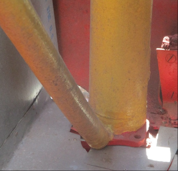

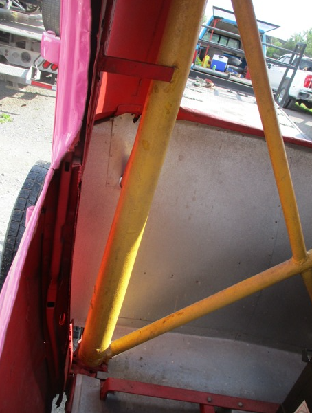

    Torque tube roll bar, note a great idea.

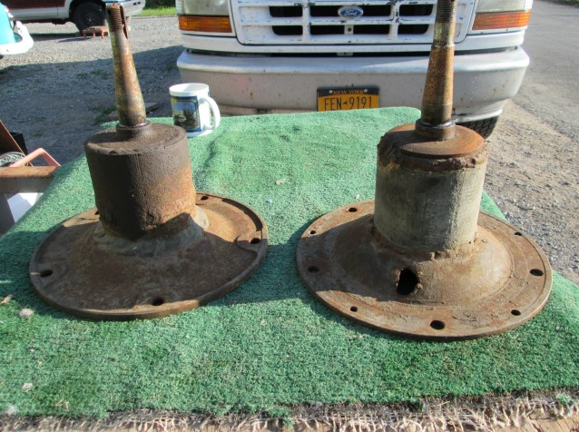

    Vintage tow hubs, for flat towing stock cars

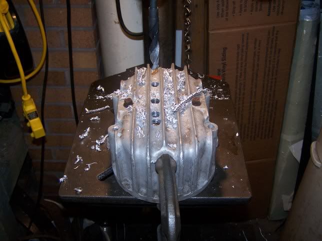

    6 Cylinder Chevy rocker cover hood scoops

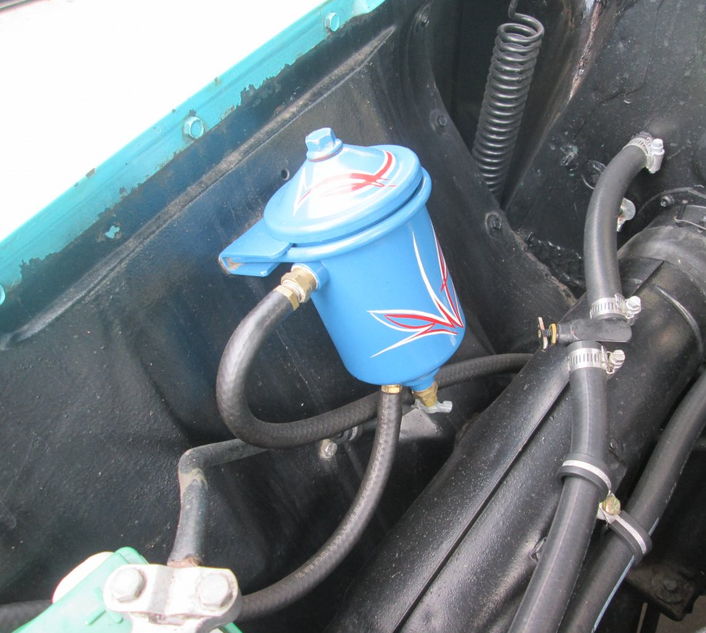

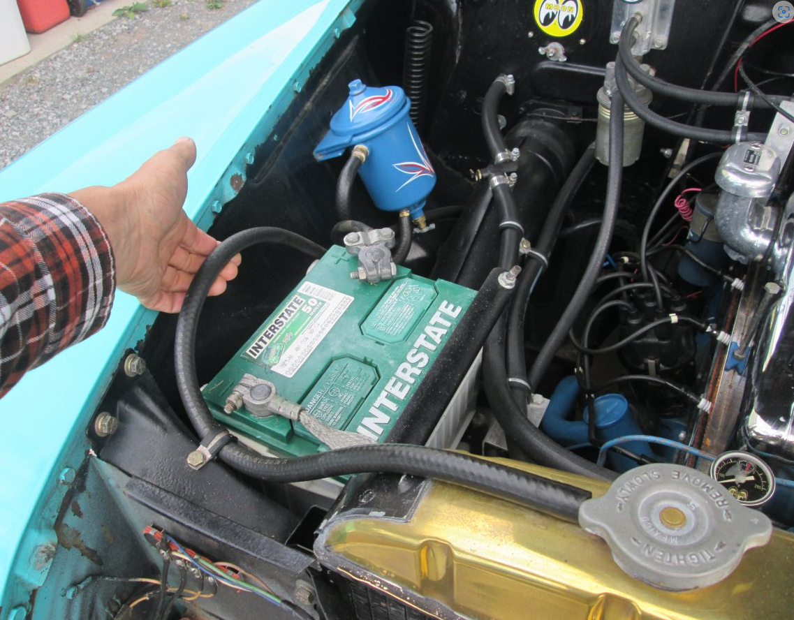

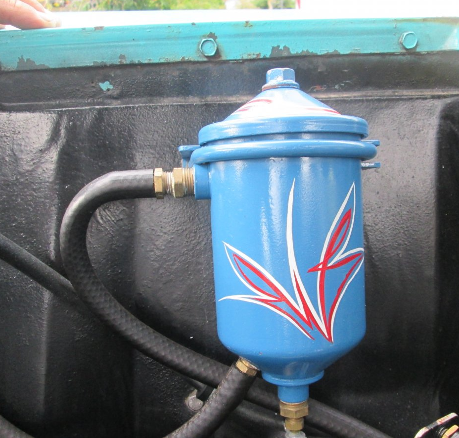

    I am using a by-p*** oil filter as a coolant overflow tank, my dad's idea-
    upload_2023-1-27_12-5-21.png upload_2023-1-27_12-5-39.png upload_2023-1-27_12-5-57.png

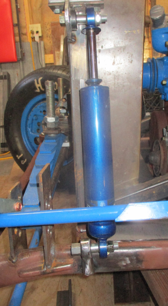

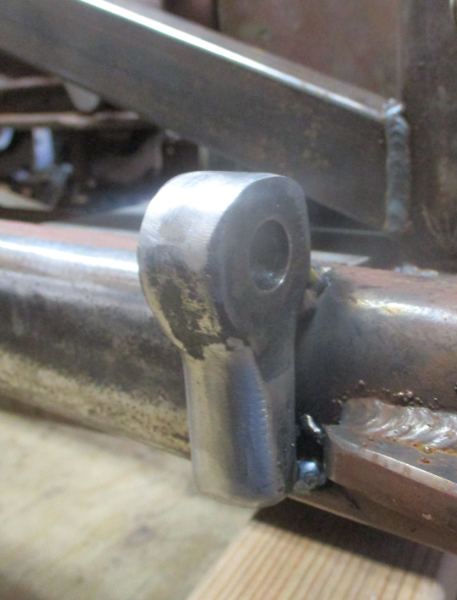

    More of my own drag link turned shock mount.
    upload_2023-1-27_12-9-49.png upload_2023-1-27_12-10-4.png upload_2023-1-27_12-10-39.png

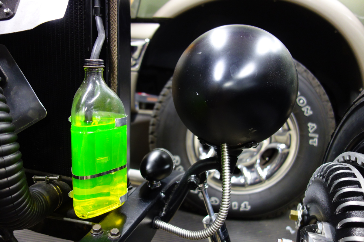

    Like yours, used an old 50's Optikleen washer bottle, that had layin around in the shop for years, for a puke tank.

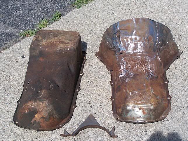

    Im always looking at what's available in the garage first, a transmission tunnel out of a pontiac oil pan, that little piece in the middle is the only thing not used
    Shifter cover out of a $20 dollar quick change wall hanger

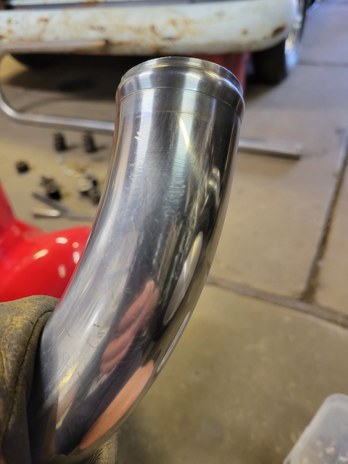

    Most recently a lower radiator hose out of a stainless in-ground pool ladder

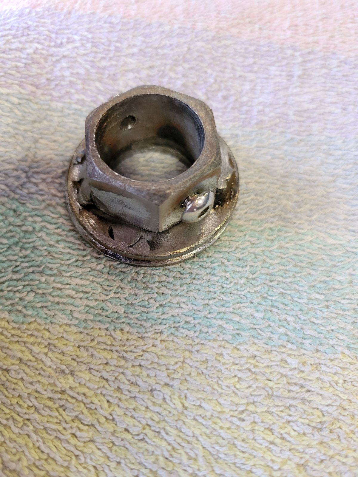

    Then made a dye out of a nut and a couple of washers for the bead roller to roll a lip on the ends.

    Very cool ideas especially the bead roller die. I think tomorrow I’ll go and straighten a bunch of nails...sigh.

    Mentioned about these vintage tow hubs being made and used years ago when the recovery guy came to recover my 4x4 and used a modern set too tow it away. Think the overflow can is a neat idea.

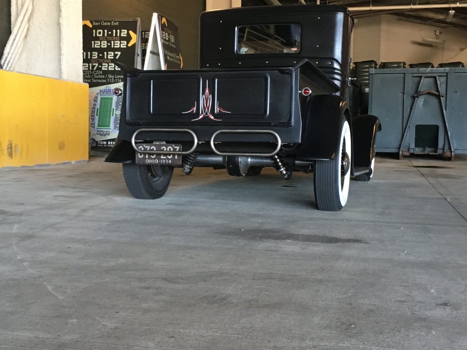

  19. You can't see the back of my roadster in my avatar. My rear bumper / nerf bar is made from 2 legs from an old Formica topped kitchen table. The loops are the bottoms, and the brackets that attached the legs to the table are where my rear license plate goes.

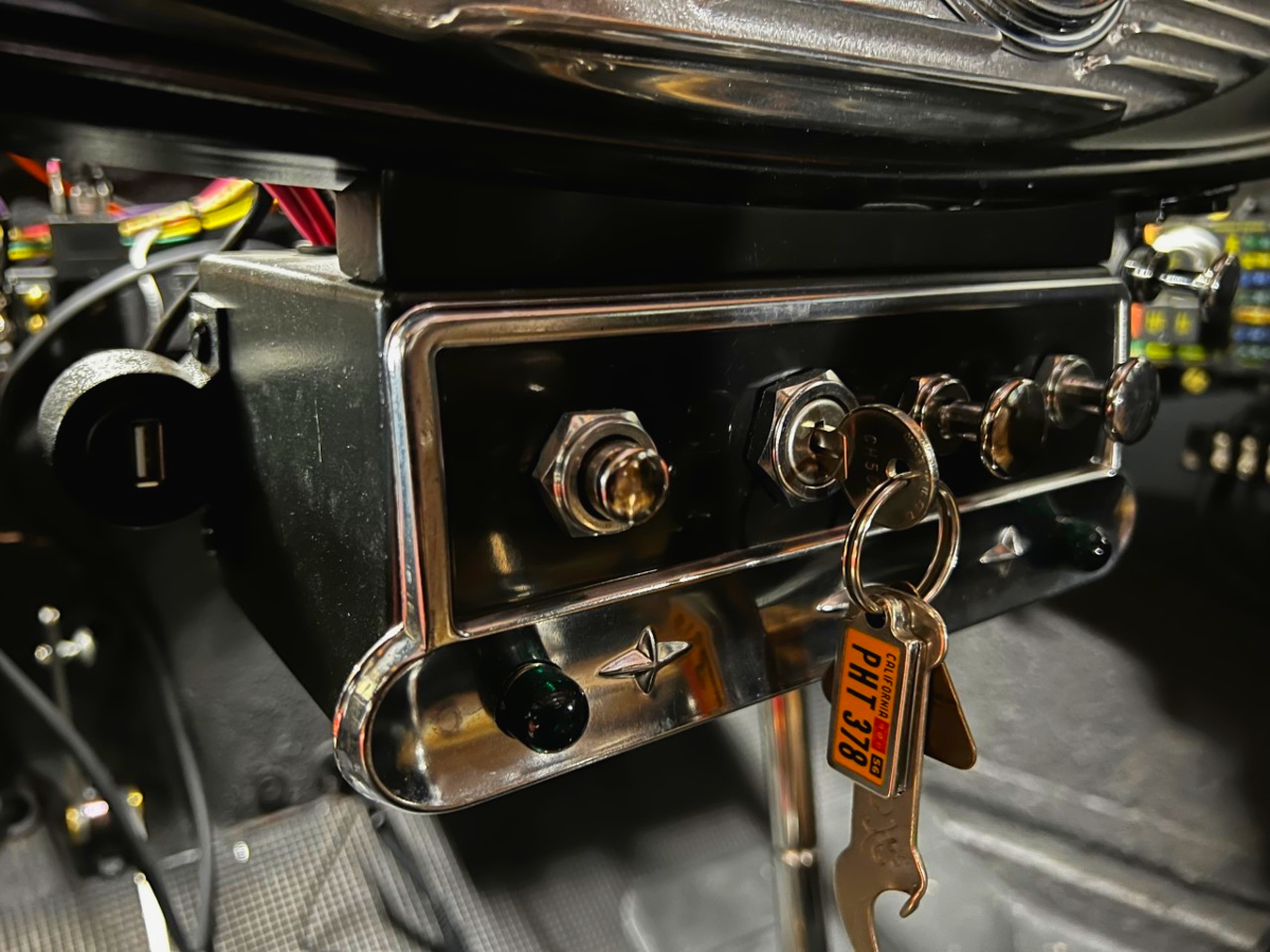

    Great ingenuity here....mine are piddlin compared to the above cool *** projects.;) When I replaced my dash and rewired, I wanted to mount my ignition, lights and turn signals under-dash. I found a 50's Chrysler radio delete plate for a face plate but needed something to stiffen it up and hide the wiring. I've been restoring a cabin and had to tear out some obsolete wiring - with two exterior lighting junction boxes. Had them in the junk pile but happened to take a tape measure the one in the best shape.....and perfect dimensions for what I was needing. Removed the cover and cut out one of the longer sides. Flipped it upside down and drilled out holes for my switches with the delete plate clamped to it. Painted it up, bolted it on, hooked up the switches and attached a USB phone charger to the driver's side rear (where you can't see it). Nice and sturdy and wiring hidden.....from the front and sides.
